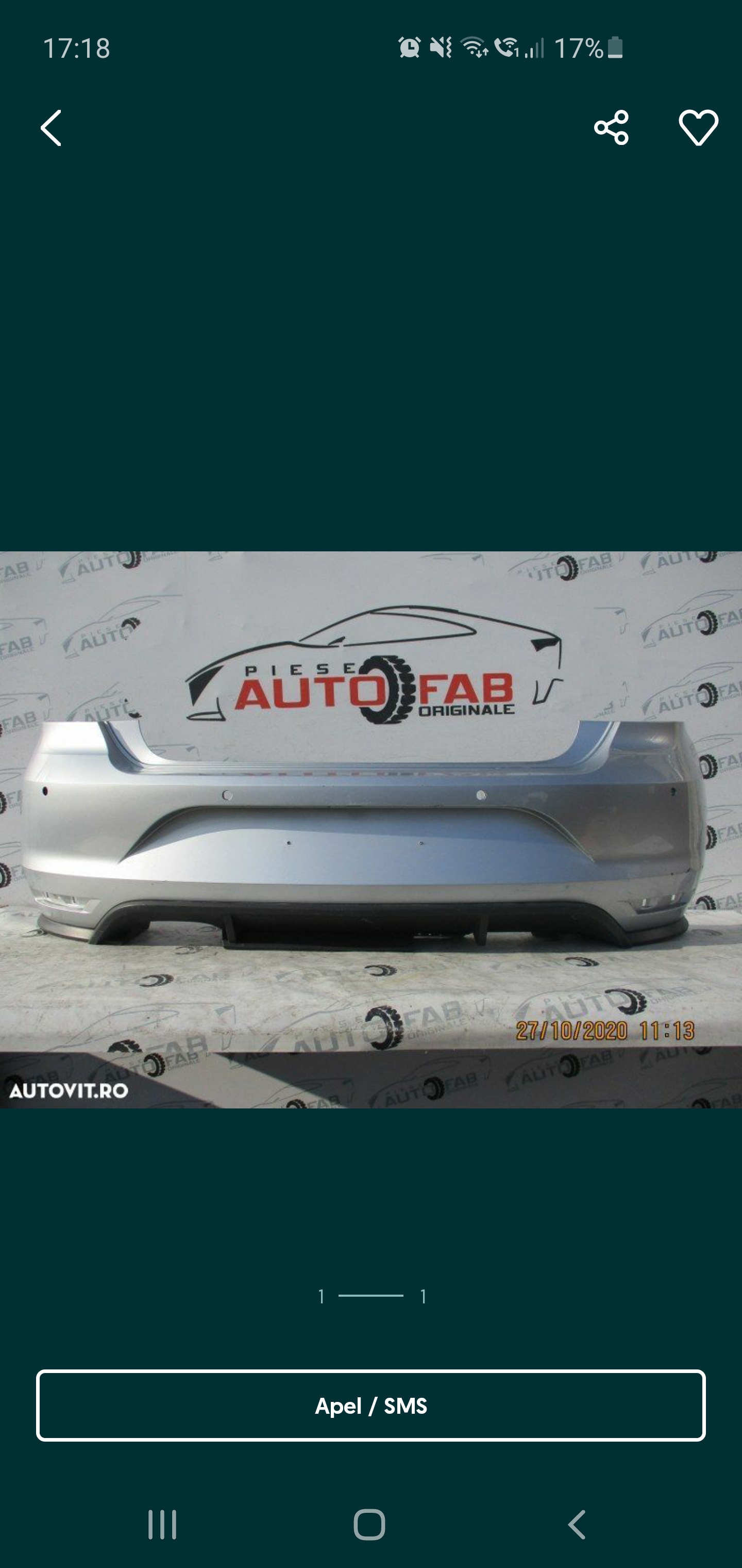

This guys claims this fits a polo 6R, but looks like it's a 6C bumper.
I want to install a 6R GTI bumper on my Polo and I can only find bumpers for 6C.
Does this fit a 6R?

yes but you'll have to replace the bumper carrier below the tail lights, to fit a 6C bumper on a 6R.

iichel wrote: Fri Dec 11, 2020 3:46 pm yes but you'll have to replace the bumper carrier below the tail lights, to fit a 6C bumper on a 6R.
Dope. Do you, by any chance have the part number for the bumper carrier? Don't really know how to google for it in my language. Also, I assume it's the same carrier for the standard 6c and 6c gti?
Posts: 6694
Re: Does this bumper fit on a standard 6R?
6C6807393B and 6C6807394B are for all 6C bumpers except Bluemotion, R-Line and BlueGT.
