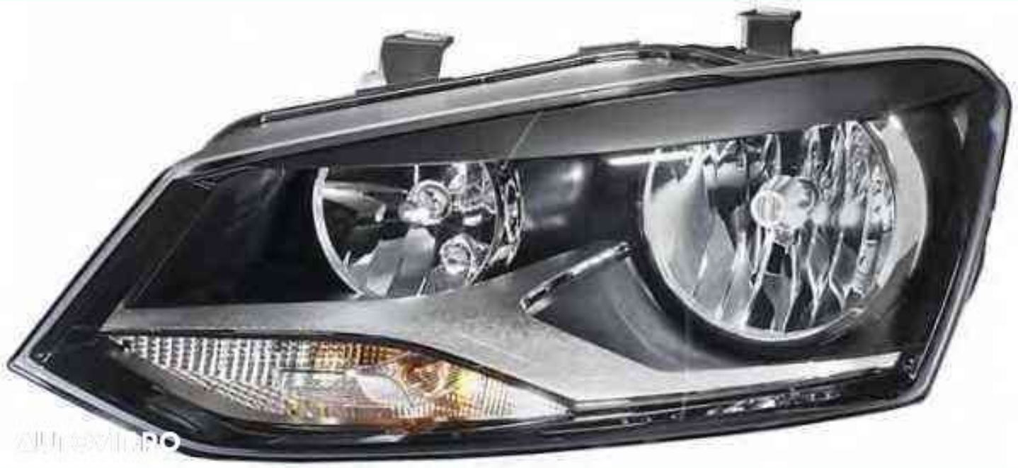

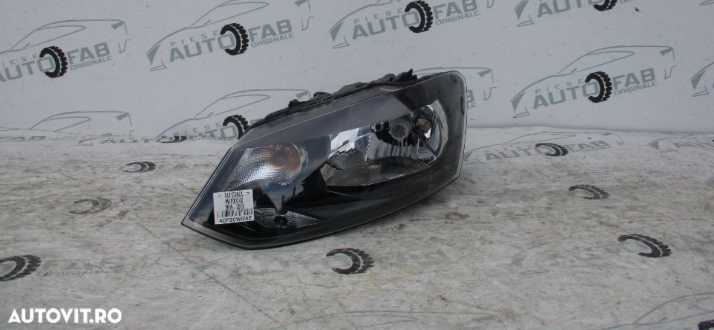

So I just found out there are H7 H7 headlights on polo 6Rs. Naturally I googled them and found it to look exactly like the single H4 headlight.
This would be the H7/H7 housing
And this would be the H4 housing I have on my car.

Couldn't I just install H7/H7 bulbs, replace parking light bulb with turn signal bulb and have them working correctly?
From what I understand there is a relay that has to be rewired? I may be wrong.
Also, would it be worth going down this road? Is there any improvement during night time driving?

I've also heard of this possibility. I don't really dig the look of the h1. I think my headlight endgame will be either a used set of OE bi-xenons or a set of aftermarket ones that look like the OE variants. Either way I think I have to do the H7 wiring.
Right now I was just looking for a quick and easy improvement for night driving.
Also after looking closer at the photos I see the headlights are pretty different. Being that the parking light is relocated inside the high or the low beam and the bulb housings are built different so I guess it's not that good of an idea to just swap bulbs.
