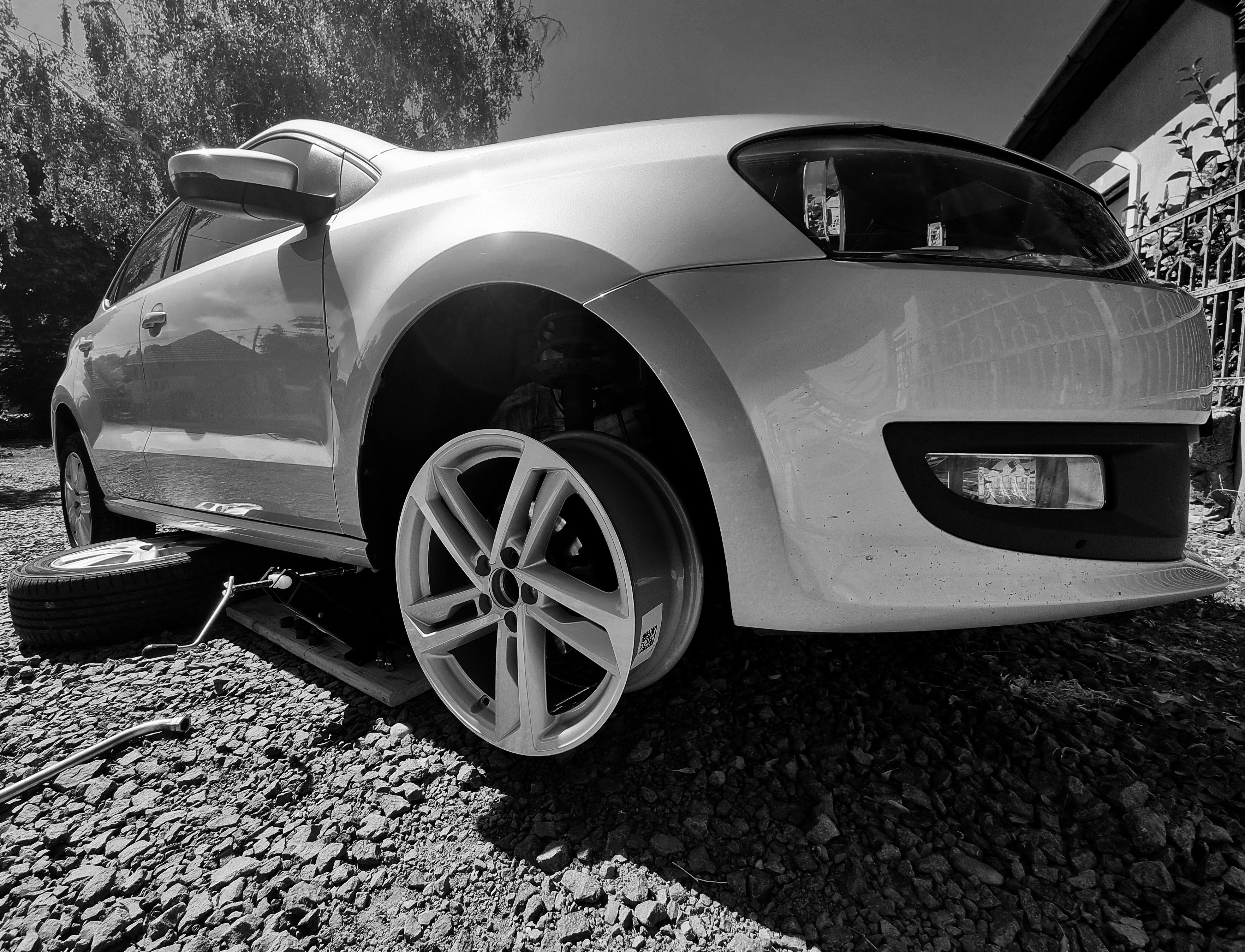

first of all, I'am sorry for my english, I'am from Slovakia and i didn't write in english a lot.
I've just bought a set of new wheels.
Originally they are from Audi A1 (2019) and they are 7.5j r17 et 46. Original size for Polo is 7j r17 et46 or Cross Polo has 7.5j r17 but et38... I have 9mm space between shock absorber and rim... is it enough? or do I need some spacers?

I almost forgot, it's been lowered by Eibach springs-25/-30mm

I think if now I have 9mm between shock absorber and rim (whitout tyre) it would be OK... maybe I should use some 5mm spacers to enlarge gap between rim and shock absorber

9mm is ok. But not all tires are really the same width, some tires are round some square.
Id measure with tire, but if you.put spaces dont forget that younhave atleast 4 turns of whel bolt

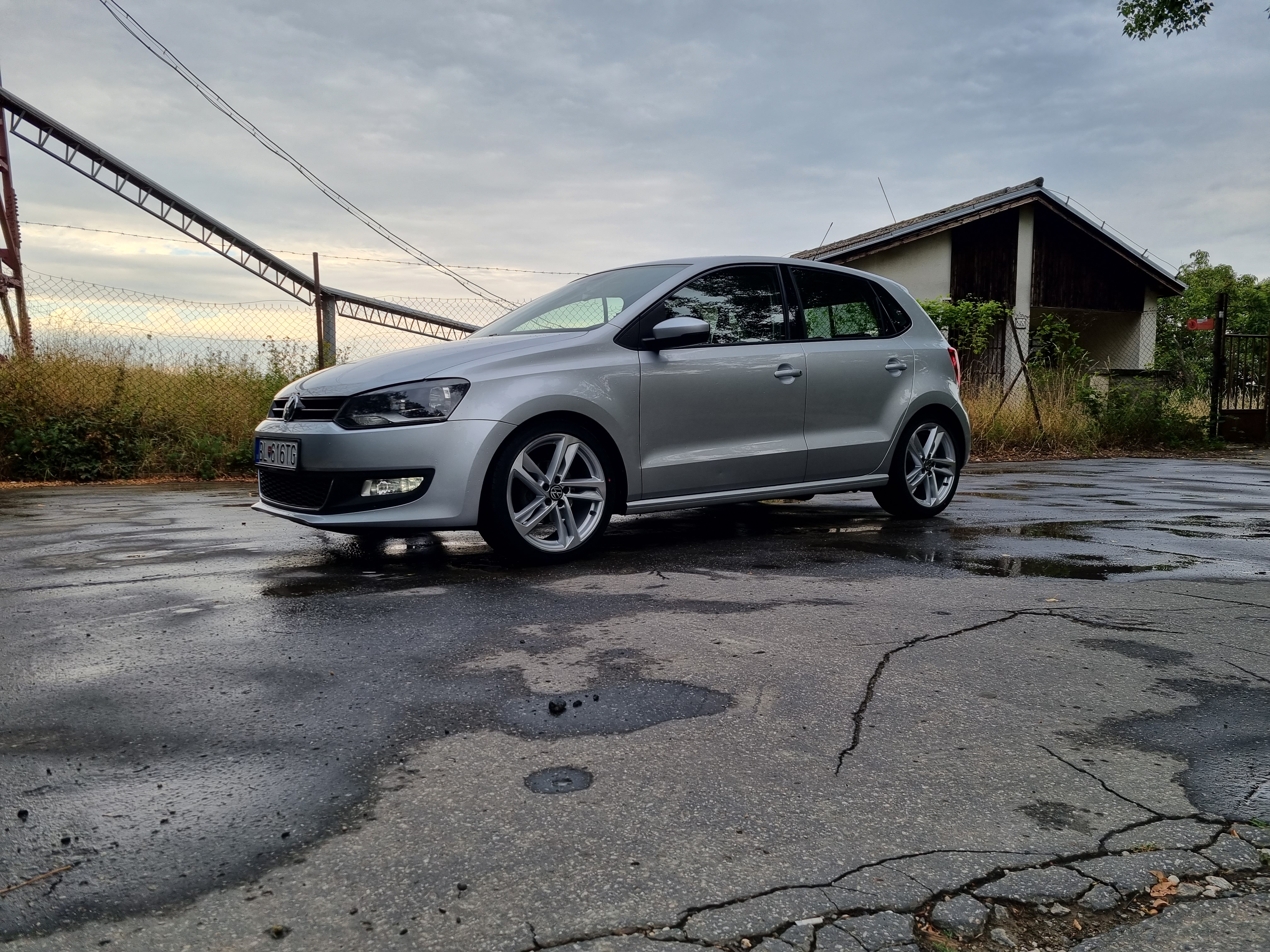

they fit whitout spacers
but in front i have about 4mm between shock absorber and tyre... I wold buy 5mm spacers and it would be perfect
Posts: 3850
Re: 7.5j r17 et 46
Matho wrote: Wed Jul 27, 2022 7:22 pm they fit whitout spacers
They look good 👍😎. Did you get 215/40 R17” tyres? That’s the size tyres VW fitted in the factory on 17” alloys for the 6R / 6C Polo.
There shouldn’t have been any issues with them fitting; the 6C Polo GTI standard alloys are 7.5J x 17” ET44, so the same as your alloys apart from 2mm difference in offset.
