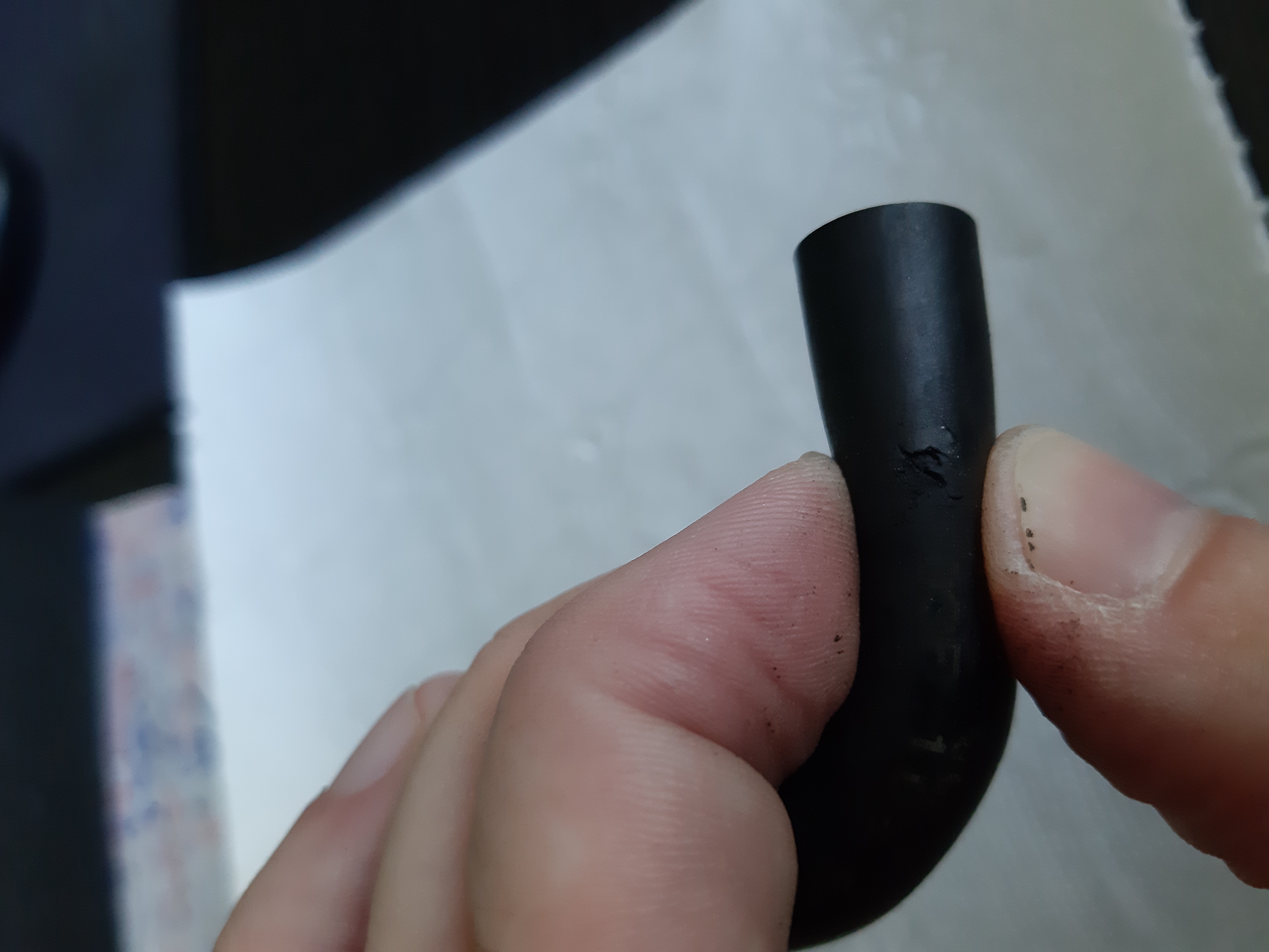

I will check this one ciclo ty, i have already checked it myself because it looked really flexible at the time. I will check it again. Thanx a lot for your time.
The short circuit didnt come back again, since i changed the second map sensor. But the air leak code continues to come up.
edit : just checked it. it was in place. i pulled it out for thorough inspection and all i could find is a small crack that seems to be only on the outside.
Nevertheless this crack is a showcase of the hose been too damn old, so ill try to replace it. Do you think it was bad as well ?
hose
hose

I see you posted a picture of the hose, it looks a tiny bit damaged. Try putting tape around it, then go for a spin.

It's a good idea to replace that hose.👍
It is an important hose because of the PCV valve (the cheap plastic valve you are referring to), ... a malfunction of this valve can ruin your engine.
A clearer image of your hose. (perhaps my computer screen filters prevent me from seeing the sharpest and clearest images).

Edit. Did the smoke test, no leak found.
Guy told me that my last resort is the timing chain that i changed around the same time the problems started occuring.
