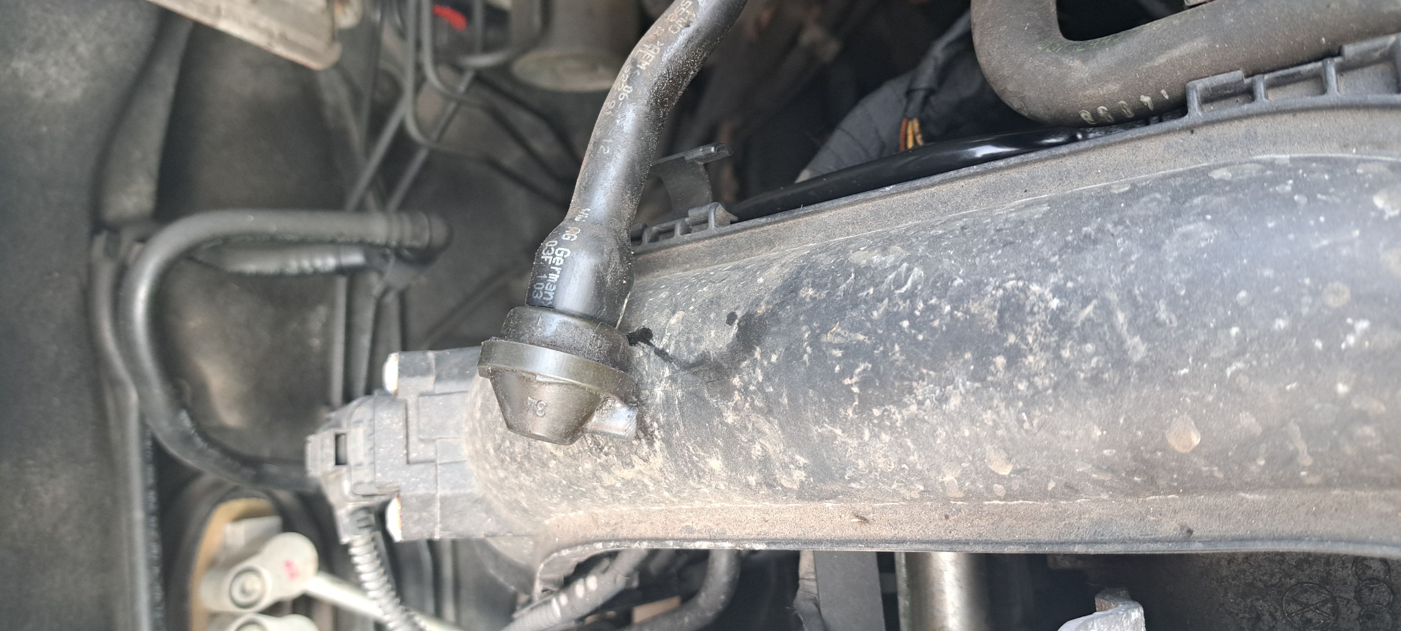

Hi all
Been cleaning out the air filter and noticed this
Should be attached to something?
The pipe is just hanging loose

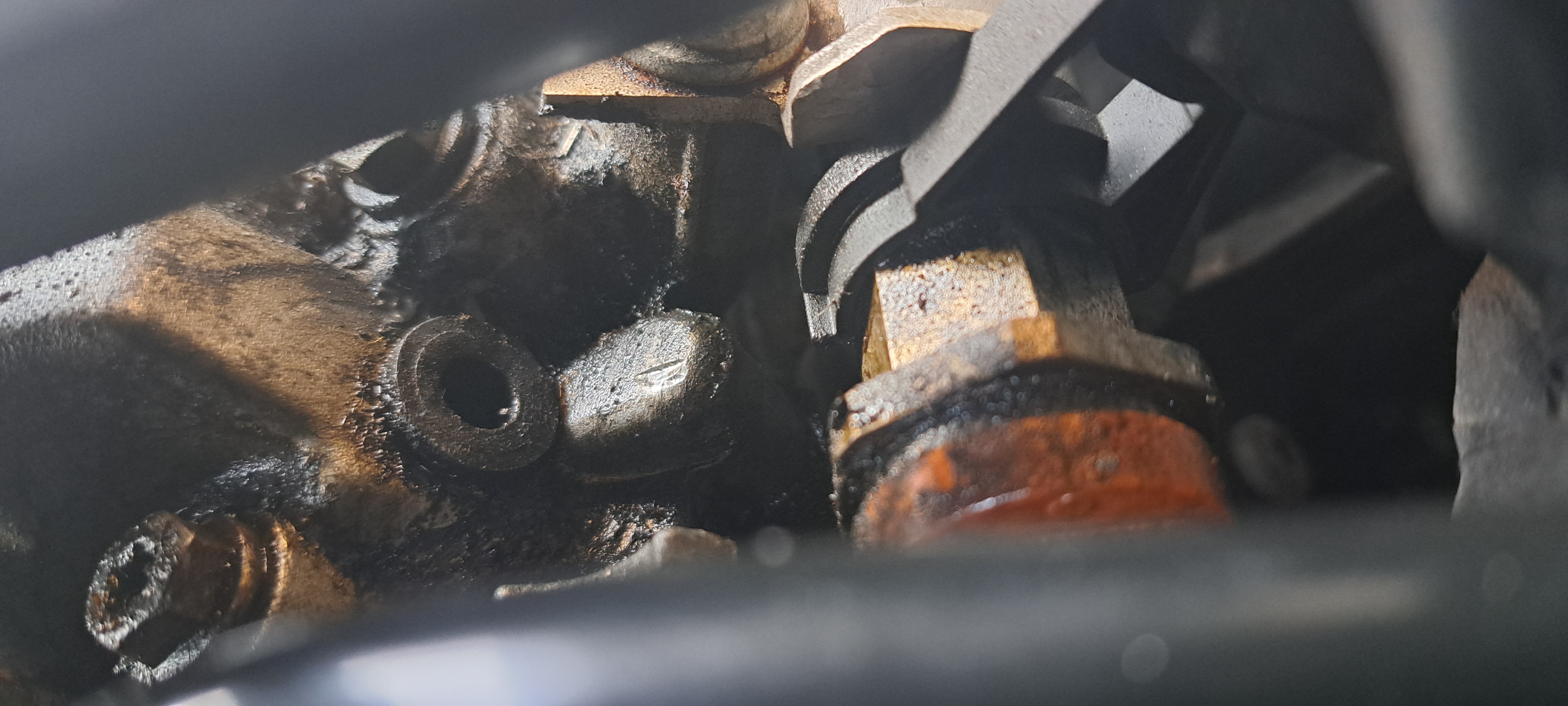

Also I noticed this little rubber bit ,
It seems to be open is that where the pipe from the air intake goes?
Having said that I tried to remove it , it has shot off and I can't find it ( lost in the engine bay)
Is the car safe to drive? to the garage and get them to look at it

It's just a little non return valve, it won't cause any issues for driving. Other than it's letting oil mist out of the crankcase. It's a "known problem" on the 1.2Tsi CBZ engines they are just flimsy and not up to the job. I replaced mine 3-4 years back and it's been fine since. I just check it once in a while.
Crankcase breather (030 103 175) Around £18. Yup that is daylight robbery for a piece of plastic!!
Rubber Grommet (03F 103 038) Around £1.50
Genuine parts cost
Judging by the amount of oil around yours. It looks to have been like that for quite a long time.

Yes it is the result of bad design along with careless mechanics when changing the air filter. Bad combination

wolfie wrote: Sun May 21, 2023 7:39 pm It's just a little non return valve, it won't cause any issues for driving. Other than it's letting oil mist out of the crankcase. It's a "known problem" on the 1.2Tsi CBZ engines they are just flimsy and not up to the job. I replaced mine 3-4 years back and it's been fine since. I just check it once in a while.
Genuine parts cost
Thank you ,
you say it won't cause any issues , how ever i still have the issues above where the EPC light come on from time to time if i put my foot down ( i was told it could be the actuator or turbo )
could this not be the issue for the EPC kicking in ?

I wouldn't have thought so. As I said mine was also broken for a while and I didn't have any issues. As it's a cheap and easy fix personally I'd do it anyway it can't hurt to replace it and you might just get lucky. I noticed mine while it was just badly cracked no completely snapped like yours appears to be.
