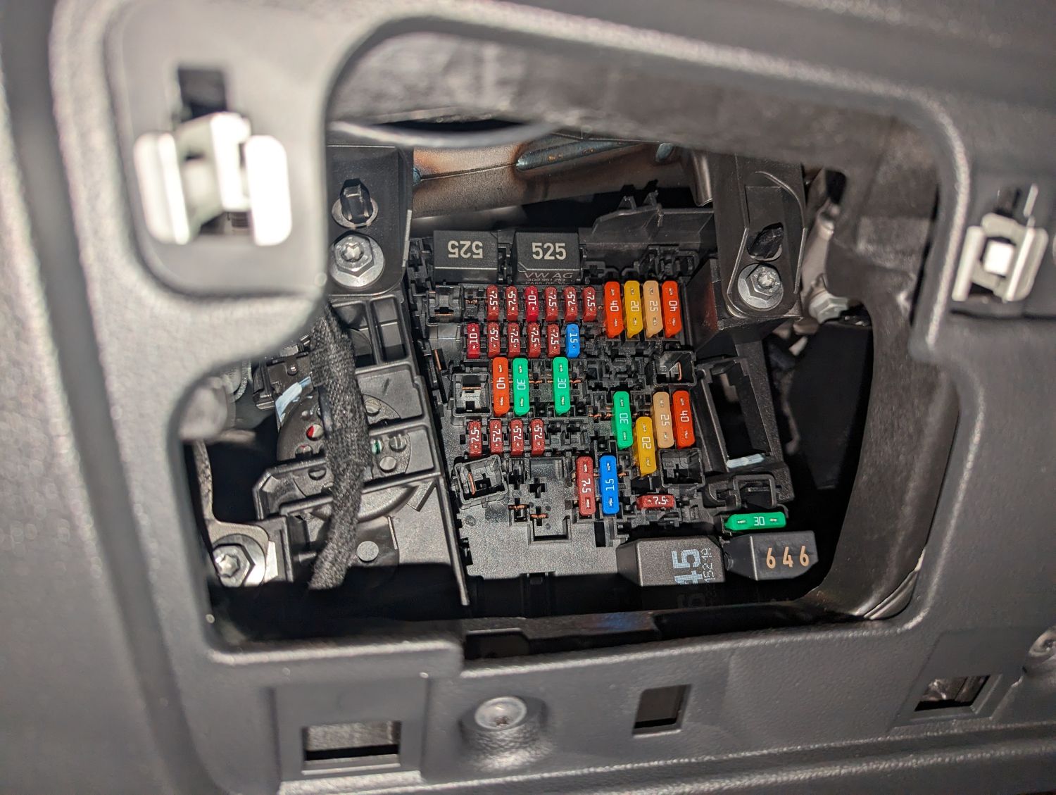

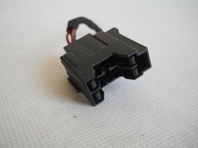

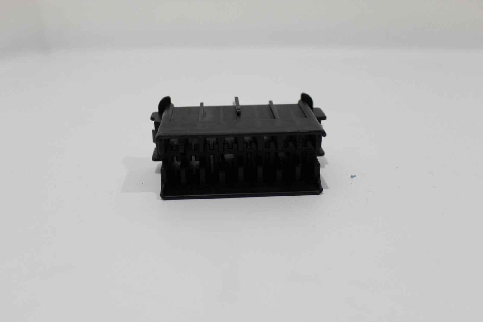

Thank you for your reply. I have managed to find the location of all parts. I want to make the additional fuse box before I start. But my fuse box is on the drivers side. And the spare fuse looks different then the one in Ciclo's post.

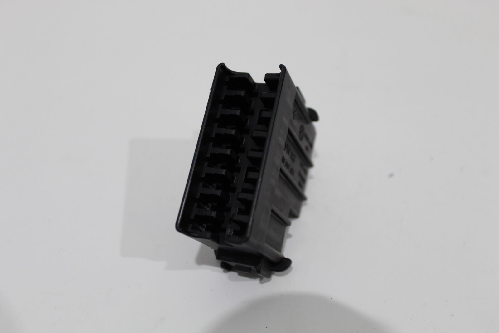

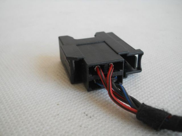

On google I found this two version: 5Q0941824 and 6R0937530
But I am not sure if either of them is the part I am looking for. One has only 2 fuses, and the second one, I am not sure if there are any fuses or if it is just some type of a connector.
Photos of my fuse box on the drivers side (left hand drive) and 2 options I found on ebay bellow:
my fusebox
my fusebox
5Q0941824
5Q0941824_pic1
5Q0941824_pic1
5Q0941824_pic2
5Q0941824_pic2
6R0937530
6R0937530_pic_1
6R0937530_pic_1
6R0937530_pic_2
6R0937530_pic_2

You need Fuse holder (2 fuses) 6R0937530 and/or (4 fuses) 6R0937530A. The price of both is same. 5Q0941824 is not compatible.
I can see a 2 fuse holder slot in front in your fuse carrier, you can use it.
Also there will be more fuse holders in your PDC module bracket attached to fuse carrier. For more details read here viewtopic.php?p=579233#p579233

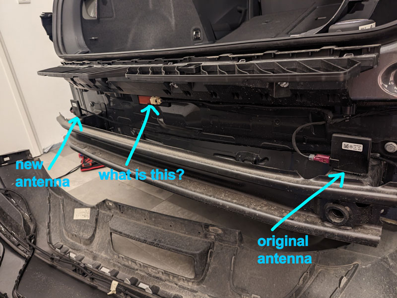

Installed the charger, amplifier and antenna. And connected all wires. I bought a ready made kit from K-----c. The wires with the special plastic connectors could have been 10cm longer, wouldn't hurt them :lol:
Interesting thing was, when I removed the bumper. There was already an antenna installed, same like in the kit. Didn't follow the wires so I don't know where it is connected. Could be for the built in eSim and internet services?? Any way, this was on the right side, so I installed the antenna from the kit on the left side
Although there was already an antenna installed, there was no amplifier. And on the location of the amplifiers, there were to holes, but no screws or nuts, so I had to get creative :D

the original antenna on the right and the new antenna on the left:

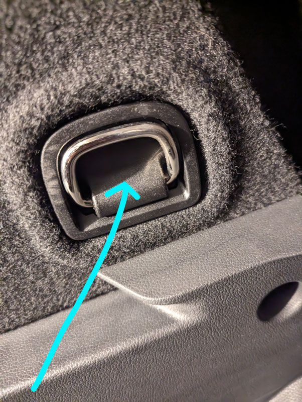

I have broken this small plastics piece that hides the screw of this holder in the luggage compartment. Is it possible to buy just this plastic piece?

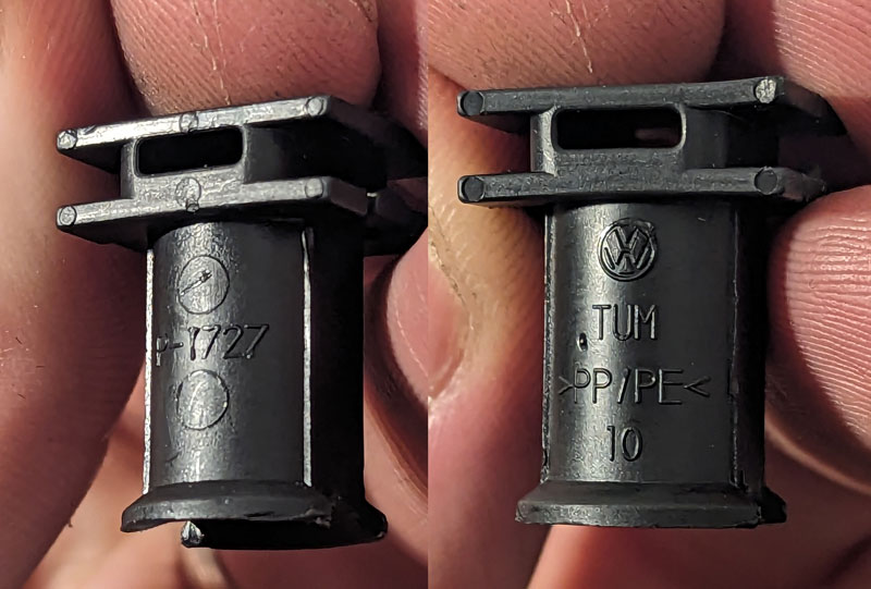

After finishing I have found this part. Don't know where is it from? Maybe some part from the rear bench?

Middle one could be for kessy.
On my polo I have the same antenna, I do have kessy :wink:

spajk wrote: Sun Jul 09, 2023 2:59 am

patil wrote: Thu Jul 13, 2023 10:30 pm
Aha, that's it. I have removed this trim to add route the wires. I must have missed this
