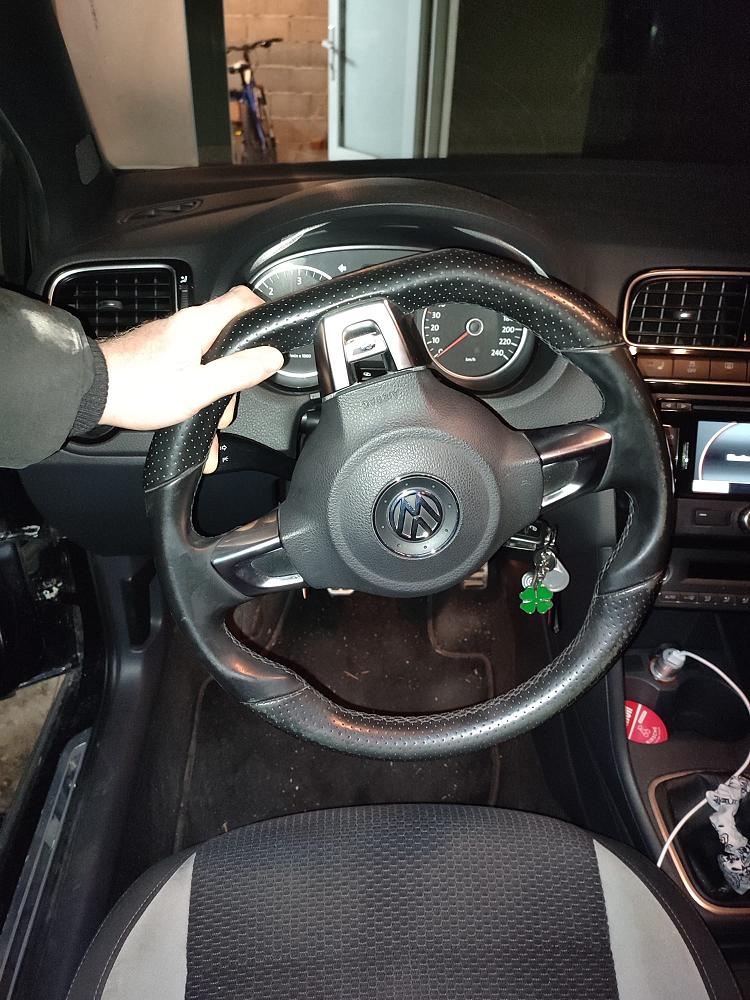

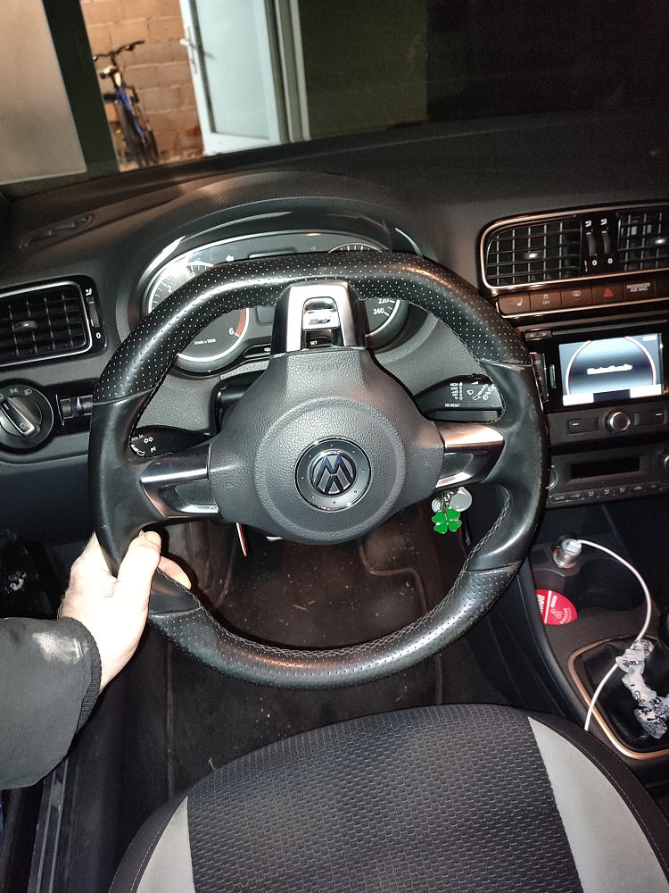

One thing that I notice when I jack front end of car, when turning steering wheel full to left it stays in one angle, and steering full to right, another angle, not sure is it normal?

yes looks like your steering wheel is off-center by one tooth.
