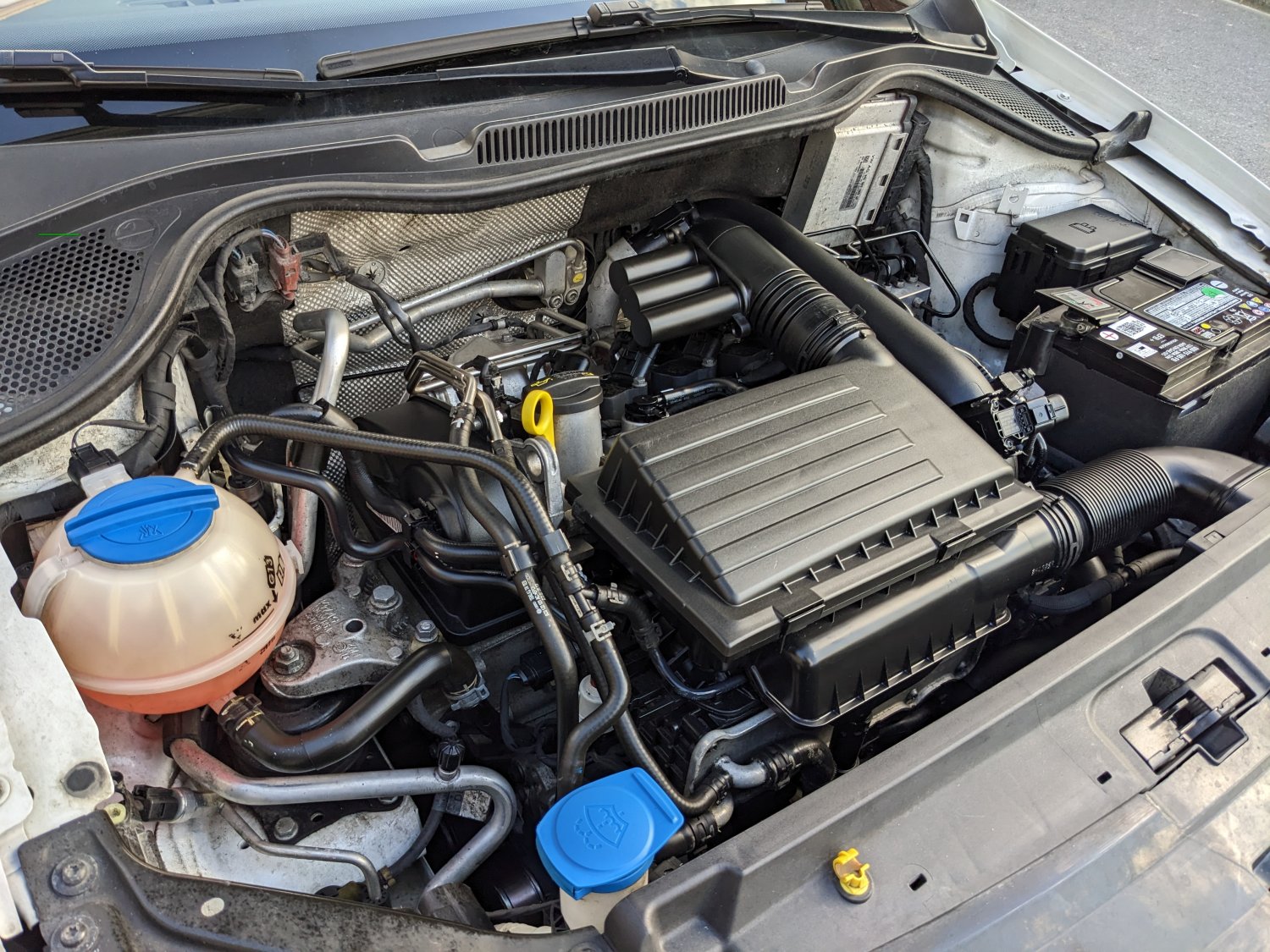

Hey fox, hops you doing well,
Winter is coming slowly and my car seems to have a strange feeling when cold.
1.2 TSI, 66kw engine with 141000km.
When cold, I let it perform it's cold start + 1/2 minutes of running at idle.
On flat surface, everything is fine but one on false flats or hills, with the same accelerator pedals positions, engine is giving some light jerks between 1500-2000 rpm.
But since I drive it every day, I know how the engine feels.
When cold, it start fine, warm too.
The jarking are only when the car is cold.
When the engine is warm, she's running fine.
Spark plug
Fuel filter
Air Filter
Oil
All those items were changed 1000 km. The weather at this time was warmer and no issue at all.
With my OBDEleven I checked:
-Turbo pressure (requested and current value)
-Fuel pressure (requested and current value)
No fault, no codes.
Some people said to me that on this engine, fuel injector are weak. First time I heard that.
Could be also coil igniter or camshaft sensor, all are original and 9 years old/141000 km.
What do you think about that ?
