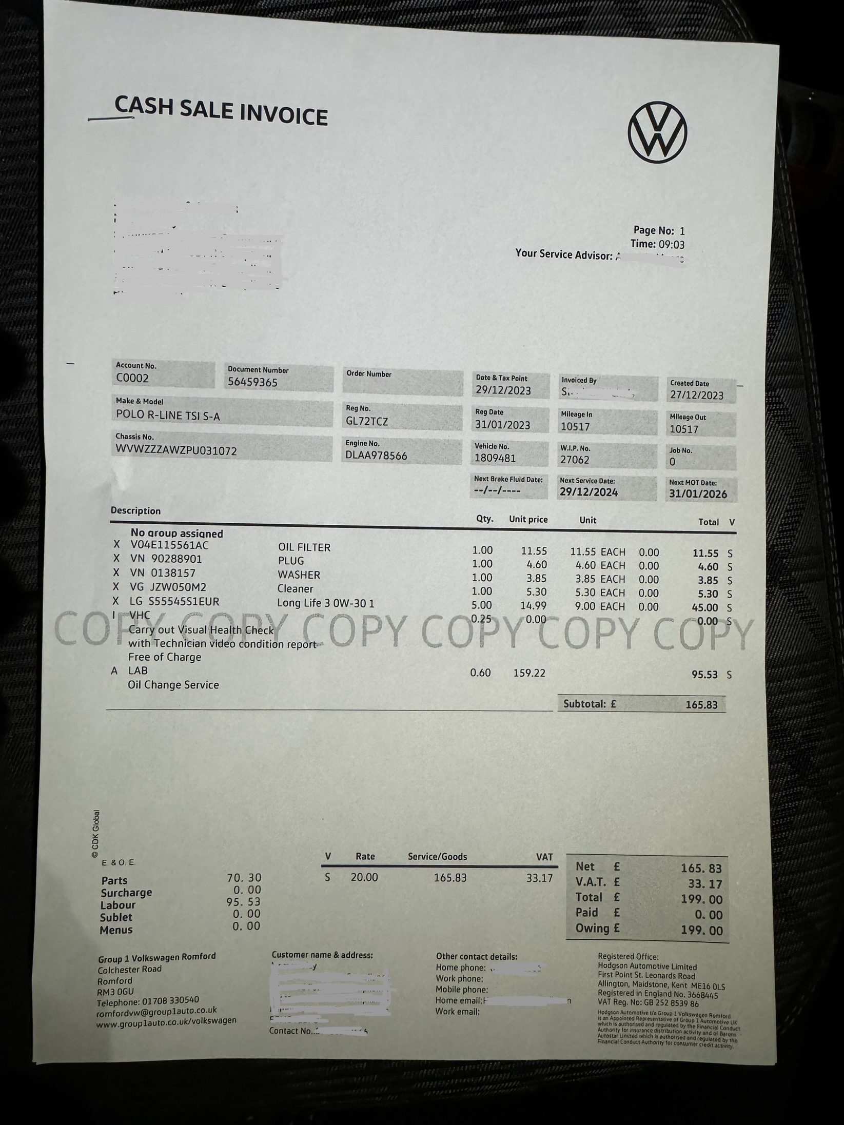

Re: Engine oil 504/507 instead of 508/509💲💲
I took my car for a service at a VW dealer and they used 0W-30 oil with the 504/507 spec! Guess my price worries were unfounded. Still, curious why the manual recommends the much pricier 508/509 for my 1.0TSI with GPF. FYI for anyone else in the same boat!
New engine since 2018 are from factory, filled with 508/509 oil (0W20).Harrihealey02 wrote: Fri Dec 29, 2023 8:40 pm I took my car for a service at a VW dealer and they used 0W-30 oil with the 504/507 spec! Guess my price worries were unfounded. Still, curious why the manual recommends the much pricier 508/509 for my 1.0TSI with GPF. FYI for anyone else in the same boat!
On this engine, you can put alo 504/507 oil (0W30).
BUT !
Engines prior 2018 CAN'T be filled with 508/509 0W20 oils. Damages can occurs.
