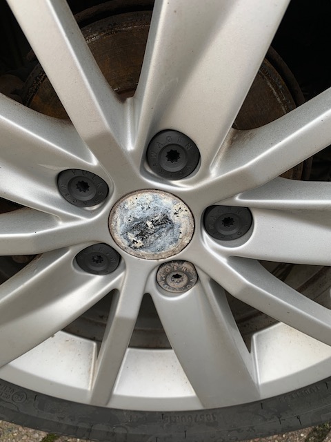

I noticed today that one of the alloy wheel centre caps (not sure of the technical term) has been totally stripped of all colour. Here's what it looked like:

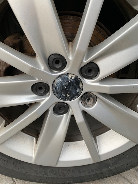

After wiping it down:
This isn't a wear and tear thing, as it was absolutely fine when I last looked, and all the other wheels (now approaching 10 years' old) are fine. It has deteriorated in a matter of days.
It's the rear wheel on the driver's side. I have no idea what could have caused it. My only thought with it being near the fuel cap is petrol, but I certainly don't recall petrol getting on it.
This happened once before, around 2 years ago, and I replaced it. It could have even been the same wheel. Last time I thought it was potentially an over-aggressive car wash, but that's definitely not the case this time.
I don't want to replace it again until I figure out what the problem is. Does anyone have any ideas?

Jeez, really? I know dogs do that but I didn't know it was that strong.
Gonna be hard to stop it happening again in future...

I’m not going to be rushing to get another one, but I will at some point. Pretty sure it must have been a dog to happen in the space of a few days.
I did manage to change it previously pretty easily. If I recall correctly I just prised it out gently with a knife.

@ElAlastair; Some wheel cleaning products will degrade / damage wheel centre caps and the plastic wheel bolt covers. Have you changed the products you use on your wheels or have you started going to one of those hand car wash places, or if you already use the hand car wash places, have you recently started going to a different one? Those places tend to use quite harsh cleaning products to shift the dirt quickly to maximise the number of cars they’re able to clean (more cars cleaned = more money earned for them) and harsh cleaning products can strip wax / sealant protection off the car’s paintwork and damage / dull plastic trim parts. Also, some dedicated wheel cleaning products may be acid based rather than ph neutral, so can also damage centre caps and wheel bolt covers.
I see you also have one wheel bolt cover that is faded compared to the others (it’s usually the cover on the locking wheel bolt that reacts to harsh cleaning products) which might suggest a cleaning product is perhaps partially to blame for the deterioration of both the bolt cover and centre caps.
As a matter of interest, when you changed your centre caps, were the replacements genuine VW or non-OEM items from one of the many online sellers on the likes of eBay? If the latter, then it’s not unknown for the finish of some of the copies to be less durable than the OEM VW items.

SRGTD wrote: Sat Jan 27, 2024 9:21 pm @ElAlastair; Some wheel cleaning products will degrade / damage wheel centre caps and the plastic wheel bolt covers. Have you changed the products you use on your wheels or have you started going to one of those hand car wash places, or if you already use the hand car wash places, have you recently started going to a different one? Those places tend to use quite harsh cleaning products to shift the dirt quickly to maximise the number of cars they’re able to clean (more cars cleaned = more money earned for them) and harsh cleaning products can strip wax / sealant protection off the car’s paintwork and damage / dull plastic trim parts. Also, some dedicated wheel cleaning products may be acid based rather than ph neutral, so can also damage centre caps and wheel bolt covers.
Thanks for the info.
The first time this happened I thought it might be as you said - harsh cleaning products - but this most recent time definitely isn't that as it's been a while since I cleaned it. The bolt cover has been faded for a while and a lot more gradual; the centre cap literally went like that overnight out of the blue.
This is a genuine VW part.
