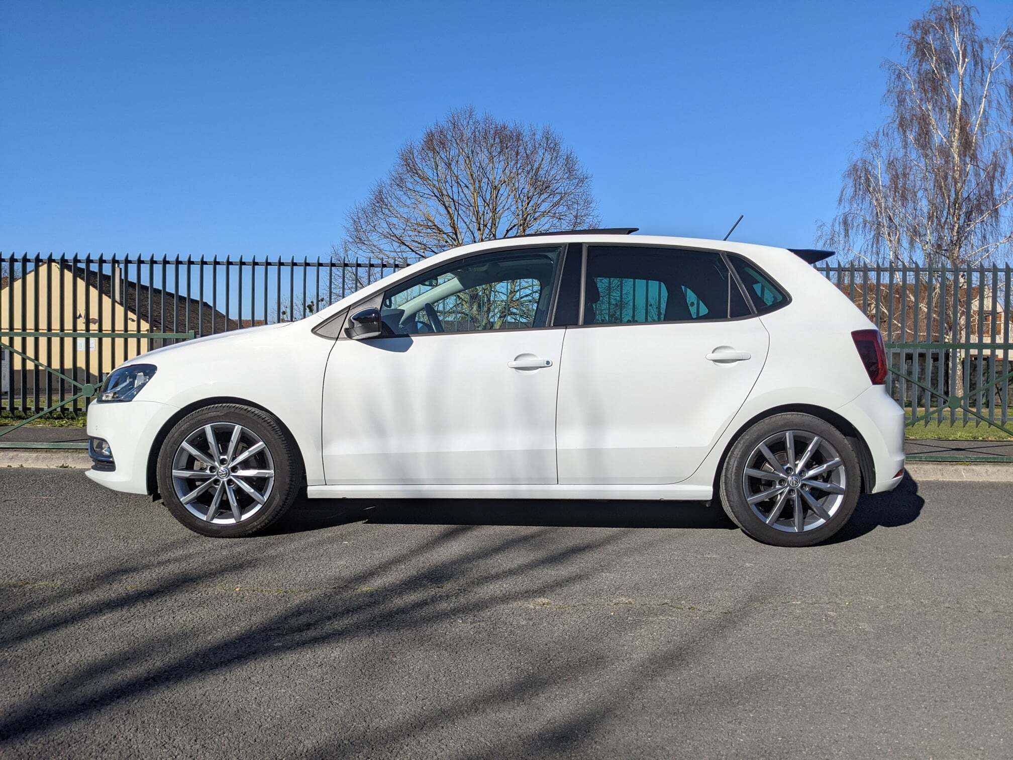

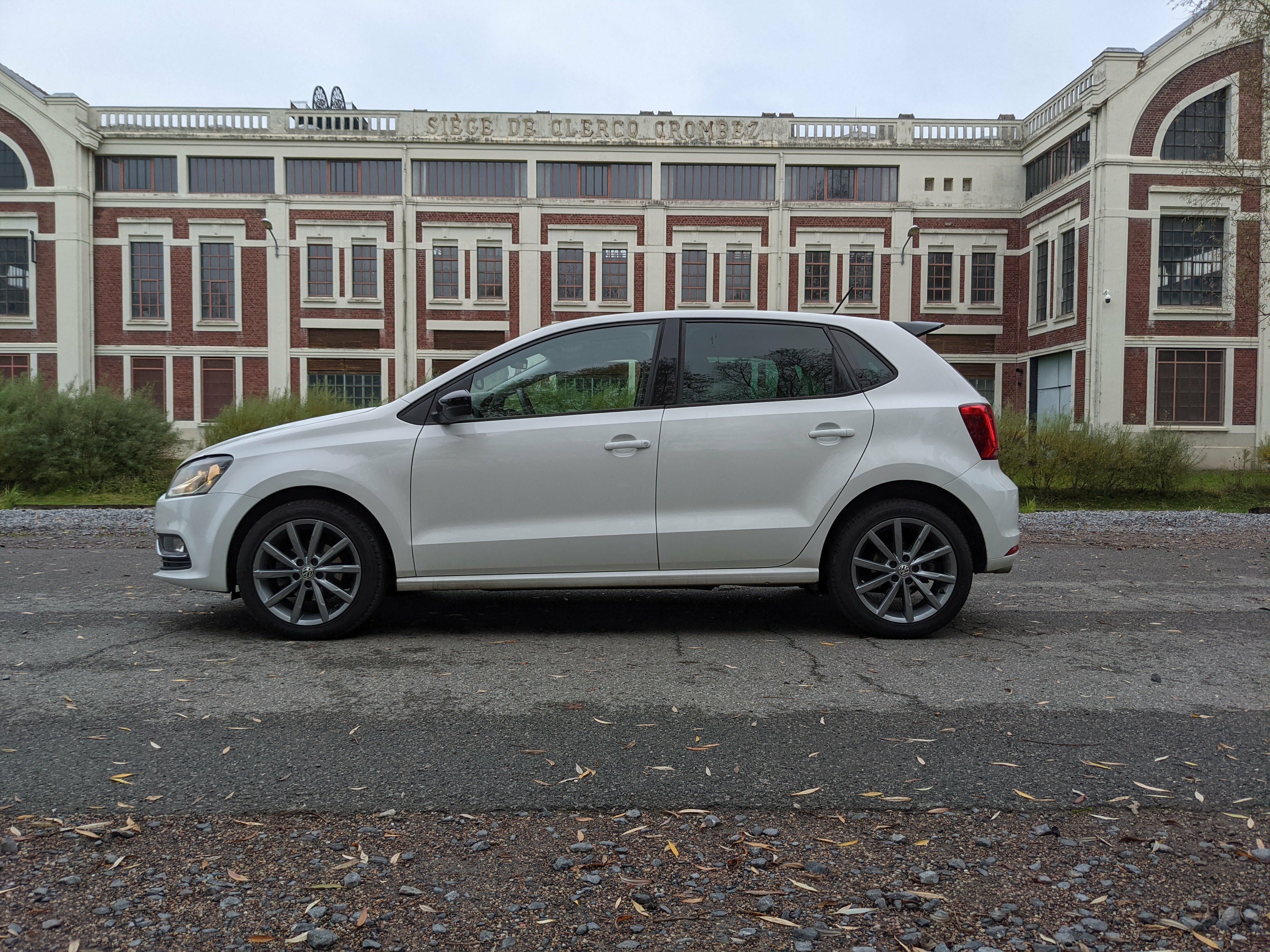

Stock car (few years ago):
Lowering spring installed:
What are your opinions ?

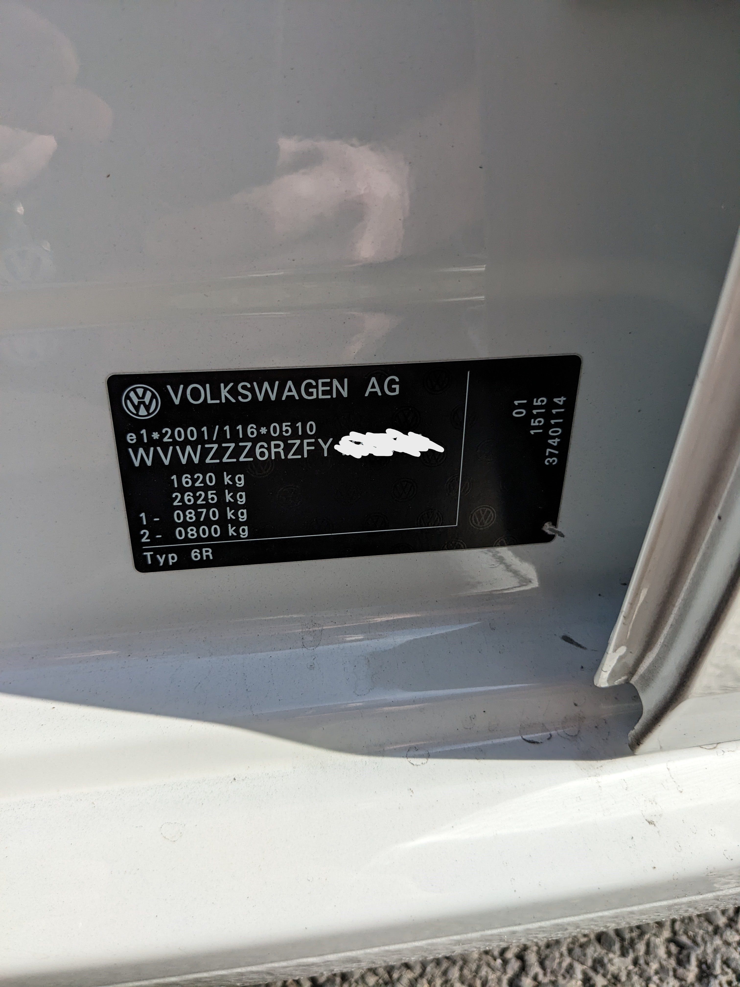

On the axle weight identification label of my 6R I have this data:
A little bird. :)

Thanks for the picture :)
Here is mine:
A little bit heavier at the back :roll:
Did you remember the of the part number of the front and rear spring for the GT ?
Mine is currently lowered with VW Spring kit 6R0071677
860KG
770KG
