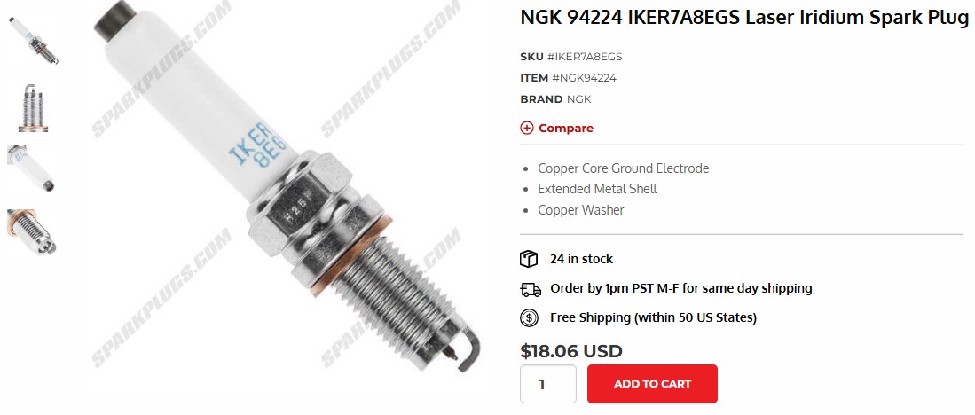

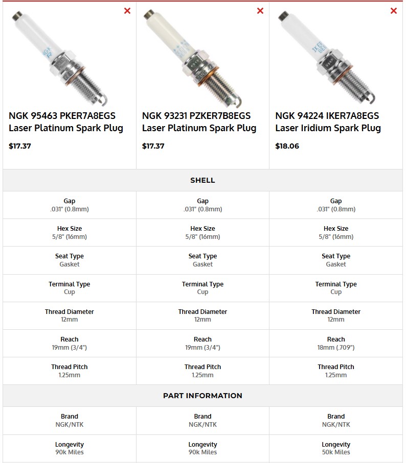

Hello everyone, in the recent months i was using this forum very frequently now i wanted to share my experiences and adventures throughout the ownership of the car. I am scissa and i live in Turkey. I am a mechanical engineer and had experiences in automobile industry at production plants.
The car is 14/5/2015 Comfortline equipped with CJZC EA211 1.2 TSI 90hp with PED 5sp. manual transmission. It has been purchased from the first owner at 8/2018, Currently it is at 103600 km's and it is increasing.

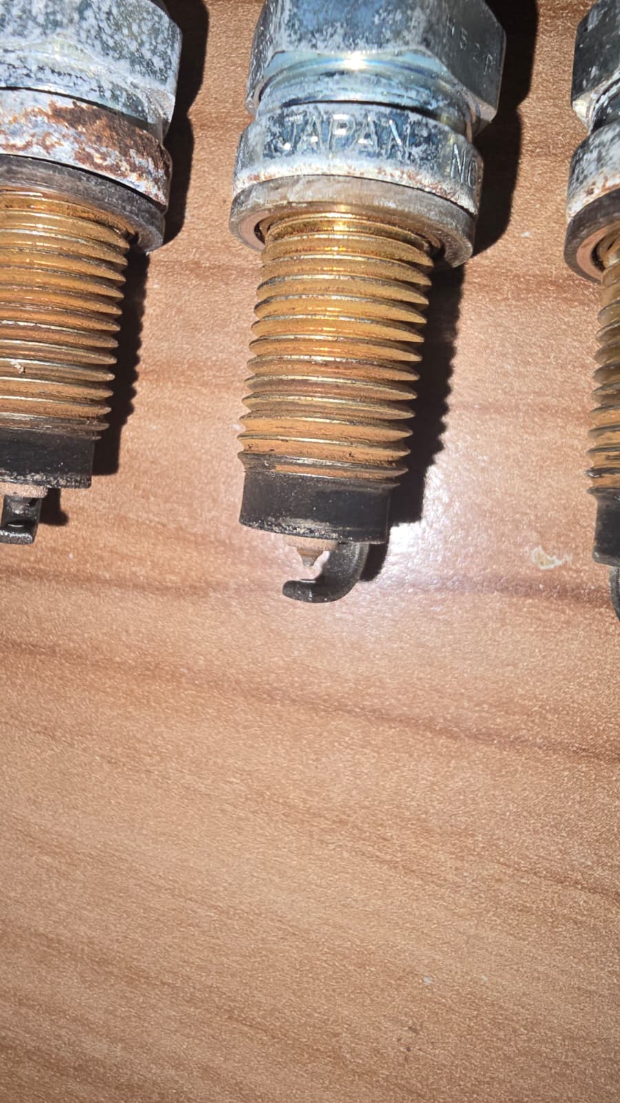

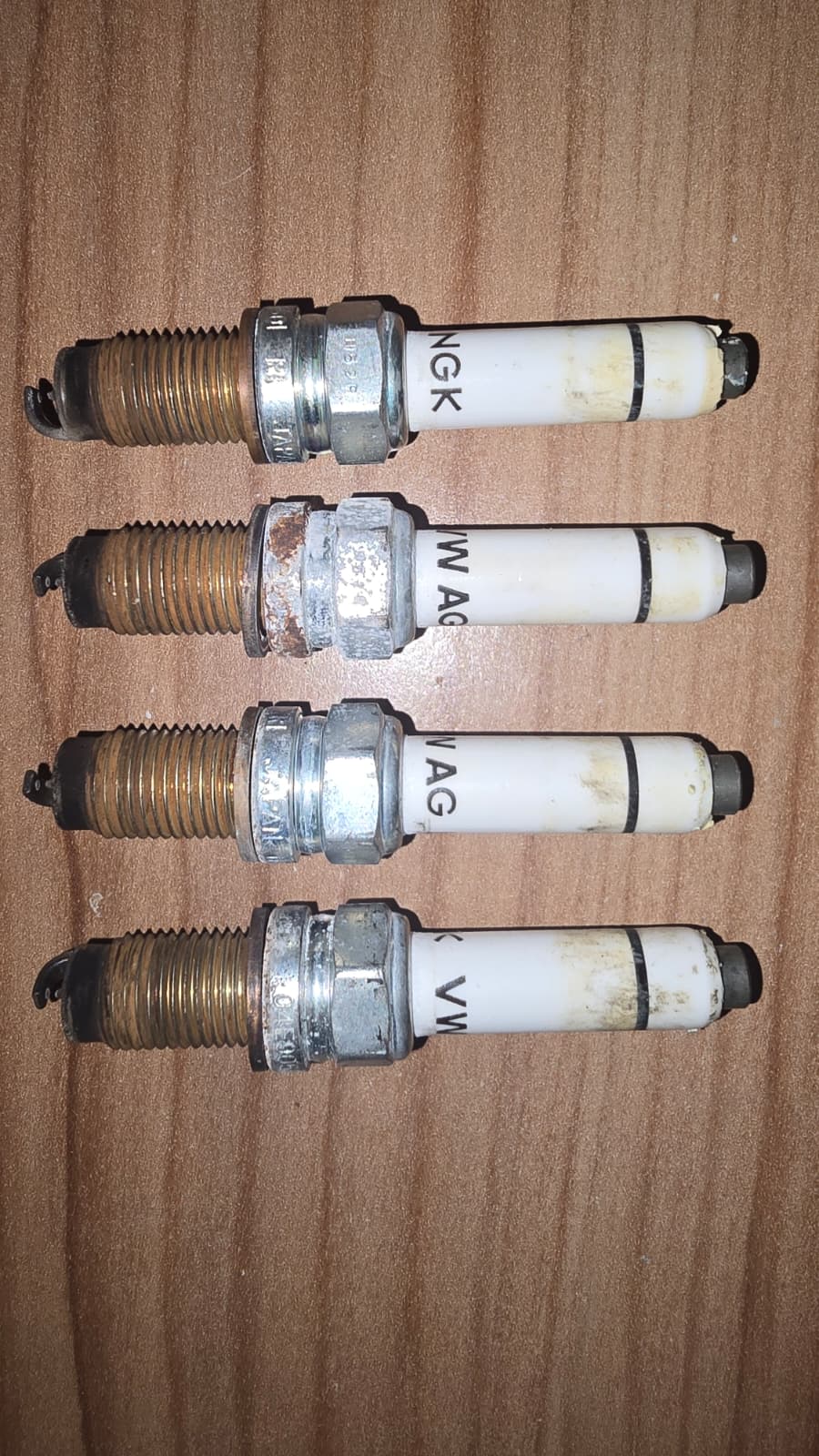

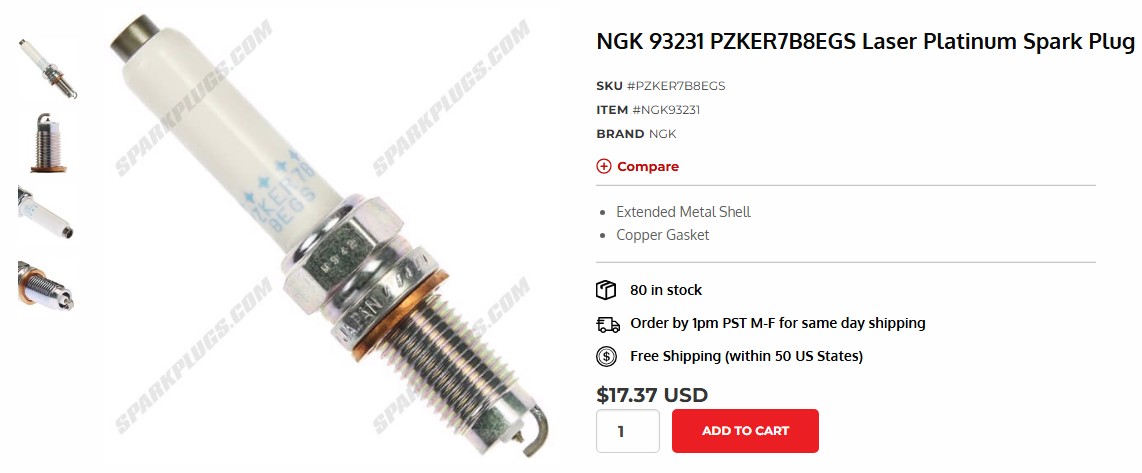

Recently, i have changed the spark plugs with a different one from the catalog and parts list. I used NGK 94224 IKER7A8EGS Iridium, which is service part for EA211 evo, or 1.5 TSI and 1.0 TSI models.
The stats were looking the same except the material and reach of the spark plugs. The EA211 1.2 and 1.4 TSI engines do originally use NGK 95463 PKER7A8EGS Platinum plugs.
I believe Iridium plugs are better compared to Platinum ones.
Since there was nothing to lose, I wanted to give it a shot. The specs of the plugs are:
Image Platinum Plugs
Image Iridium Plugs

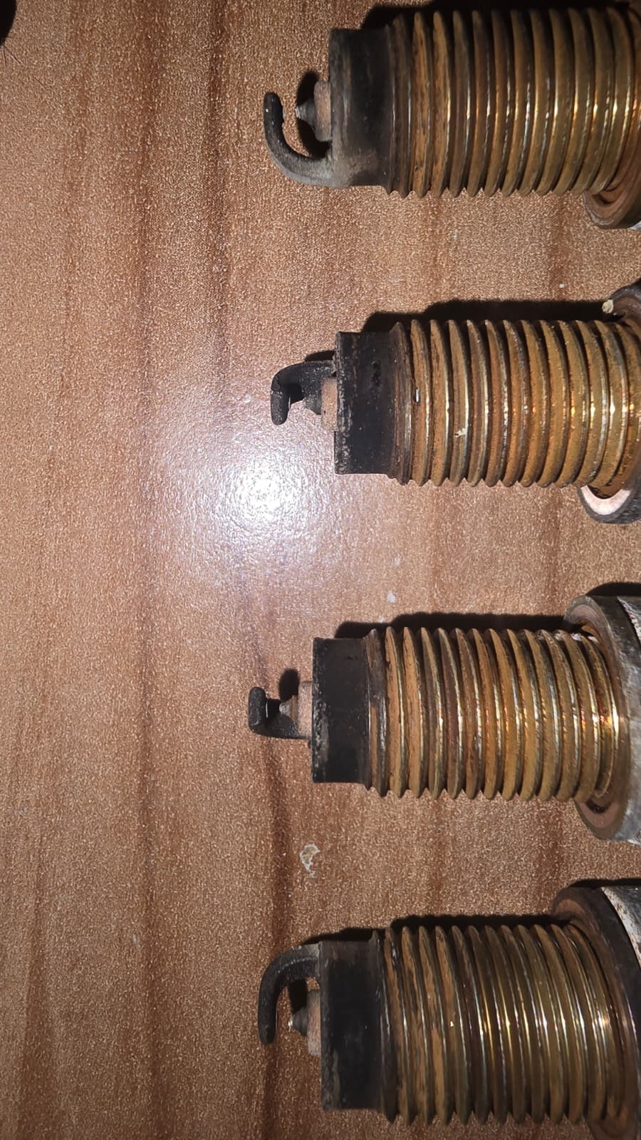

When the plugs were original, the car was not misfiring on VCDS but i was definitely feeling them randomly at idle. I guess they were below the threshold to register as misfire.
When the plugs were changed first, the idle was horrible and the engine was about to leave the engine compartment :lol:
After few start and stop cycles, the result turned out to be absolutely amazing. Now the car is not sluggish anymore at any condition, it can pull from stand still like a rocket, or no need to downshift when climbing a hill with very low RPM such as 1300. Also, it consumes less fuel now.
I couldn't find any sources on the internet for this upgrade (except https://world.taobao.com/lang/en-us/goo ... 080876.htm), so i decided to create a guide for it for everyone who searches it.

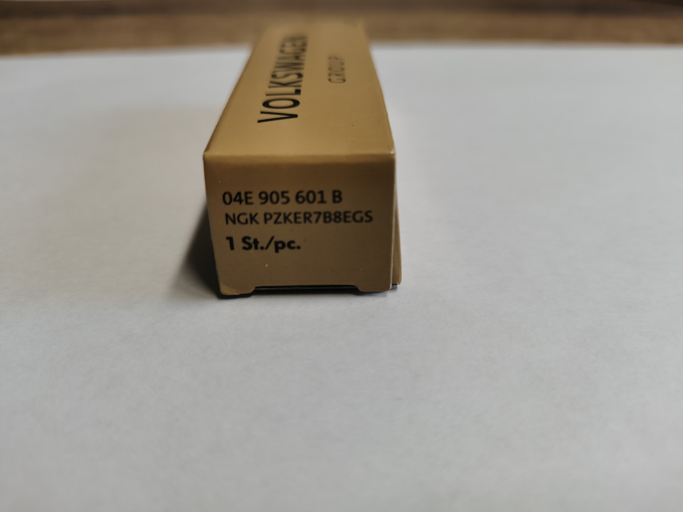

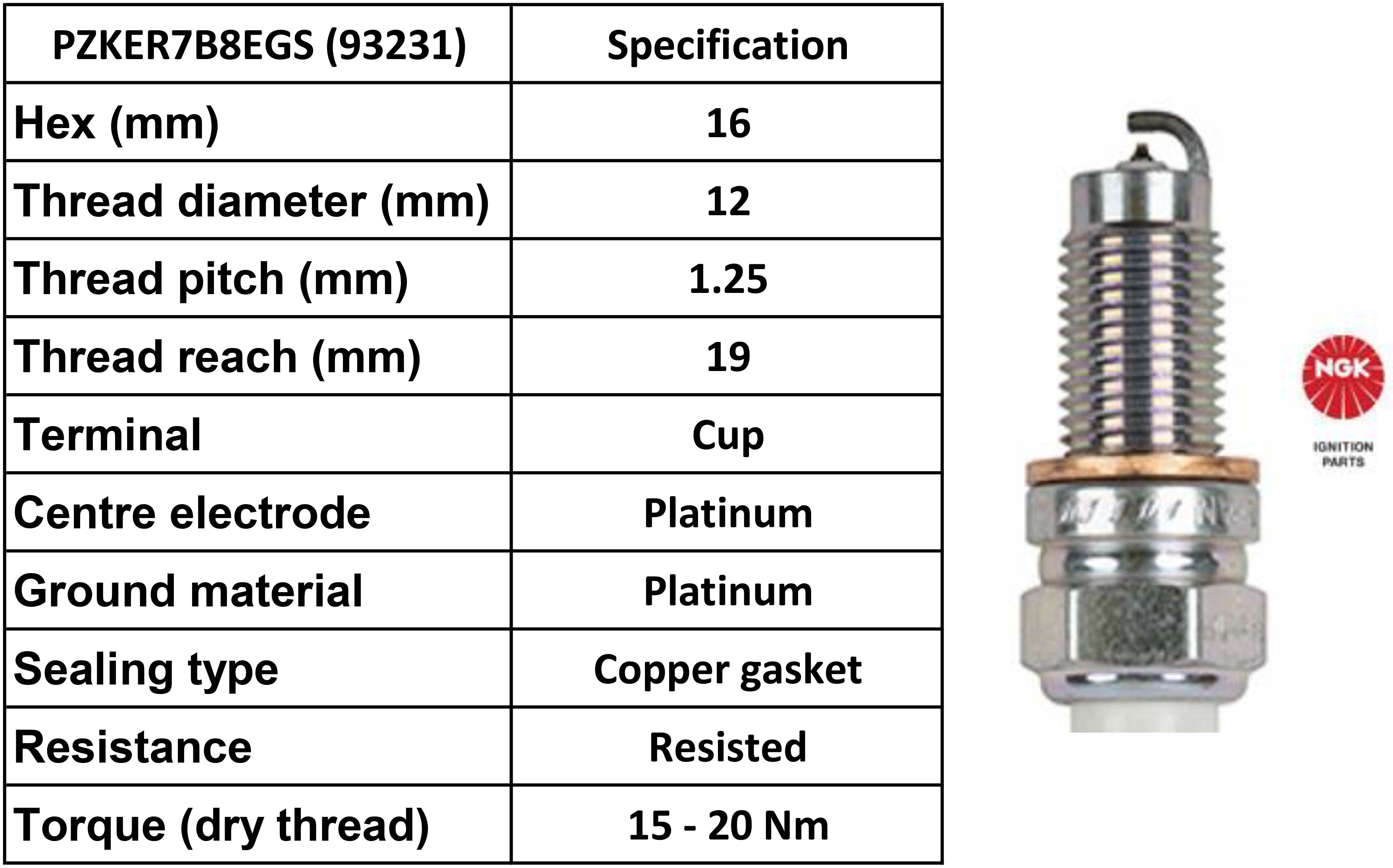

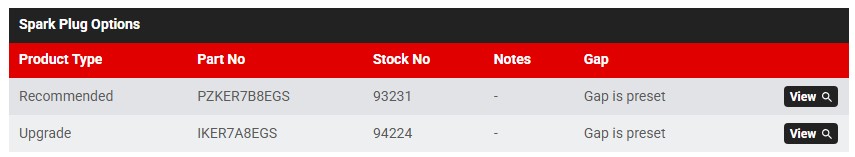

Your stories about spark plug is quite interesting but... there is something I do not
understand.
My car is end 2014, 1.2 TSI 16V E211 engine CJZC.

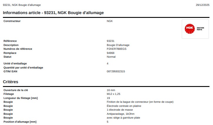

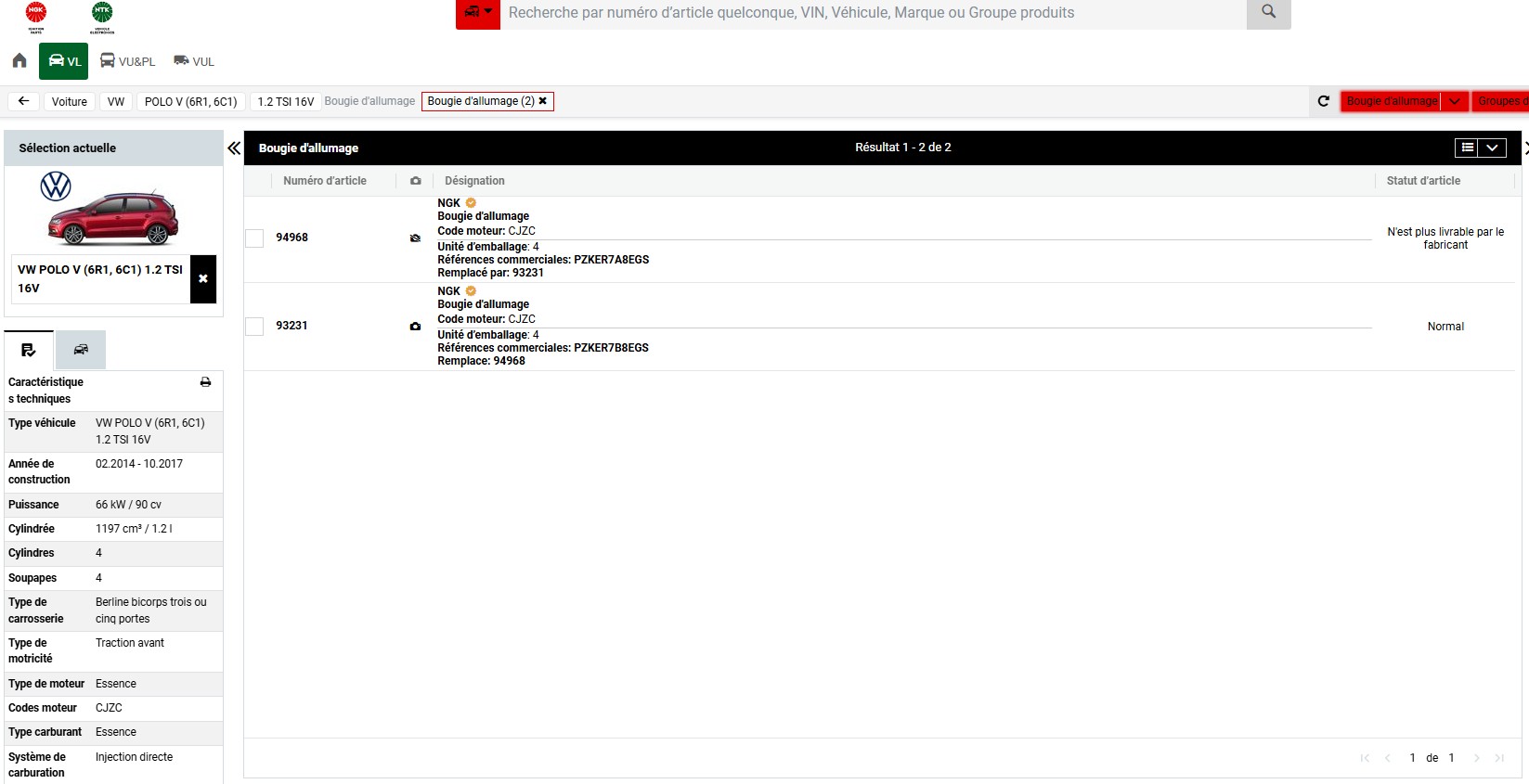

On ETKA, the P/N of the sparks plugs are: 04E905601B
According to NGK website part's, it's the "PZKER7B8EGS" (­94968, replaced by 93231) and not the "95463" as you wrote previously.
Capture d’écran 2025-12-28 150749.jpg (146.07 KiB) Viewed 10985 times

Yes, i also replaced the factory fitted - in 2015 "A" version of these spark plugs with the "B" version, I never found out if the NGK "A" and "B" versions were exactly the same as the "A" and the "B" versions of the VW Group part numbers, but they seem to work okay.
What I discovered when I first fitted them to my wife's August 2015 VW Polo 1.2TSI 110, ie a CJZD engine, was that the SEAT Ibiza and maybe SEAT Leon with the CJZD engines were listed by NGK use the "B" version for 2015 built cars, but the VW Polo with the CJZD were listed as using the "A" version while the CJZC was listed as using the "B" version of the NGK spark plug.
I put that "irregularity" down to just a mistake on the part of NGK Europe, as by that time, the VW Group parts listing quoted the "B" version of the VW Group rebranded NGK spark plugs.

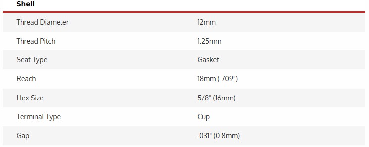

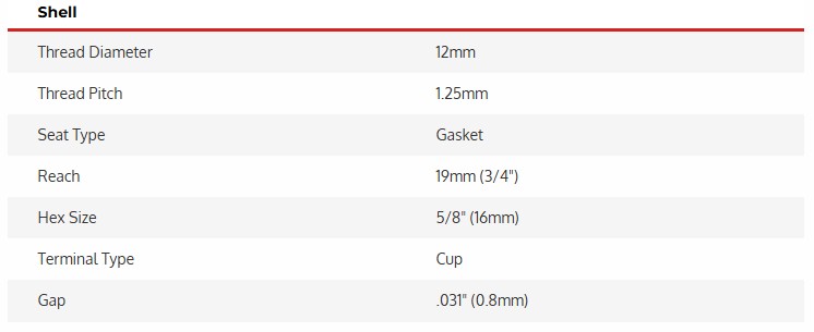

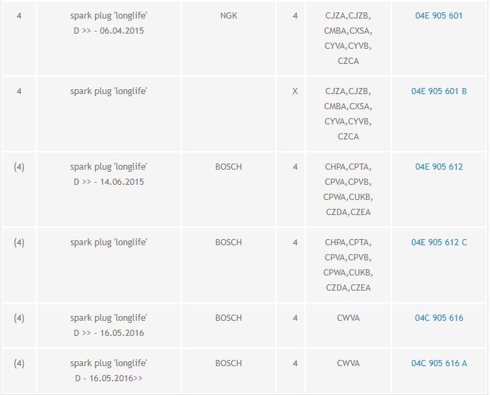

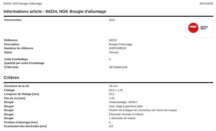

So what are the difference between the A and B version ?

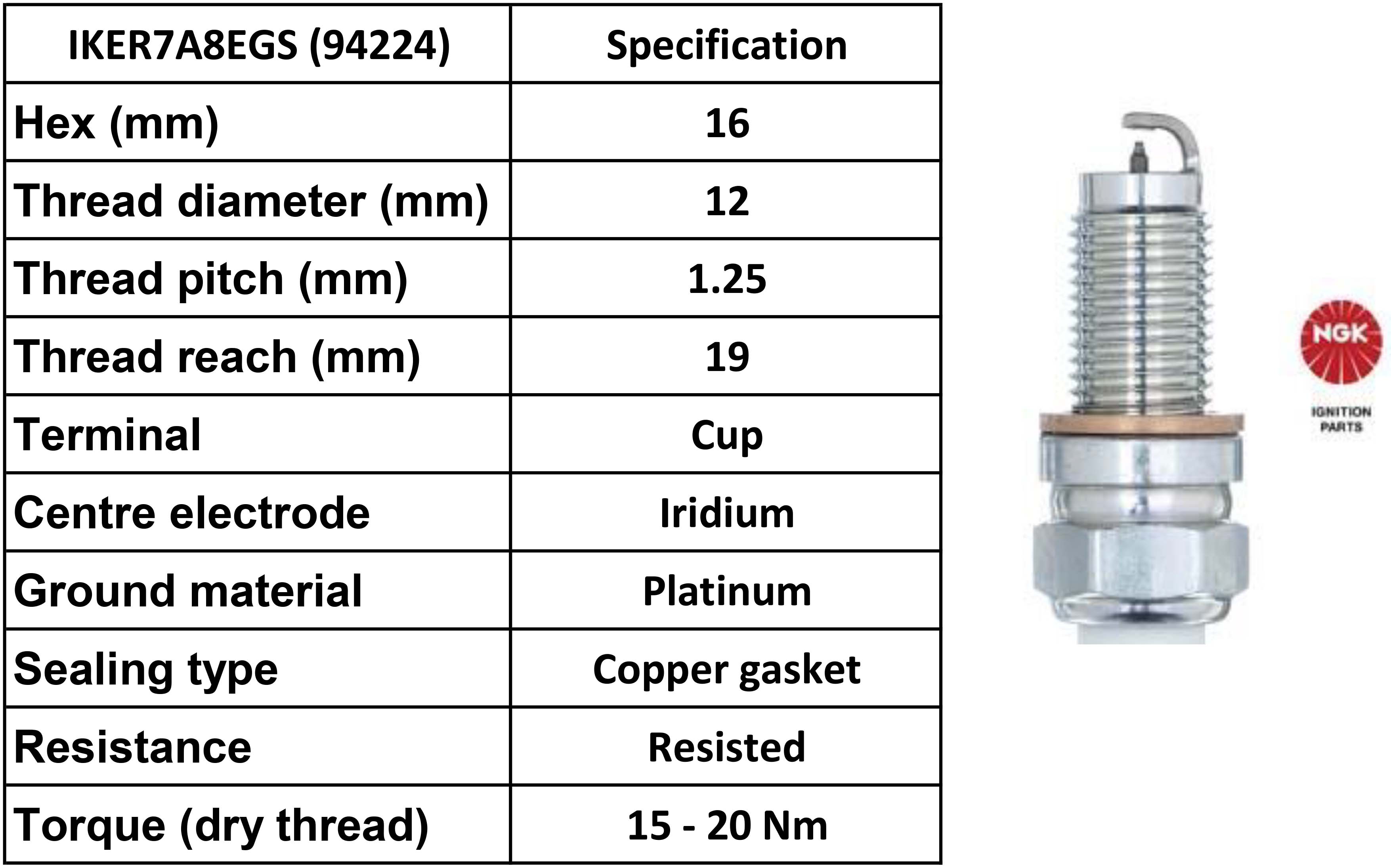

Because according to some website, some spark plug listed in the first post have a longer thread (the iridium one).
So it's quite confusing.
It's even more confusing when you see contradiction from the manufacturer like this:
Here: thread lenght is 19mm between the two
And here ? 19 and 20.5mm
Capture d’écran 2025-12-29 163504.jpg (40.71 KiB) Viewed 10911 times
Capture d’écran 2025-12-29 163536.jpg (41.3 KiB) Viewed 10911 times

Very confusing. Even the specs in the 1st post indicate 1mm shorter on the Iridium.
If I hadn't done my plugs last year and spent a fortune on them, I might be looking at getting these Iridium. I'll wait until the next 100,000km is done. :-D
Re: Scissa's 2015 Polo 1.2 TSI
Posted: Wed Dec 31, 2025 2:42 pm
by Le_Combattant
Yeah but how to be sure to not damage the piston because of the extra lenght ?
Posted: Wed Dec 31, 2025 7:03 pm
by Le_Combattant
So, the the CJZC/CJZD engines, the sparks plugs are "04E905601B"
Or "PZKER7B8EGS" (93231):
So on NGK website:
-"04E905601B" (PZKER7B8EGS (93231)):
Capture d’écran 2025-12-31 195625.jpg (68.32 KiB) Viewed 10828 times
Capture d’écran 2025-12-31 195726.jpg (22.61 KiB) Viewed 10828 times
-NGK 94224 IKER7A8EGS:
Capture d’écran 2025-12-31 195644.jpg (70.39 KiB) Viewed 10828 times
Capture d’écran 2025-12-31 195741.jpg (23.52 KiB) Viewed 10828 times
So the Iridium one is shorter than the platinium one of 1mm if, the NGK website said the truth.

So anyway, I went to dig up the OEM plug I got out of my CJZD. Measured with caliper from base of washer to end of shroud: 20mm. Threaded part of that is just 16mm long.
All looks good then. Would be interesting to try the iridium and see if I get the same results. Pricey experiment for me though.

The "reach" lenght is indicated as following:

Here are the main sparks plugs we were talking about:
Capture d’écran 2026-01-01 142310.jpg (115.77 KiB) Viewed 10777 times
For wathever reason, this website (https://www.ngkpartfinder.co.uk/catalog ... POLO/2015/), indicate the "95463" for the CJZD
which is the same engine as CJZC.
But in both case, it"s indicated that both 95463 and 93231 are replacable by 94224
Capture d’écran 2026-01-01 141416.jpg (27.13 KiB) Viewed 10777 times
Capture d’écran 2026-01-01 141439.jpg (23.58 KiB) Viewed 10777 times

Edit:- "For wathever reason, this website (https://www.ngkpartfinder.co.uk/catalog ... POLO/2015/), indicate the "95463" for the CJZD
which is the same engine as CJZC." Yes, even sillier is, I think if you checked that website for SEAT Ibiza 1.2TSI CJZD and/or Skoda Fabia 1.2TSI CJZD, you would probably find that both the CJZC and CJZD used the same 93231 spark plug.

Le_Combattant wrote: Wed Dec 31, 2025 10:52 pm We are agree that the sparks plugs you have on your CJZD are the 04E905601B ?
Yes, they were B.
Le_Combattant wrote: Wed Dec 31, 2025 10:52 pm So, in this case, the iridium could be installed.
Would assume so then.

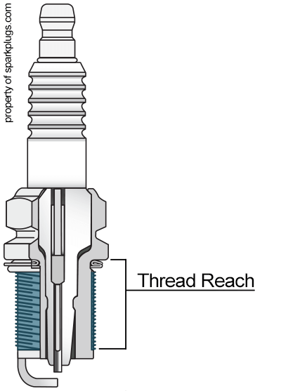

Le_Combattant wrote: Wed Dec 31, 2025 10:52 pm The "reach" lenght is indicated as following:
Everyone has different interpretation it seems.
In this case, it measures 18mm on the B plug I have.

Yup you are right.
On the SEAT Ibiza, both CJZC and CJZD are indicated to used 93231 sparks plugs (with 94224 upgrades).
Same for the Ibiza.
It's a fuc***** mess there.
