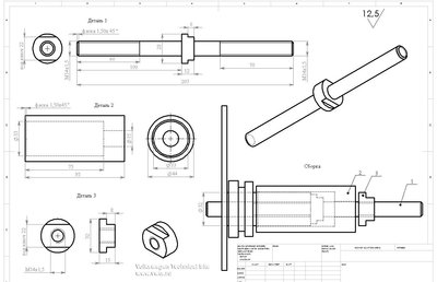

For replacing the crankshaft sprocket on my engine I used two homemade tools. I will post photos and more details in my thread.
