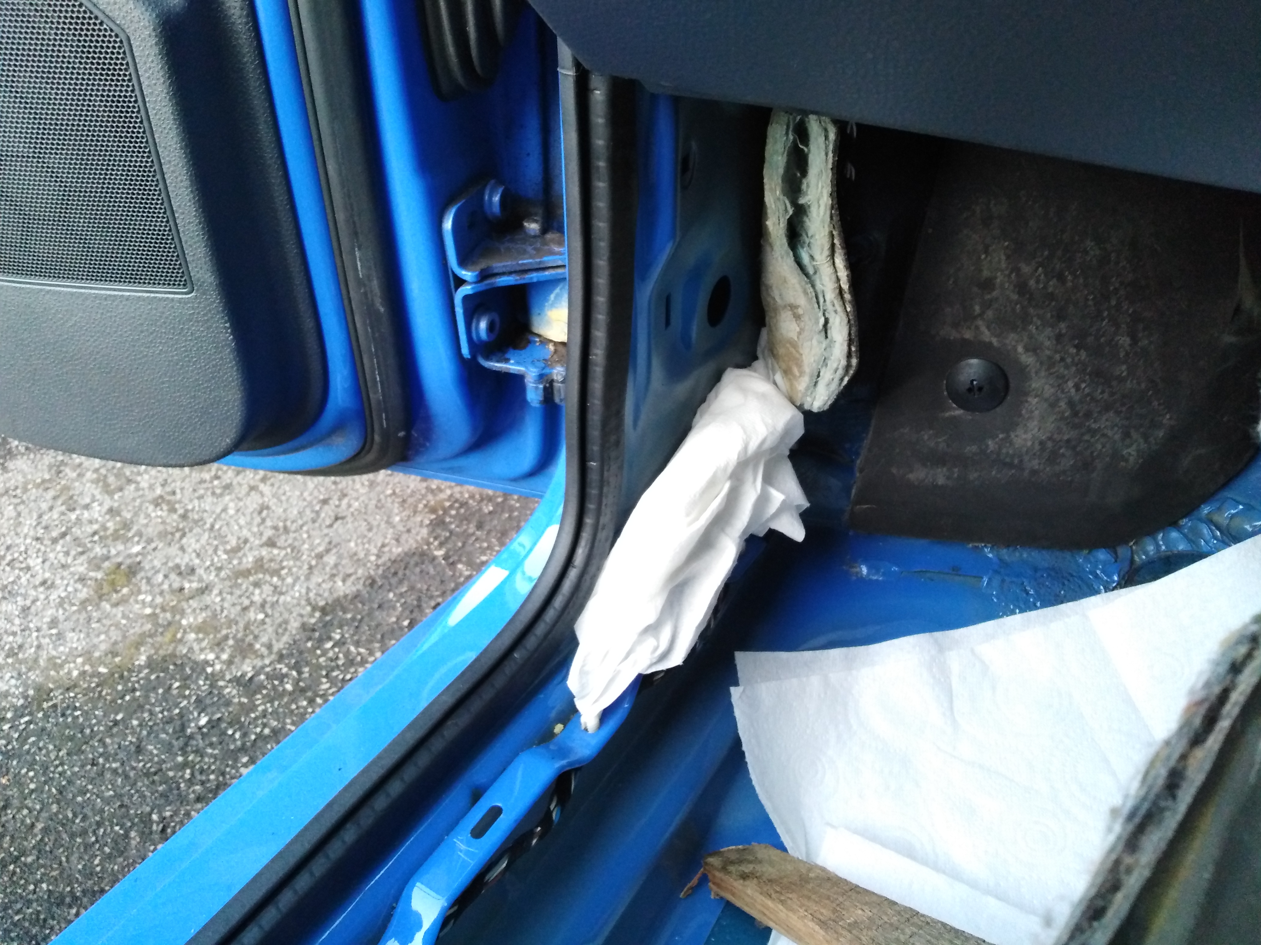

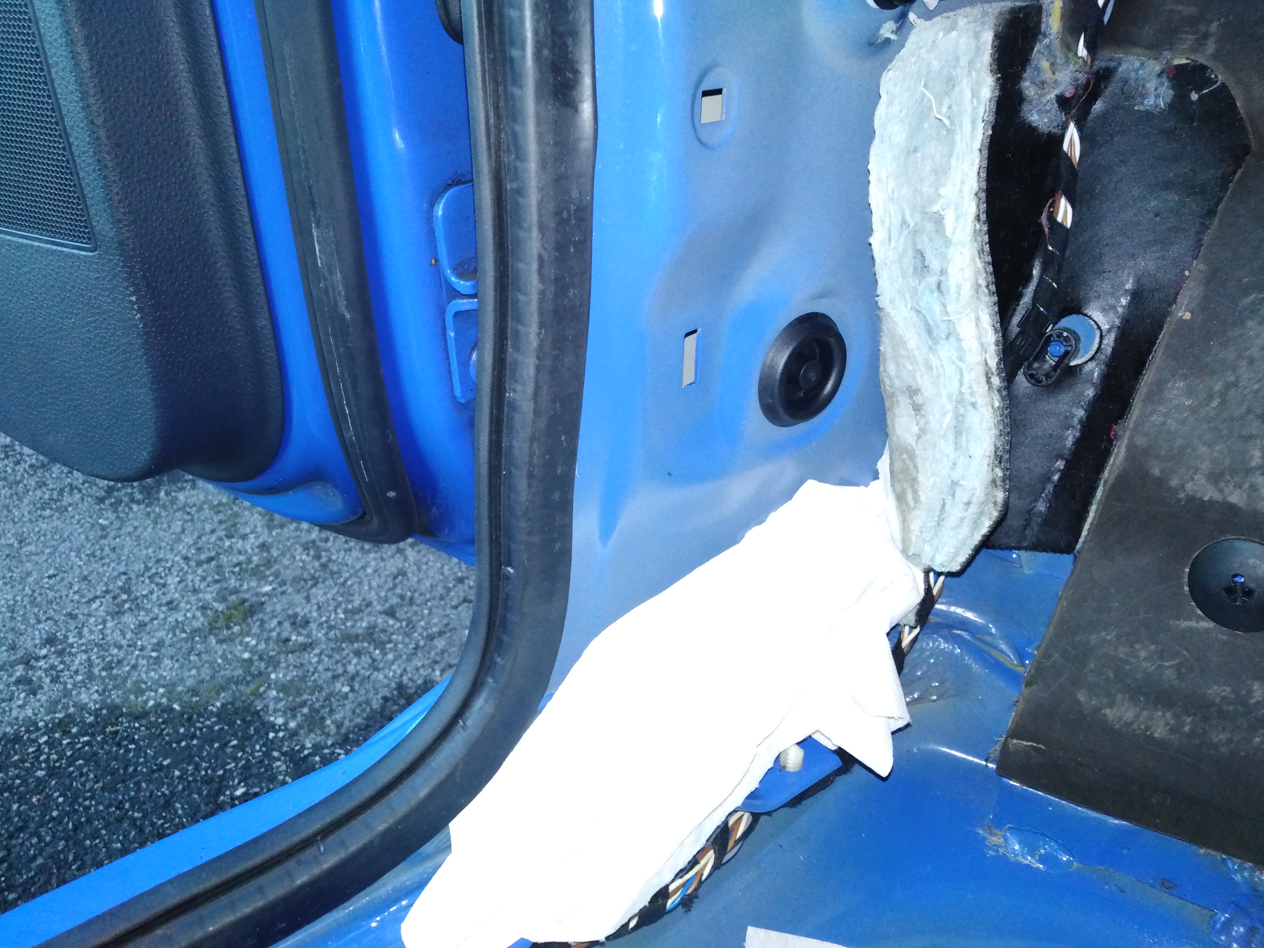

Hi, I've not long had my first Polo 9n. However I have one issue, this is that water is somehow getting into the front and rear passenger foot wells. The rear was a pond before I noticed .

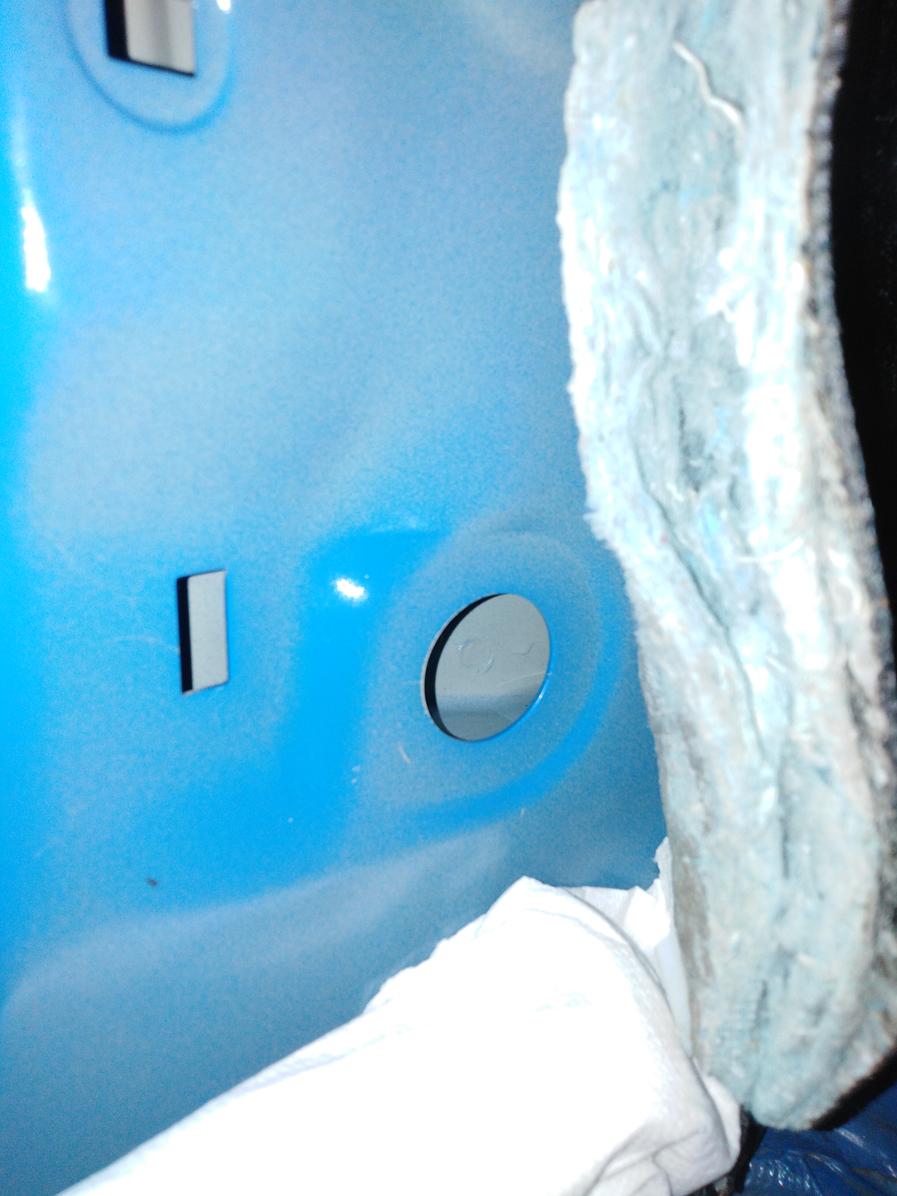

We have had some heavy rain recently but the leak also occurs in normal amounts of rain. I believe I have found where the water is getting into the foot wells but cannot figure out why. I found the water seems to be seeping past a rubber bung which I would guess is to do the bonnet release for left hand drive models. There should be a picture of where I mean attached to this.
The problem is, I cant figure out how the water is getting into this section or why it builds up in there to the extent it is seeping past the rubber bung.
My initial thought after a lot of research into this was that the scuttle drains where blocked especially as when testing these did tend to take a while to drain away, however after cleaning these the best I can with the limited access I have it doesn't seem to have made any difference. the water drains form the scuttle quicker and out of the bottom of the car much better than before but water still seems to end up in the said hole.

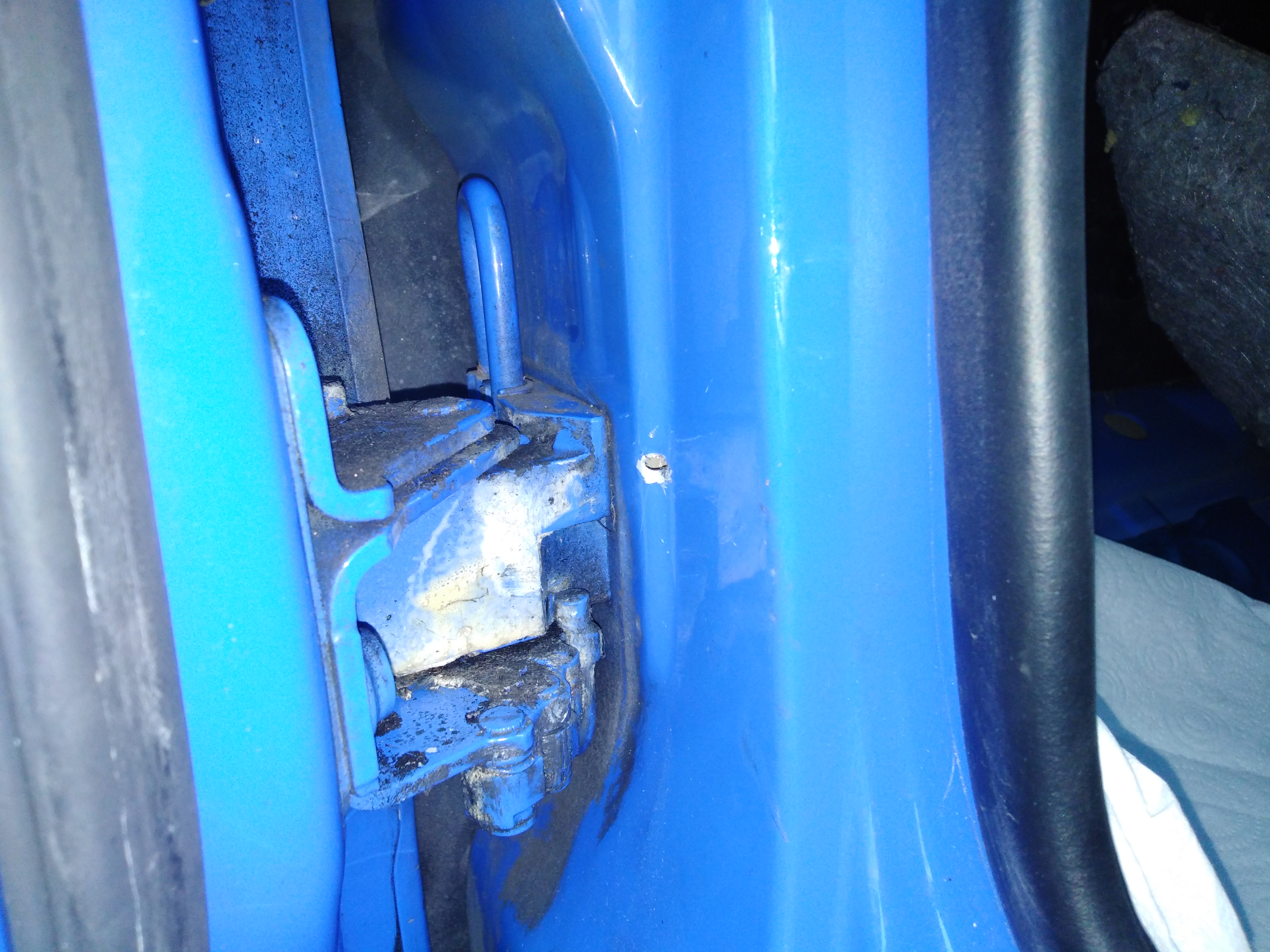

The other thing I have tried is drilling a small hole next to the door hinge, behind the hole where the water is, to at least drain the water out of there before it can get into the cabin, but I haven't completed this as this section appears to be double skinned and if I drill through this internal centre layer, the water will end up in the sill which seems even worse to me.
I hope somebody can help because I'm completely out of ideas and am struggling to find anything else on the internet that helps me.
Also the car is a 2002 VW Polo 3dr with no sunroof.
Thanks,
Harry

I have been doing quite a few watering can tests but don't seem to be getting anywhere with them. I stuff tissues around the hole and stop pouring water when they get wet. When doing these tests water definitely pours out from underneath the car.
I can't be certain if there would be any bungs that are in the flow of water from the drains but like you say, it would be a bad design if their was. The only way I could think of to find this out is to dismantle the hole dashboard and plenum/scuttle assembly, and I don't really fancy that, especially as I haven't sourced a Haynes manual yet and need the car daily.
I'm not to sure about what you mean with the spot welding, what is there to weld? Especially as there are no major spots of corrosion/rust. The only place a have found rust is on the wings, right on the edge where the metal is thinnest and I wouldn't think that is anything to do with my leak.

The car will leak when it is sat or moving. There is no water behind the dash, only the bottom of the carpet gets wet.
Water does not seem get into the car elsewhere and I have proved this by stuffing a tissue in the hole and using it to direct water into a bowl. The bowl will contain the water and nothing gets wet inside the car. So that bung hole is the only place water is getting into the car.
