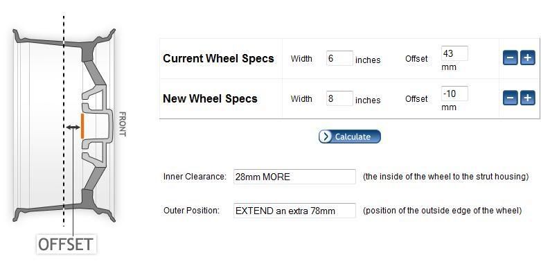

just managed to answer some of my own questions by actually looking at my wheels... aparantly the are 6j with an offset of 43.
according to:
http://www.1010tires.com/WheelOffsetCalculator.asp
the wheels that i want, weller steelies will stick a whopping 78mm further out of the arches... is this the case?
This seems abit weird as there is a blue 5 door 6n polo ive seen in Performance VW and that was up for sale on pistonheads a while ago that insprired me to get these wheels, and they deffinitly wernt 78mm out of his arches...

according to:

With them being only 13", you will have less problems with the width and offset compared to 15s. But i'm not sure when it comes to a figure as low as -10.
I met someone with 8X13 Wellers on his mark3 polo. They were quite a stretch on his, he had quite a few arch issues, but he was fully decked.
Looking at that site, there's only one set that you can buy that are 13X8 4X100, meaning that if you want some for your polo you can only buy one set. This must mean that the mark3 I met, and that mark4 you've pictured must have the same alloys sharing the same offsets. I trust thay don't give you a variety of offsets options? (I certainly couldn't find any on that site).
So I'm assuming that that mark4 is riding the Weller 365/367s which are 13X8 4X100 with an offsets of -10. (unless he is riding some awkward stud pattern with spacers, which is HIGHLY unlikley considering they supply the correct ones without hassle).
Basically, I'm pretty sure that guy is riding the Wellers with the -10 offset, so that's what they'd look like. IMO with that ride height he was probably experiencing a few scrubbing issues. But when it looks that good who cares

It was clearly illegal on the mark3, but it doesn't look that bad on the mark4. Best thing to do is ring up Weller with the calculations you got on their online offset machine, and discuss whether it's true or not. If it is get the tape measure out and have a look at yours!! if you can pull off the 13X8s you know it would be awesome

i got a tape measure to the arches last night and ive got about 40mm until the rim will be flush with the arch(at the top of the arch where it sticks out most) the 7"s would onlu stick out 18mm further, meaning i could easily keep my tyres in the arches with a little stretch, the 8"s are a whole different matter, as these would be too far out to stretch the tyres back in

The wheel Alloy/steel is not aloud to stick out more then 35mm from the arch, however the tread on the tyre must be coverd by the arch at all times. Your fronts will be more then -10 because i think you need spacers to clear the calipers...
