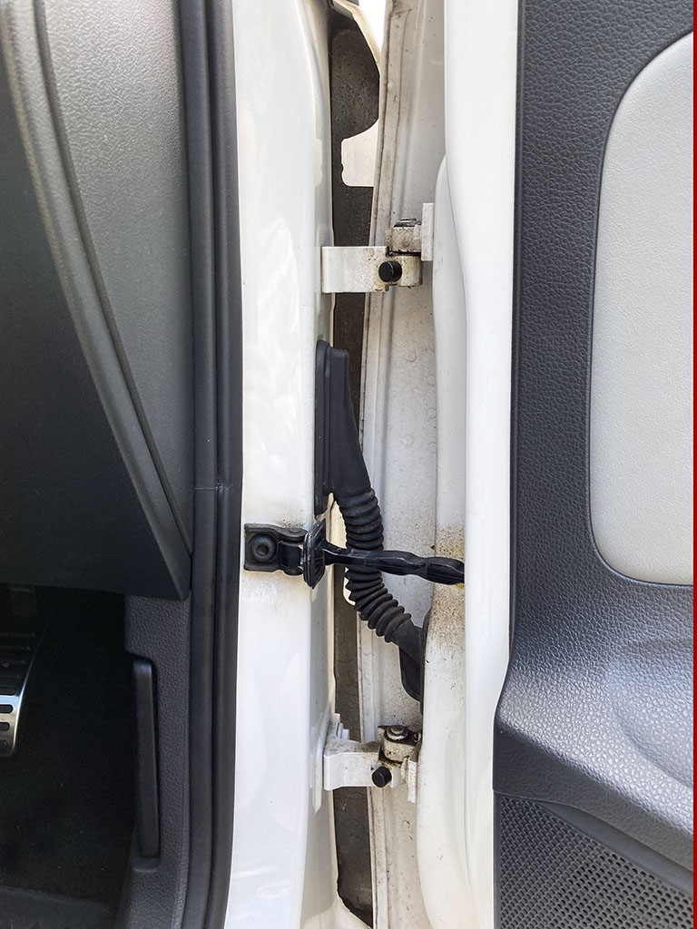

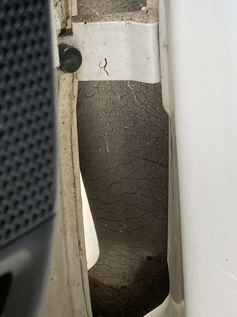

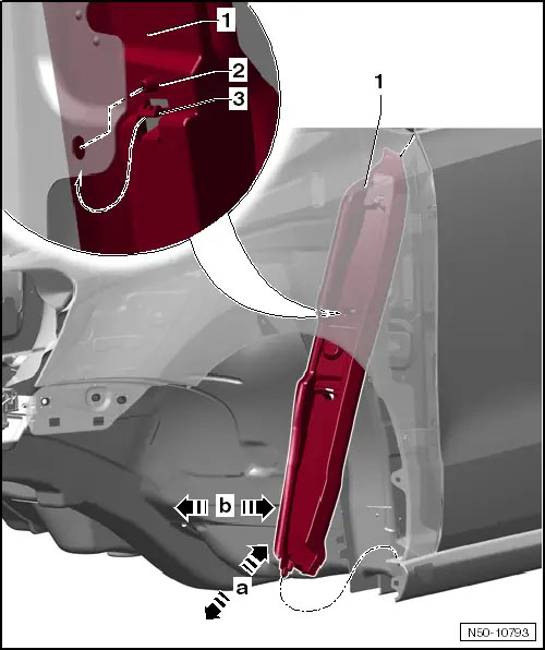

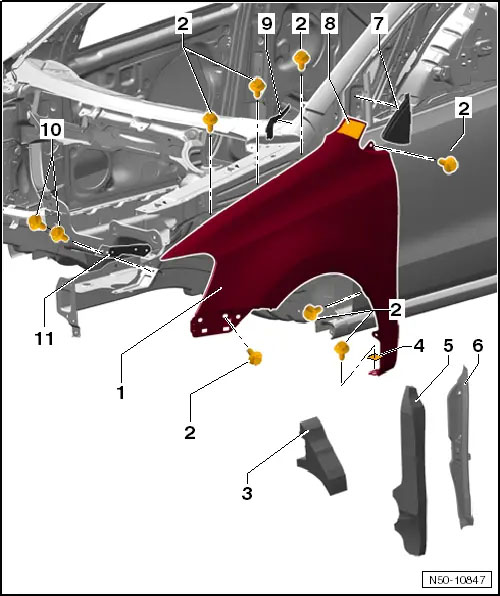

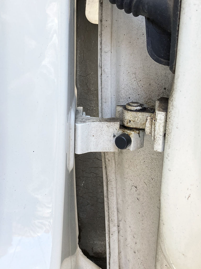

So, just noticed my 6R BlueGT (2014) has foam – trying to ascertain if this is correct and to whether or not it has had some work (I have owned it 18 months!). Although the passenger side wing only seems to have foam halfway up it.Mk6 Golf; VW used a foam filler strip between the rear edge of the front wing and the lower half of the A pillar (where the front door hinges are). This was apparently to stop ice build up where the bottom of the wing joins the sill in some overseas markets where they experience sub-zero temperatures over a prolonged period. This strip wasn't fitted to the mk5 Golf, and ice build up in this area on the mk5 could cause the bottom front corner of the front doors to bend if they were opened against any ice build up. The 6c Polo (and presumably the 6r too) doesn't have a foam filler strip in this location. If you open the front doors, you'll see a black plastic strip running from top to bottom of the wing near the door hinges.
According to various online parts catalogues, there should be no foam and just a plastic ‘closing element’. (Part number 6 on the image with the wing in it and 1 in the figure inside the wing). Is number 5 the foam?) I really don’t know what it’s supposed to have and am now obsessively curious.

My 2016 6c Polo GTI had a plastic ‘closing element’ between the rear edge of the front wing and the lower half of the A pillar. I suppose it’s possible that VW switched from using foam to plastic for that part at some point during the life of the 6r/6c Polo; on the mk7 / mk7.5 Golf, these were made of foam on earlier model year cars but switched to plastic on later model year cars, so foam could be correct on your car.polodriver wrote: Wed May 10, 2023 3:34 pmSo, just noticed my 6R BlueGT (2014) has foam – trying to ascertain if this is correct and to whether or not it has had some work (I have owned it 18 months!). Although the passenger side wing only seems to have foam halfway up it.Mk6 Golf; VW used a foam filler strip between the rear edge of the front wing and the lower half of the A pillar (where the front door hinges are). This was apparently to stop ice build up where the bottom of the wing joins the sill in some overseas markets where they experience sub-zero temperatures over a prolonged period. This strip wasn't fitted to the mk5 Golf, and ice build up in this area on the mk5 could cause the bottom front corner of the front doors to bend if they were opened against any ice build up. The 6c Polo (and presumably the 6r too) doesn't have a foam filler strip in this location. If you open the front doors, you'll see a black plastic strip running from top to bottom of the wing near the door hinges.
Hopefully there’ll be forum members with 2014 and earlier 6r / 6c Polos who can check to see whether their cars have foam or plastic (closing element) strips and add to this discussion thread.
