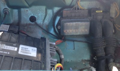

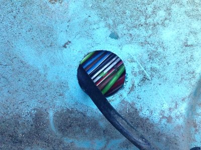

I can only see two areas of entry on the passenger side of the car, and I've tried the one nearest the middle and when I've removed the grommet to see inside the dash, there's just an abundance of wires that seem to be blocking any way in.If I was to take pictures would that help show what I mean?

Re: Sub power cable through firewall
Post by TheRealRyno »
Is the black wire closest to the fuse box the one you were referring to?
TheRealRyno
Posts: 15
Joined: Sat Apr 28, 2018 8:13 pm
Drives: Mk2 Polo F
Location: Alton
If so this is what I was talking about earlier.
