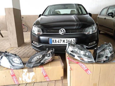

Selection process

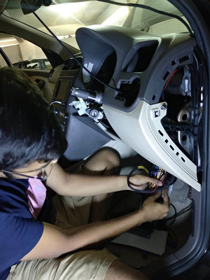

only picture of installation Nikhil in image
