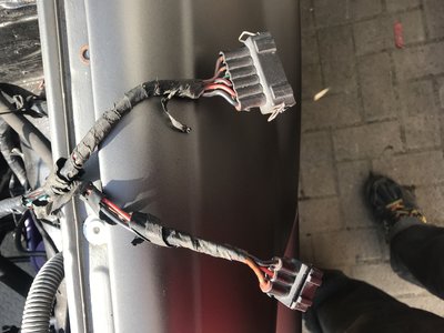

Hi all I have a 1992 Mk2f polo that I am doing a engine conversion from a 1.0 spi to a 1.3 mpi.i have the complete loom and Ecu for engine. I have connected all the wiring loom except one 6 pin plug and one two pin plug from distributor. The Haynes manual says it goes to the Ecu but I can’t find anywhere for it to go. Does anybody know what I should do.
Cheers

Sorry one 6 pin plug and one 3 pin plug

Those are pretty thick wires so itll be a high current job whatever they are doing. Where on the loom are they, and where do they branch out from?
