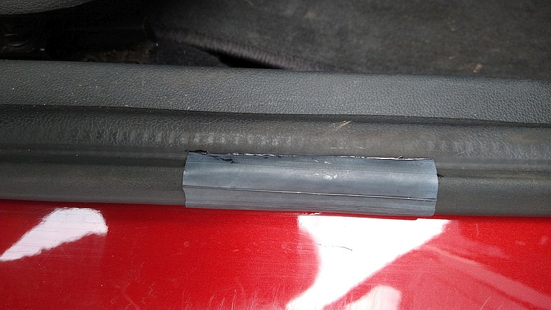

I wasn't going to pay for replacements, but did a home repair using the inner tube from a cycle tyre. Cut to length, split along a seam, superglue in place. Not especially pretty, but you can't see it from inside the car, and it does the job.
Door seal.jpg (123.02 KiB) Viewed 4317 times
