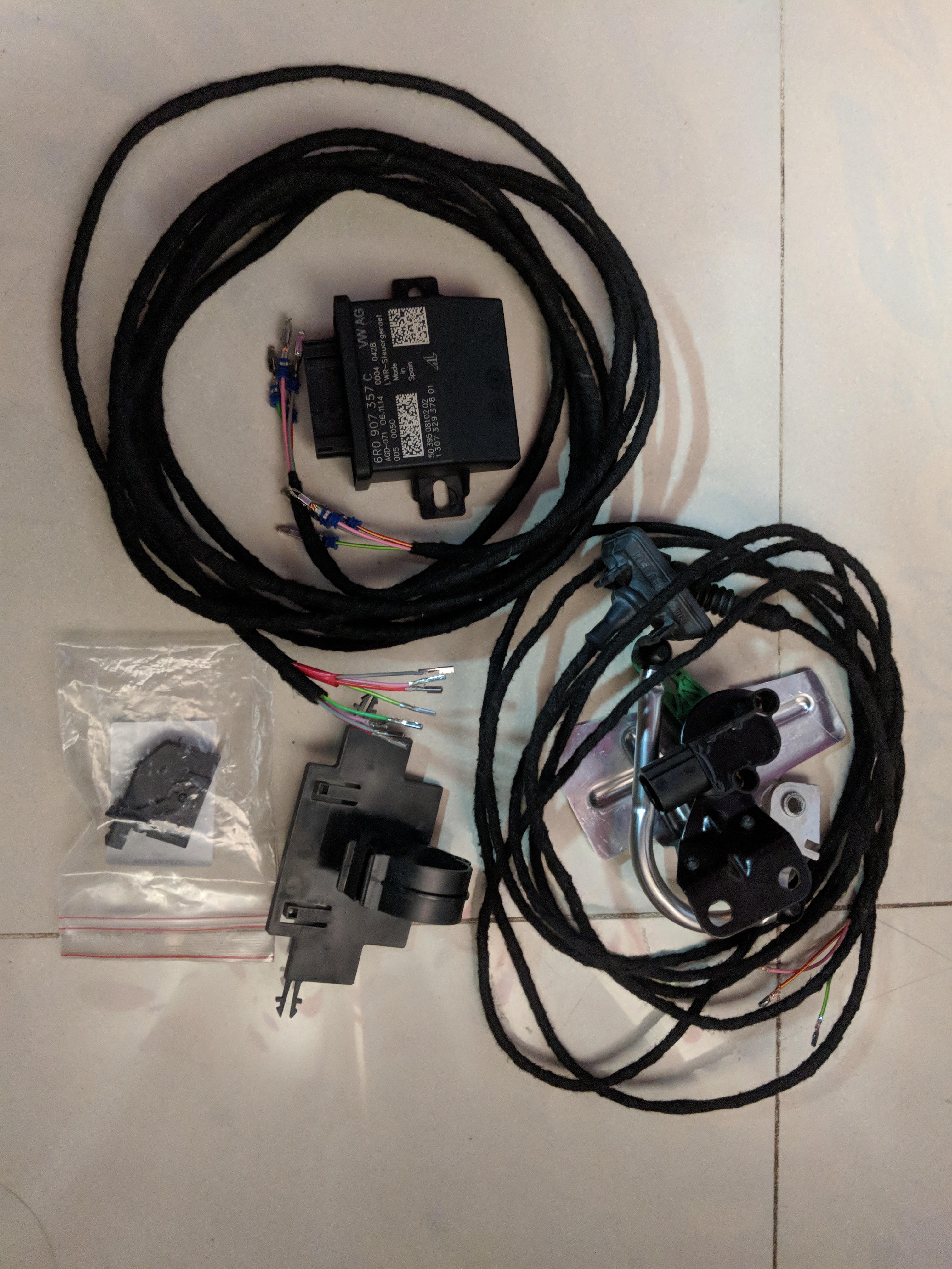

RLS ,CH/LH , Auto lights , Rain sensing wiper & Auto dimming Rear view mirror on Vento
- Posts: 6420
Re: RLS ,CH/LH , Auto lights , Rain sensing wiper & Auto dimming Rear view mirror on Vento
That is indeed the correct one, a Junior Power Timer for SB10.

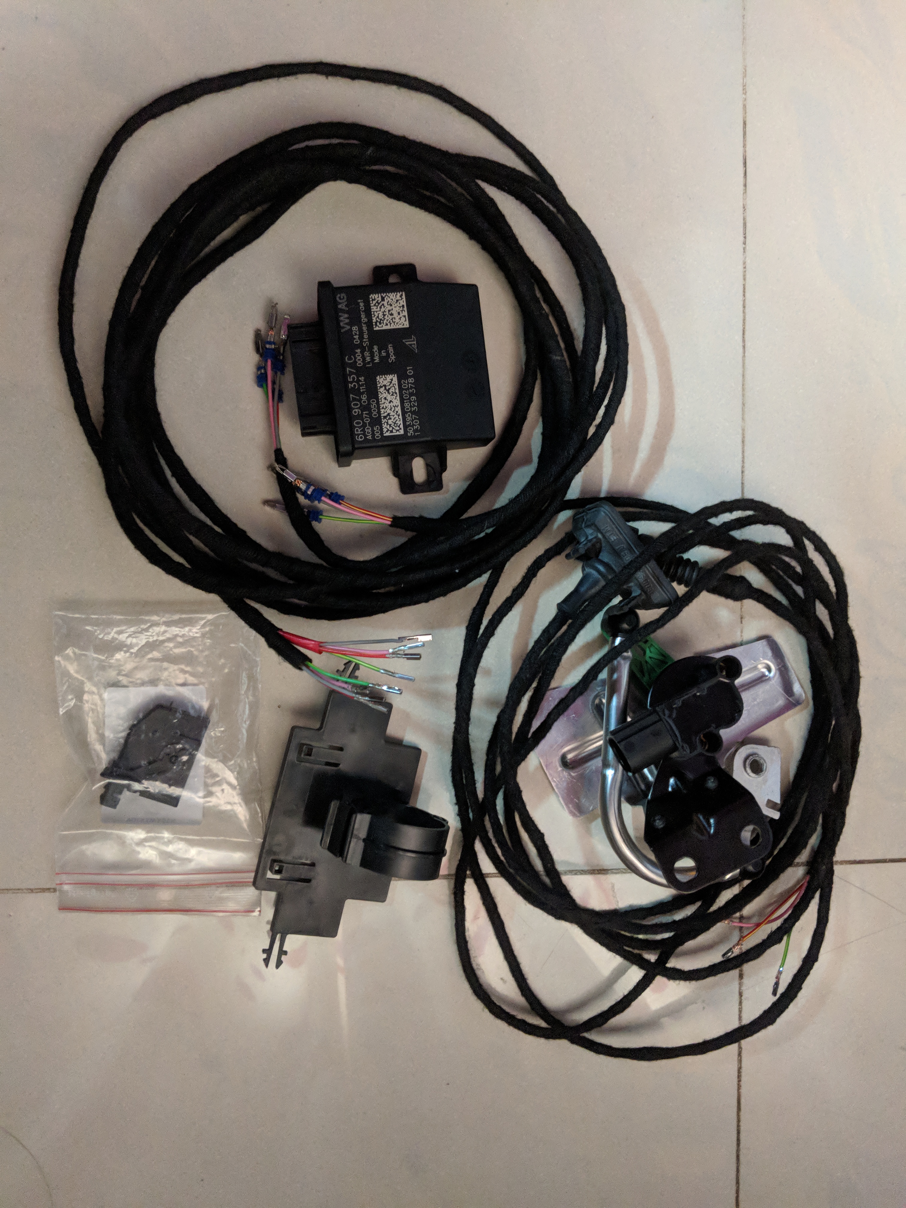

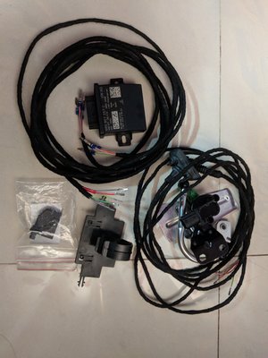

AFS Kit ready
Waiting for level sensor bracket
Thanks a lot Firegraphics for your guidance
Thanks a lot ciclo for parametizing AFS module without this project was incomplete
Thanks a lot Madwarlock for AFS Module
