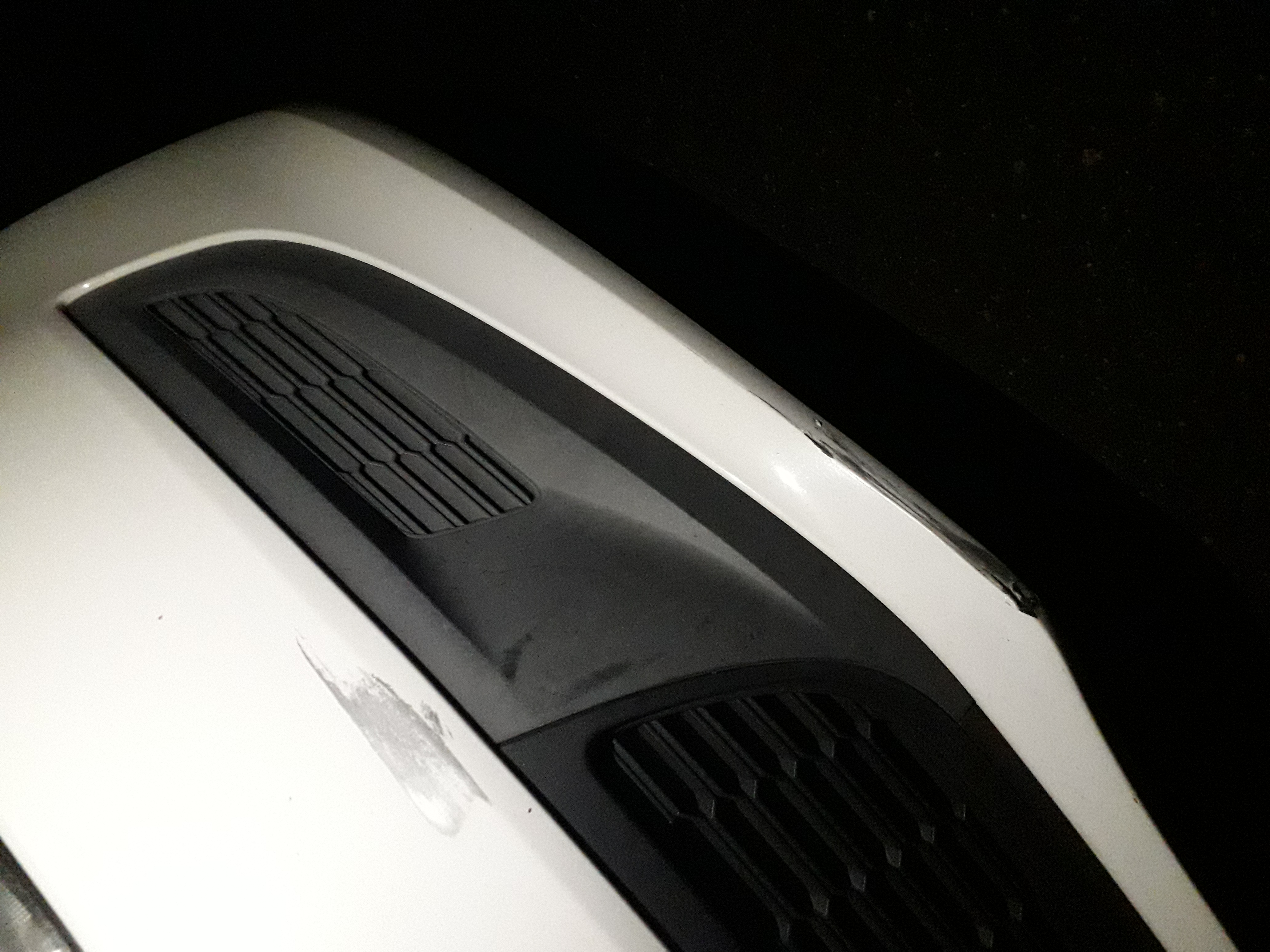

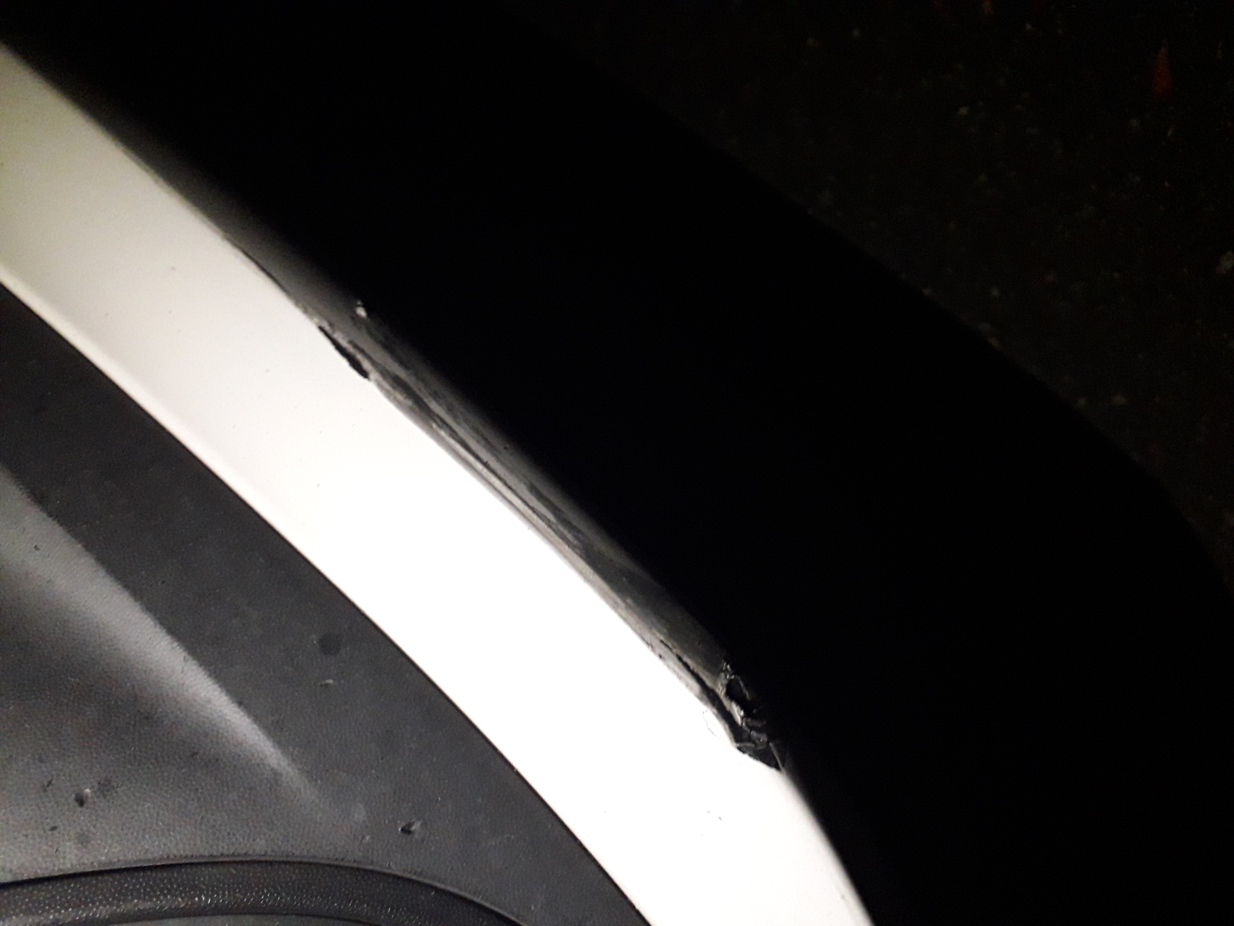

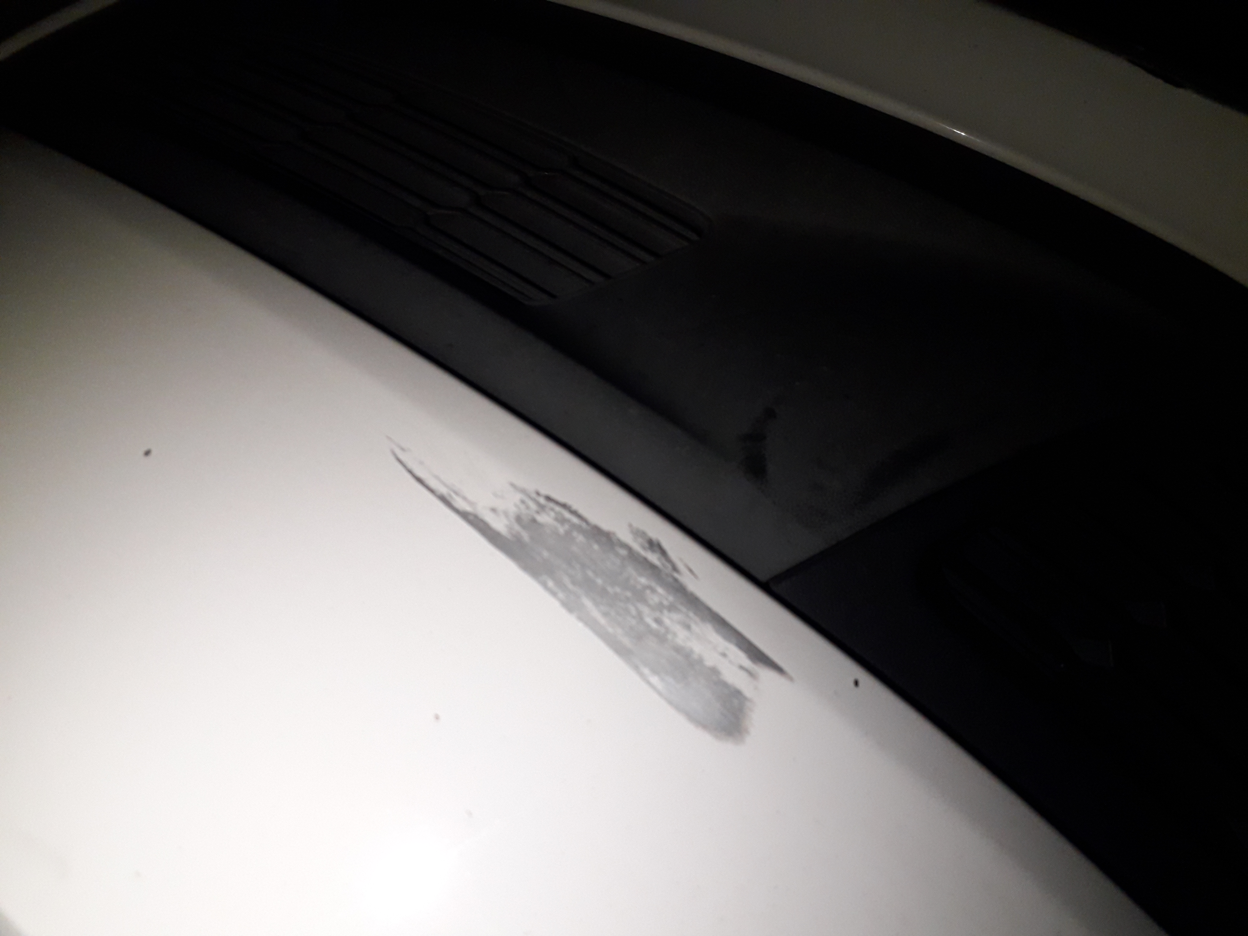

Hi could anyone advise me on how I can get this fixed and how much it will cost thanks. (Bumper)

If it is back to the black plastic on the bumper then it will require a clear primer coat for plastic over the damaged area and then paint primer, colour coat and then clear lacquer. If you don't feel confident to DIY, then get quotes from a couple of paint shops and or mobile paint companies but make sure they itemise what they are going to do. I would not recommend mobile ones at this time of year as there is a minimum temperature required for paint to spray and cure properly otherwise you get a 'bloom' on the finish. There are two options - blend in the affected area or full bumper respray. Depends on whether the paint has faded badly. White is usually OK. Not up with likely costs unfortunately as tend to do small jobs like this myself.
