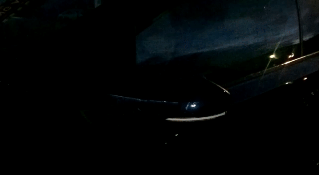

ok, I have more info, new reply from JOGON Tuning Store (https://www.aliexpress.com/store/1082272):
I am not sure. Our factory doesn't test it for POLO 6R, Because Chinese version Polo 6R doesn't have turn signal light.
I am not sure if the car computer system and code are different. Our one buyer send me a gif. to show the problem, his car is polo 6R.
they can install it, But it doesn't work properly.
so i think there it's something like LED without CANBUS (Polo 6C has different BCM)
Here is Polo 6R from Netherlands:
