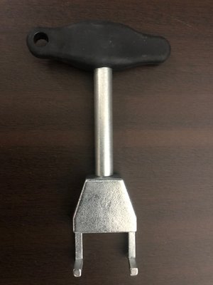

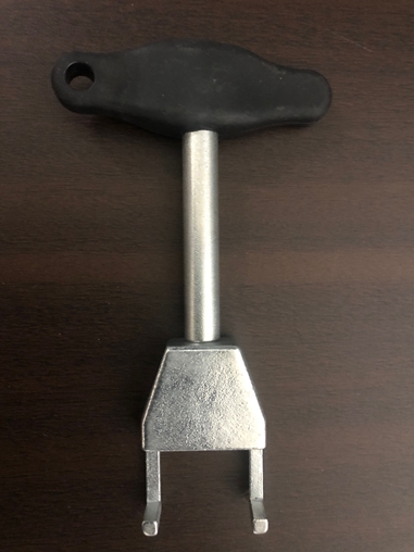

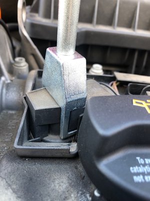

I want to remove my spark plugs to do a visual inspection and see if they need replacement. I don't have the service history of my car so I'm afraid my plugs are due for replacement. Pulling them with my bare hands don't work so I bought an ignition coil puller (T10094A).
I thought I could easily get them out but they are still very difficult to remove. I tried hammering up the puller handle but I stopped because it doesn't seem to be a good idea. I tried twisting left and right. It moves a little from side to side but not upwards. I can't pry it up with a flat screwdriver because of the plastic wiring guide around the ignition coils.
I'm thinking of devising a screw type puller that can sit on the camshaft housing. If anyone has any tips on removing an ignition coil, please let me know. Thank you.

Thank you for tip. I tried it but the screwdrivers have nothing to pry against except the plastic wiring guide.
I will make something that can sit on the camshaft housing and attach the coil puller. Will share it here later.

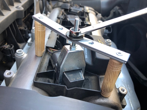

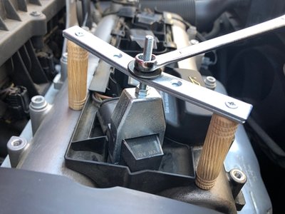

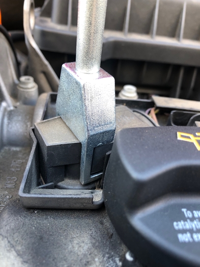

I have finally removed the ignition coils by making this little hoist using metal bars and wood.
It sits on the camshaft housing and pulls the puller up as you tighten the nut. Works well.
- Posts: 6069
Re: Can't Pull Ignition Coils - SOLVED
That certainly should have solved your problem!
Now to re-engineer that coil puller back to having a Tee handle as I don't think that you will ever need that much effort to remove these coils in the future.
I'm guessing that it was only the rubber seal that was gripping so well and stopping you lifting these coils out?
Plugs come out okay?

Hi RUM4MO,
Putting the tee handle back to the puller/fork is easy. I actually attached it back as I used it to firmly press the ignition coil back.

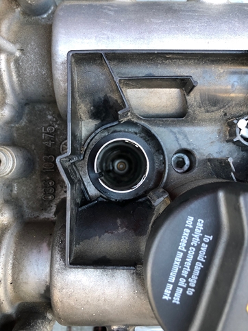

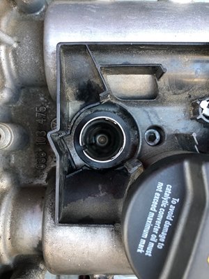

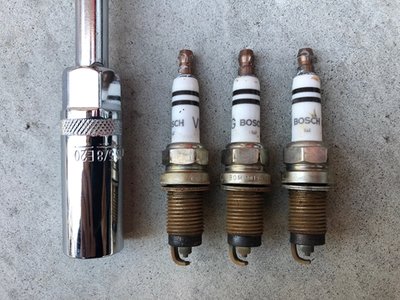

Ignition coils 2, 3 and 4 came out without issues but I had an issue with coil 1.
The metal part of the coil did not come out. It got stuck in the hole so the coil came out without it. Coil 1 still works when I reinserted it but my plan is to replace it after I receive the replacement coil I ordered. I will forcefully pull out that metal part with pliers.

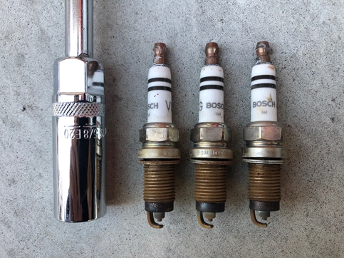

I could only get 3 spark plugs. The spark plug wrench won't fit when the metal thing is there. Plugs are rusty so I think they have never been replaced since the car was bought in 2008.
I will replace all the spark plugs.
- Posts: 6069
Oh, that is a bit annoying, it must be the sealing ribs of the rubber gasket that is gripping the sides of the counterbore in the aluminium alloy cylinder head - and the metal shield will just be gripping the inner bore of that rubber gasket.
I'd not think that that happens very often, in fact I've never ever read about that happening on any VW Group similar engines - replacing the plugs at the 4 or 6 year point in its life would probably have avoided that, also to make things worse, any engine oil spilt during servicing/maintaining would end up on top of that rubber gasket adding to its troubles.

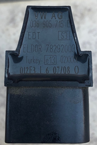

Yes, I was kind of sad that one of the ignition coils broke but that's ok. I ordered an original VW ignition coil (036 905 715 E) but it's not new. I think it's better to have 4 originals than to have 3 VW and 1 aftermarket brand.
I agree with you that it was the rubber gasket. The metal shield from the coil and metal from the spark plug well shouldn't be gripping that tight.

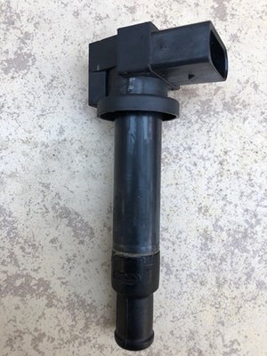

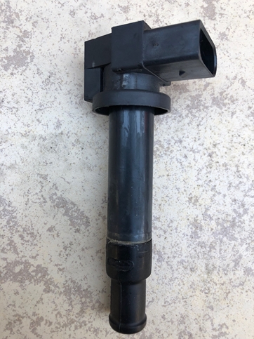

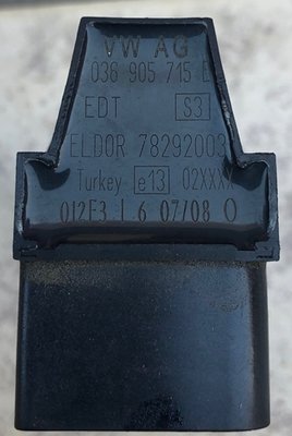

I am doing the second option you mentioned which is to buy a still-okey Eldor coil.
I am getting one that was taken from a 2007 Golf with 80K on its odometer. My Polo already has 99K.
Here's a photo of the Eldor coil taken from my 9N3.
