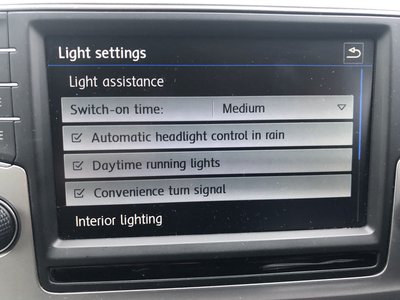

to enable the drl menu that enables or disables the drl lights the following needs to be enabled:
Control unit: 09 Central Electrics:
Security Code (31347):
Adaptions:
Daytime running lights:
Tagfahrlicht Aktivierung durch BAP oder Bedienfolge moeglich: active
I disable the option and my drl lights turn off even with hndbrake down.
In car settings/light menu you well get this as seen on my polo:
