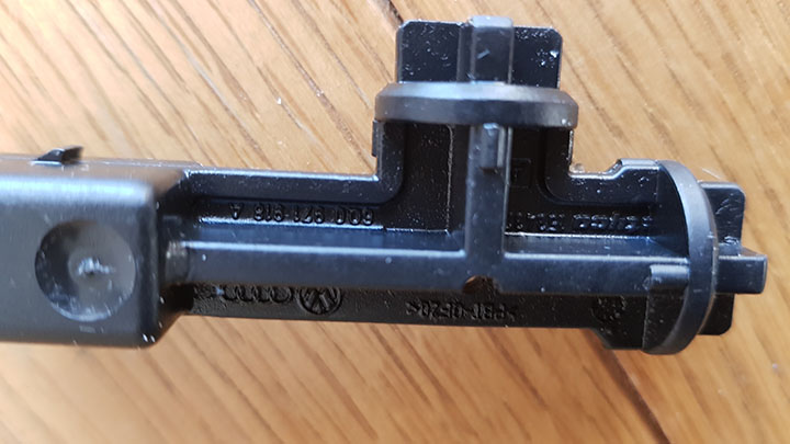

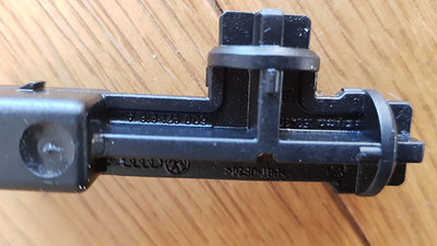

Hi there guys, my wife has a 2007 vw polo dune 9n3, the power steering light is intermittently coming on after about a mile, yet it resets when I turn off the ignition. I've checked the fluid & it's fine, I've inspected the connections on the pump & they look good. I've been trying to find the angle sensor on the steering box but I'm unable to find it. I did find a plastic plug looking thing that clicks into the box it is about 4"long an it is circular at both ends with a cros on each end. The plug connection end of it is just a blank hole, no wires within the connection part of this black plug. it says Tyco 1534371 on it with an audi logo on it too. Any help appreciated.

Edit:- that plastic part, it could be that that is just a blanking piece to seal off what used to be the angle sensor, and that that car has foglights that are being used as additional lighting when turning corners slowly - and if so, the new steering sensor will be built into the clockspring assembly under the steering wheel - that is just a guess offered to clear up any confusion as to where the steering angle sensor is located and probably has nothing to do with this problem.
