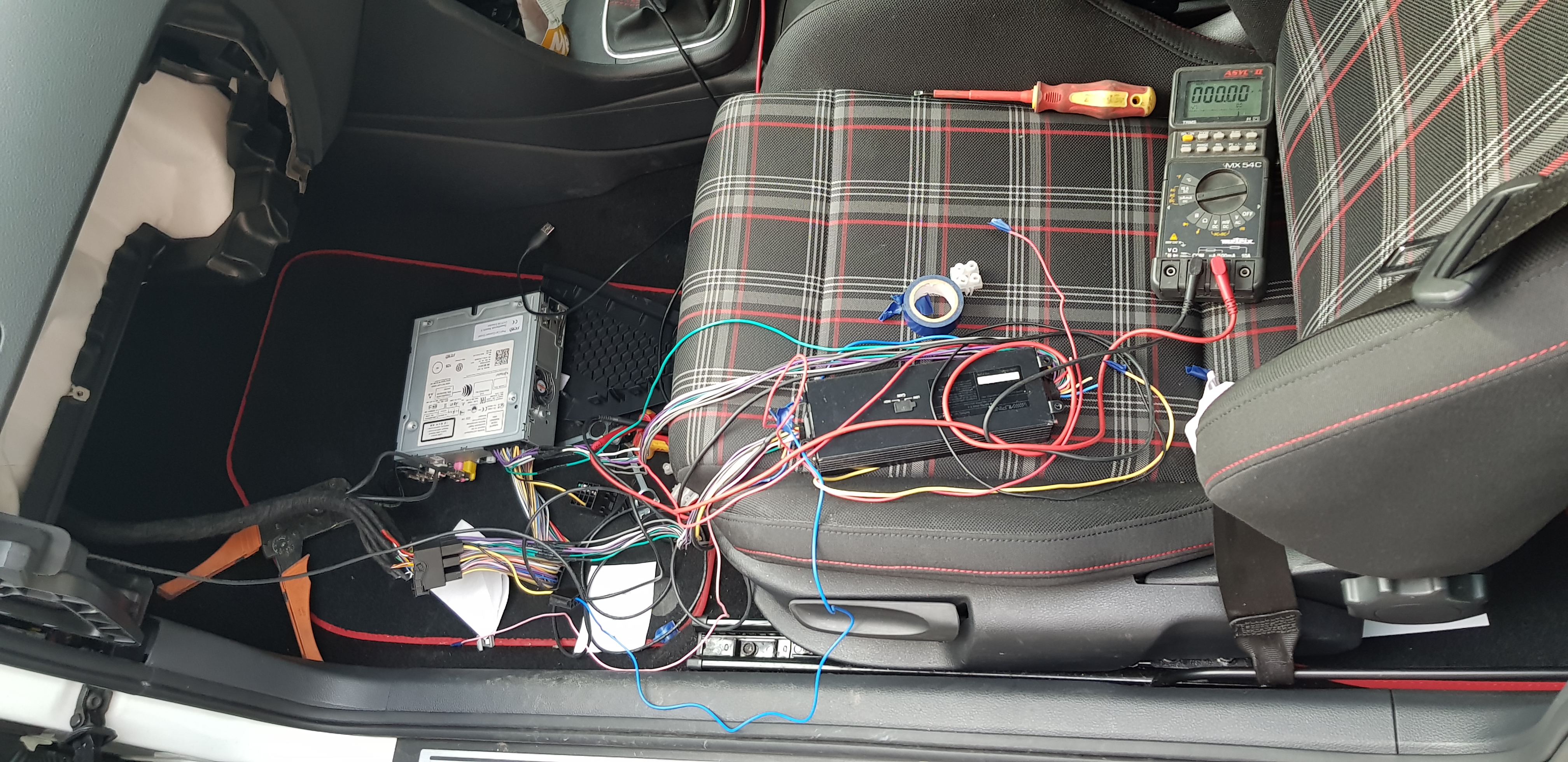

Re: Speaker Upgrades
I'm pretty sure they are a direct fit as the tweeters look quite slim front to back and are shaped to match the oem ones.
I was looking at the rainbow il-c6.2 to replace the fronts with the amp wired in driving them (the amp is 4x45w)
Then I might of changed the rears to some co-ax speakers with an adjustable tweeter volume so could knock it back a bit as to not confuse the sound stage.
I think just fitting some mid-bass speakers to the front doors with oem tweeters would be better than fitting co-ax speakers.
