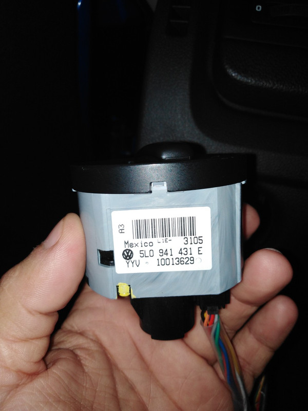

Auto light switch (Yeti)
5L0 941 431 E

Thank you very much for the images, everything under control.
