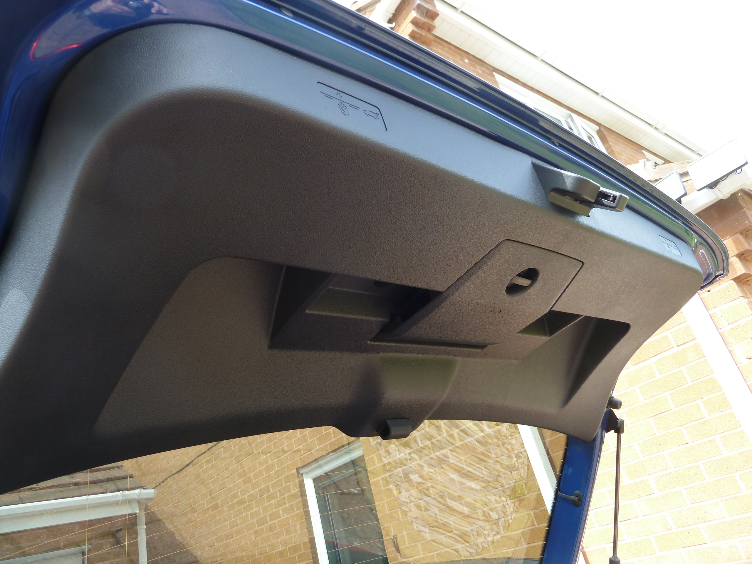

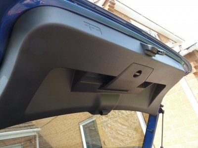

Does anyone know how to remove the big black internal hatchback panel? Thanks.

Remove the two screws, 1 in each pull area.
Use a trim tool to go around the edge prying the trim loose.

Thanks chaps. Where are the other 2 screws? Also, does the plastic trim around the boot lock need removing, or does the panel come without having to touch that (or is it part of the main panel)? Thanks.

I have a photo from my dashcam fitting with the tailgate trim off. I'll upload later, but basically you have 4 screws - 2 in the bar shape cavity meant for a warning triangle and 1 each in the dark reaches of the grab handle cavity.

Thanks, just taken the panel off, much easier than I thought it would be.

Theres a lot of spring pins to line up when you put it back on. I like to put a spot of masking tape on the reverse side of where they are, so you know where to give a sharp whack with the palm of your hand when refitting.

It took me ages to figure out there where 4 (T20 torx) screws holding it up where, the 1st 2 where easy to find, but after pulling and huffing, I decided there must be some more.
