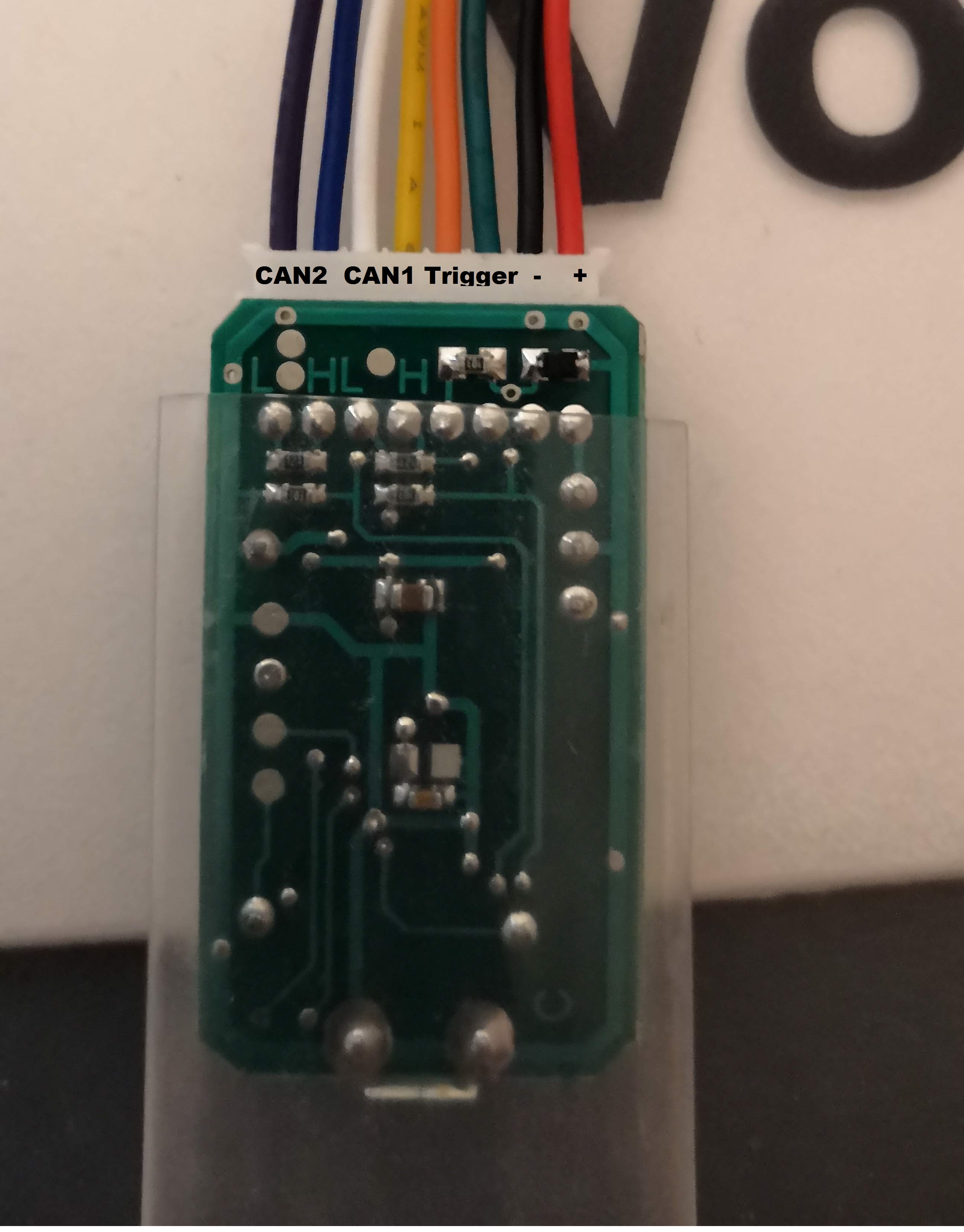

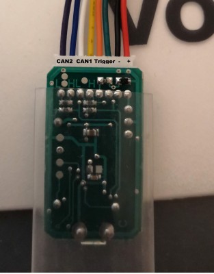

The device is CAN filter, but in that case it works in emulation mode

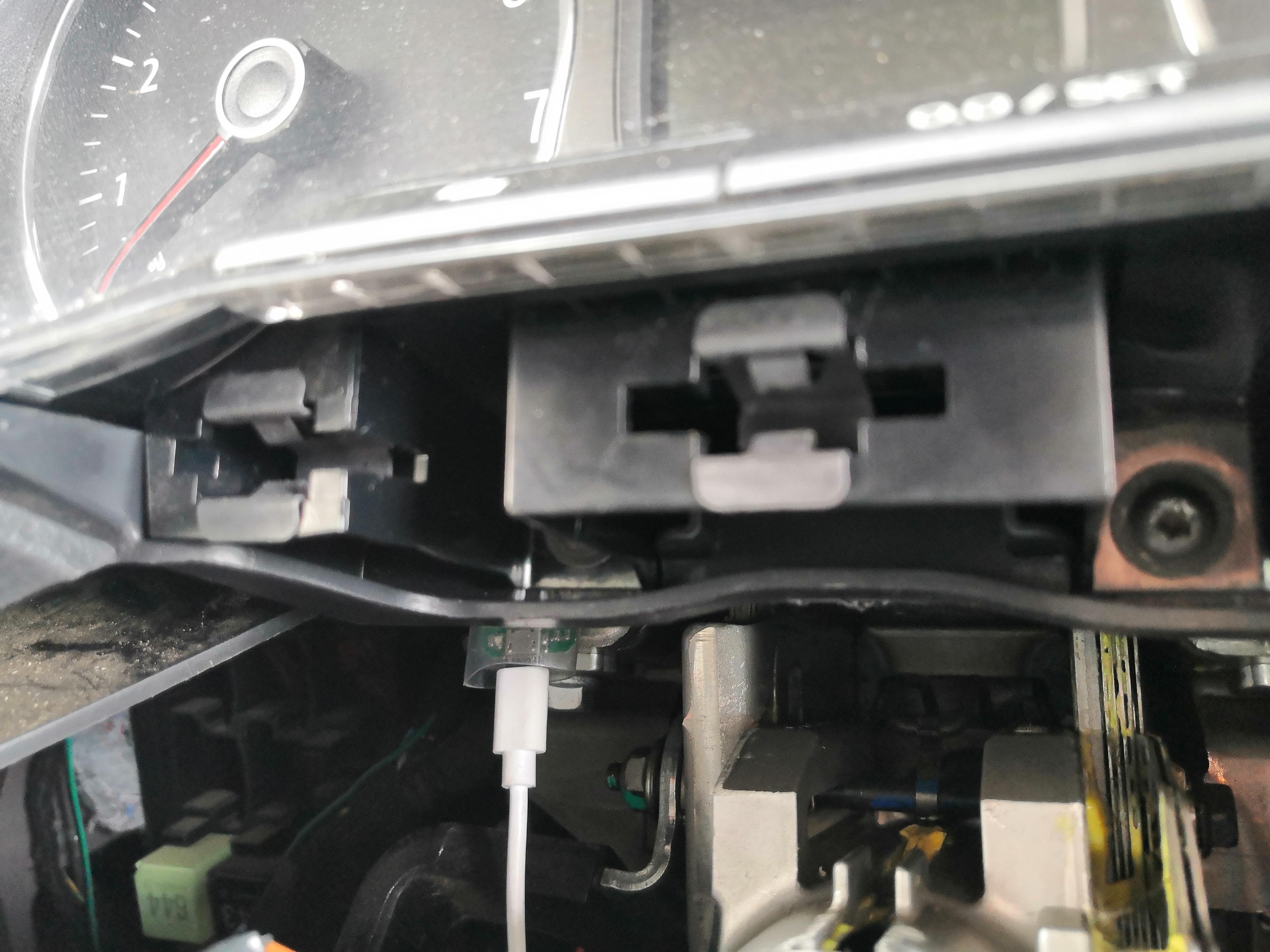

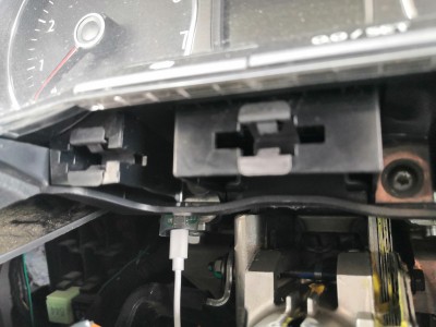

The CAN filter has an microUSB socket for loading the logic by the PC. After connecting to the cluster CAN wires and power wires (15 terminal and ground) it looked like on the photo. USB wire used often while testings.
