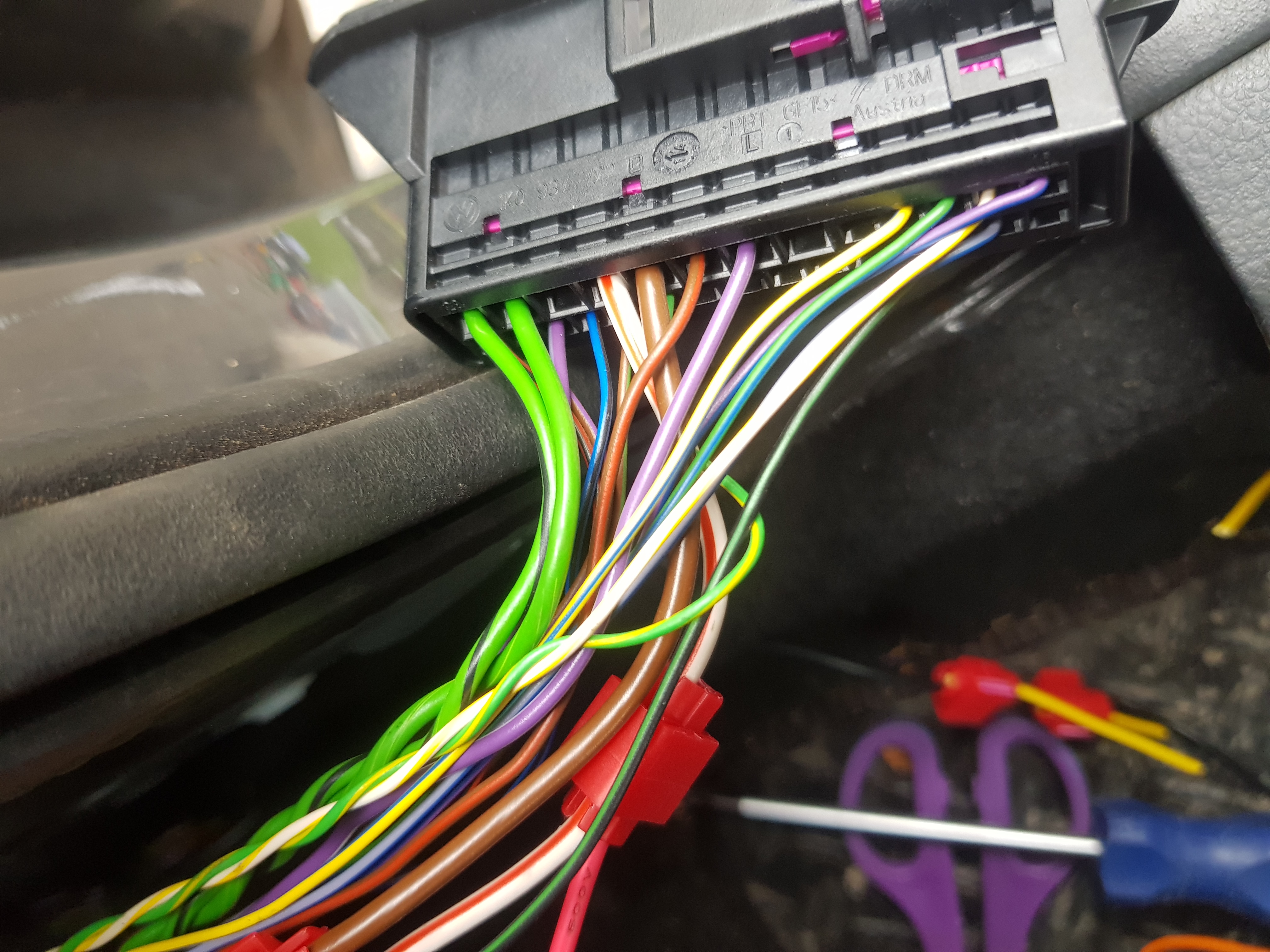

So I finally had some time today to try and install the remote onto the central locking system in my basic model 2014 6C and after I wrestled with the boot release lid mechanism and driver's side footwell panels I managed to locate what I thought were the correct locking wires going by the description of the 6r.
Instead of yellow/red there was a thick white and red cable and a thick brown cable coming from the door loom, however once I spliced them and connected them to my aftermarket remote unit the device did not make an audible tick like when I tested on a 12v dc power supply out of the car. I removed the inner door panel and discovered that these wires actually go to the what looks like the window motor.
When I put the keys in and tried to test the device I got an airbag warning light and airbag warning message on the dash, however as far as I know I have not touched anything to do with the airbags, hopefully nothing is damaged and I can reset the error with vcds.
I followed another set of wires to what looked like the other side of the door release handle and locking mechanism plug but I am unfamiliar with the colours so I gave up for today.

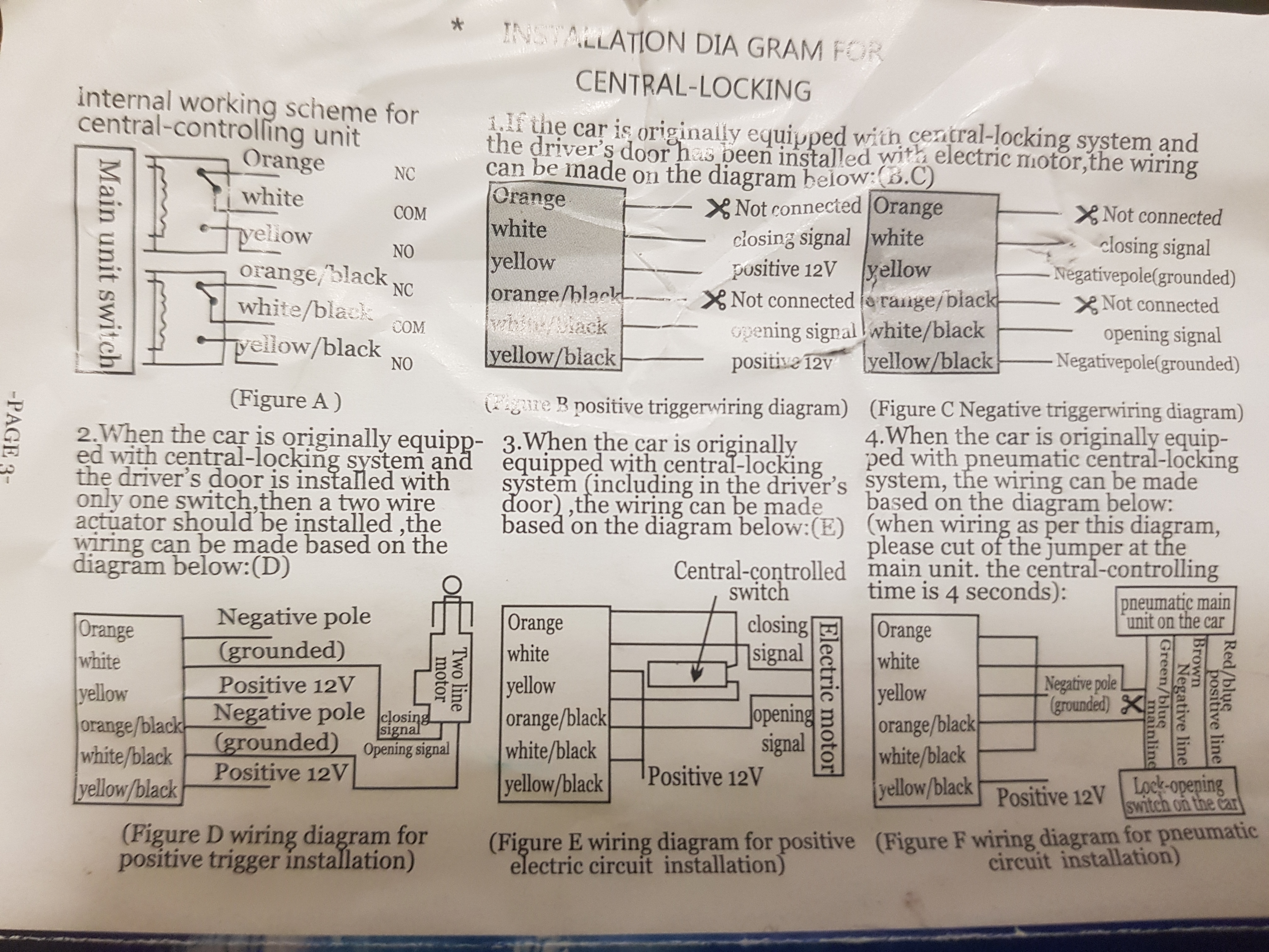

I'm not sure that I wired the locking remote box correctly if anyone can confirm I would be very grateful, I followed the poor instructions figure C along with a 180ohm resistor.

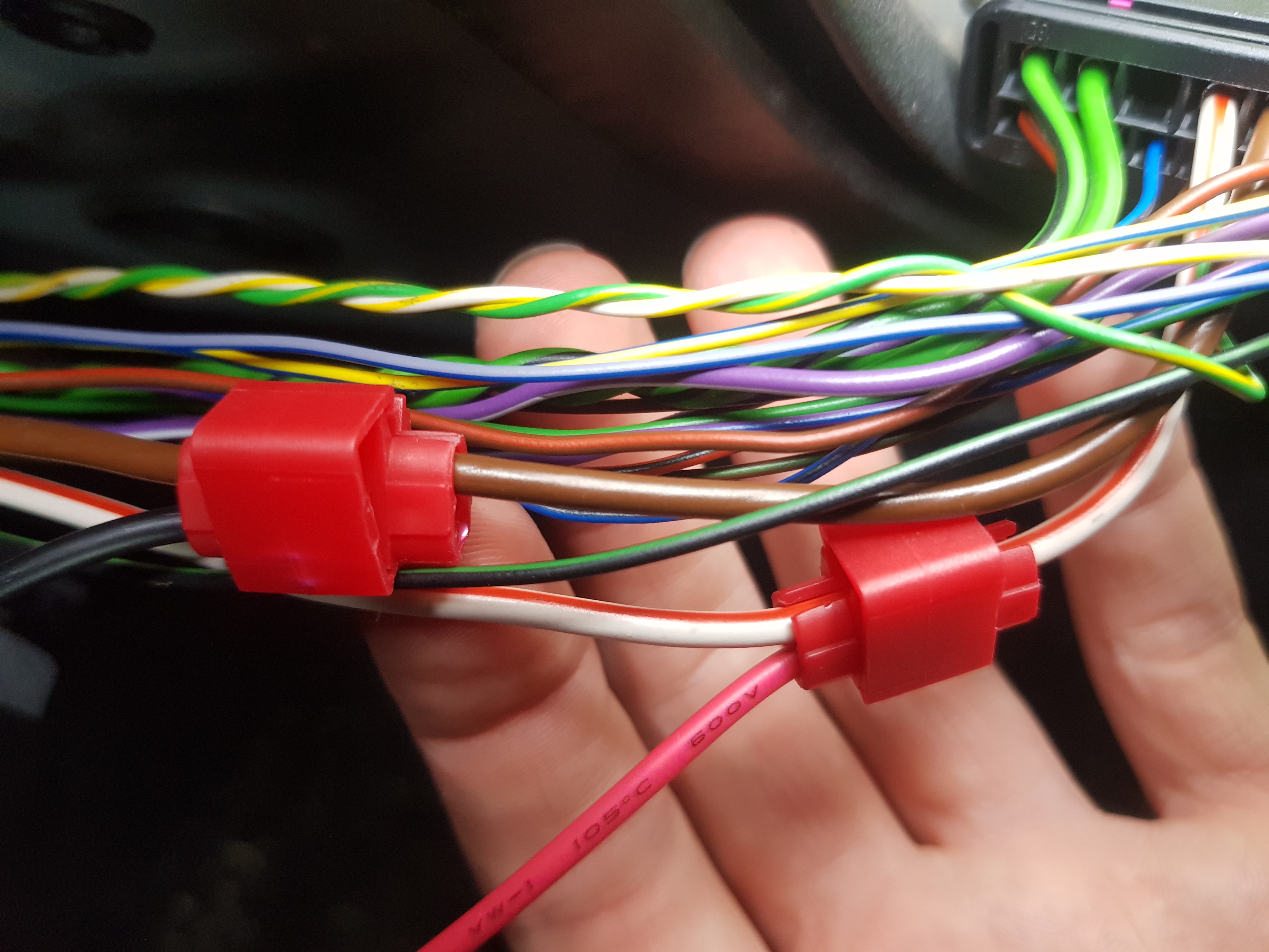

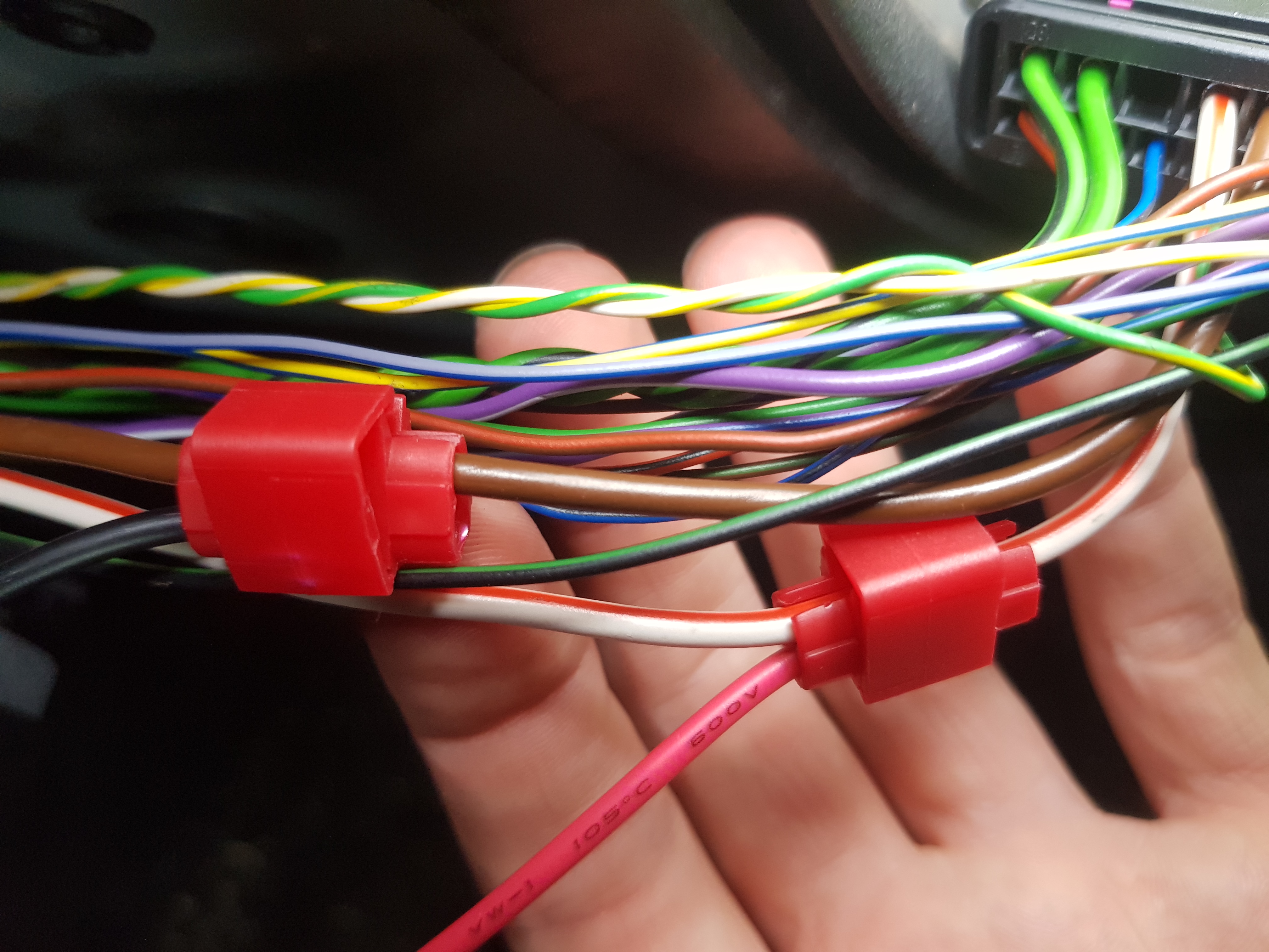

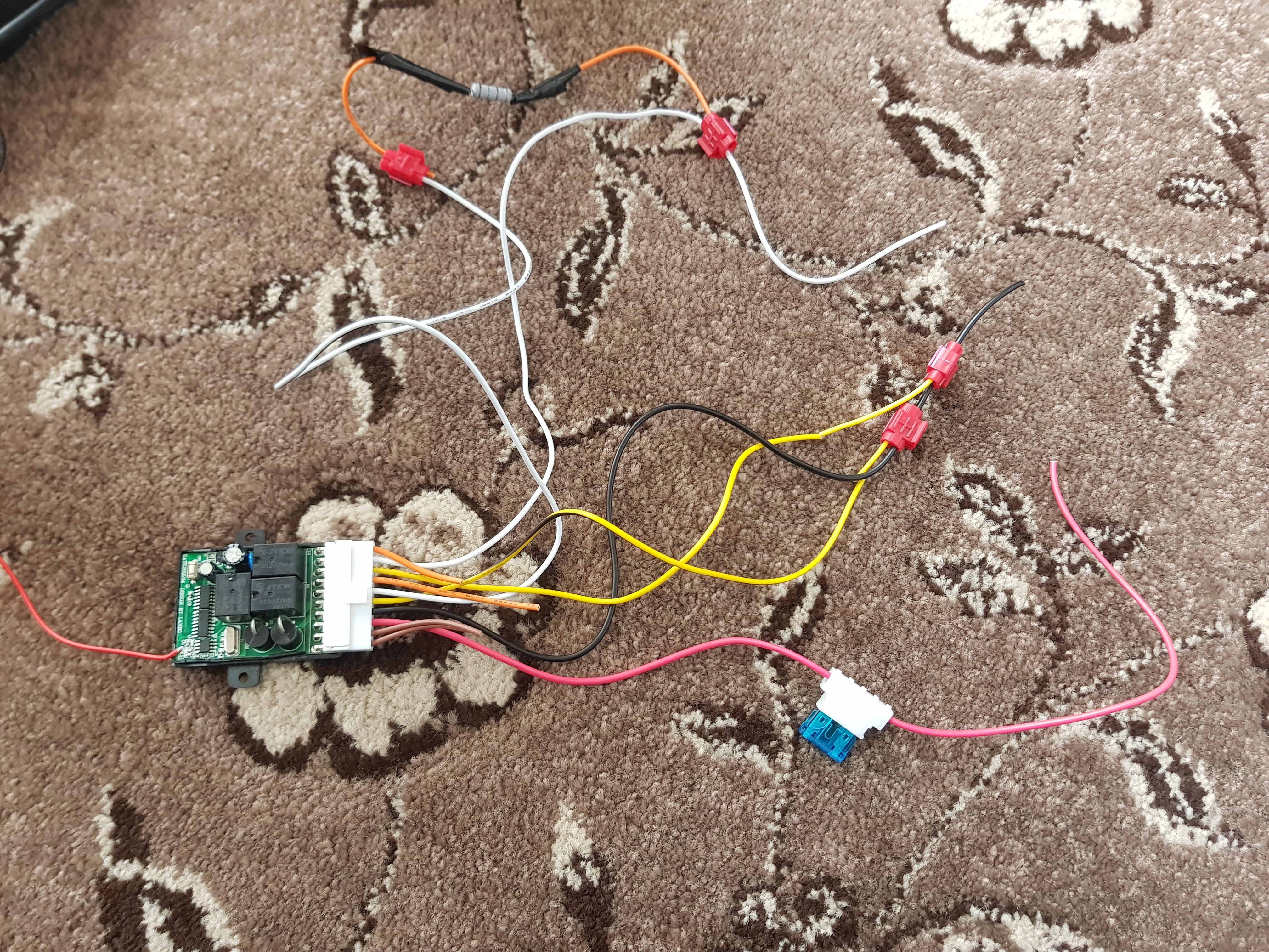

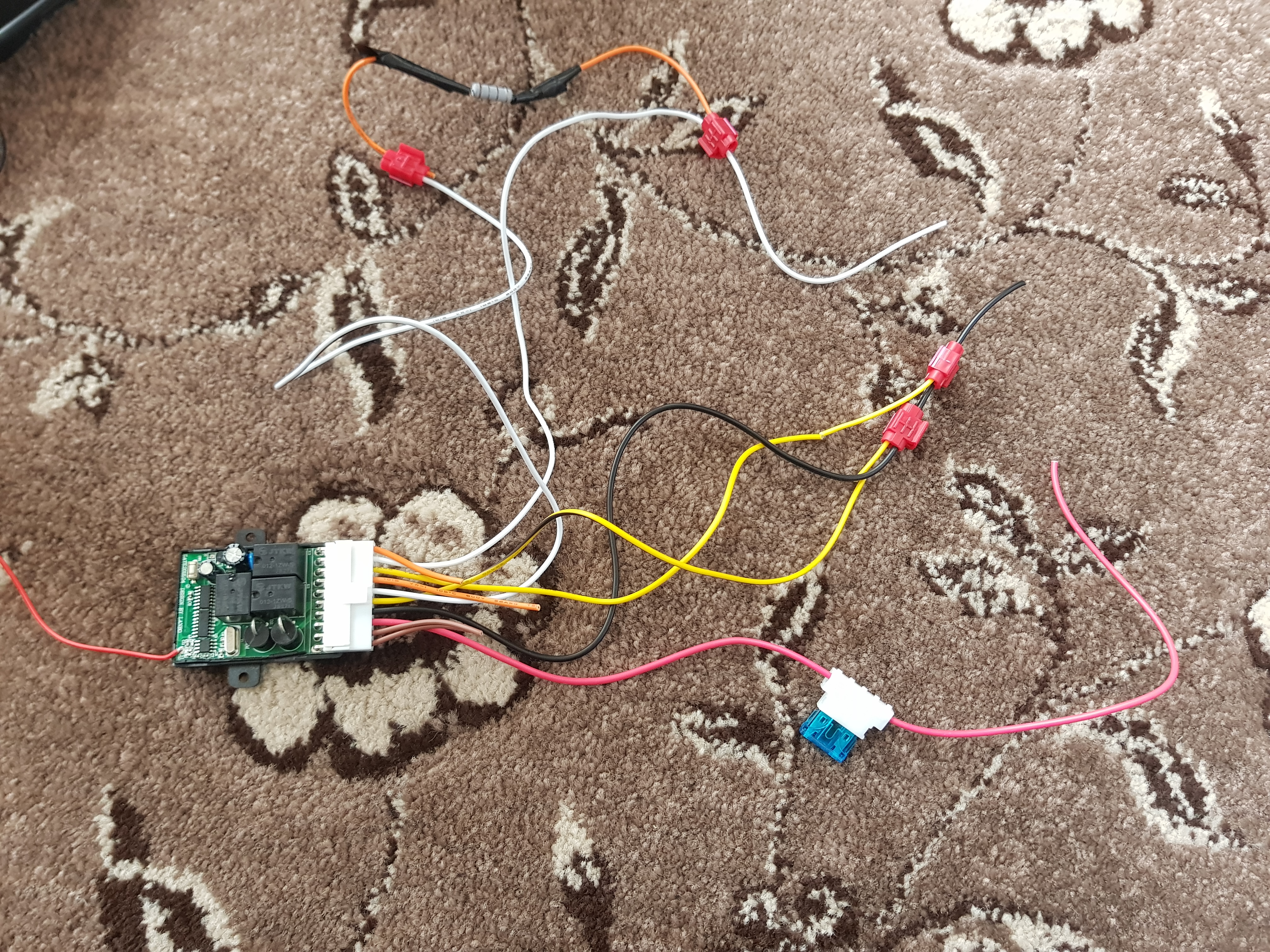

Re: Installing Remote Locking

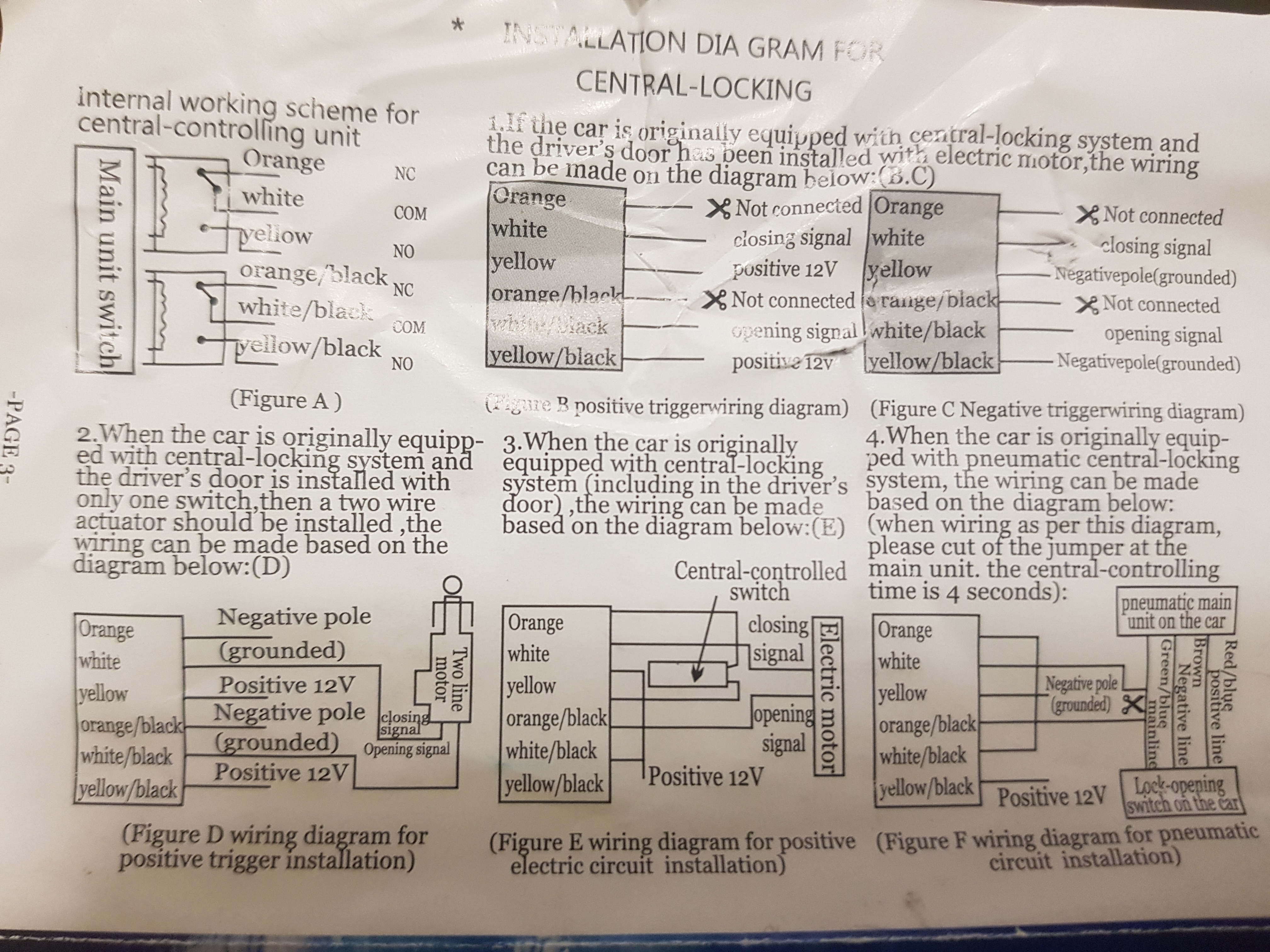

Hi guys. Sorry to hijack the thread but my gf bought a 2014 polo without remote locking and the guy she bought it off have her a kit to make it remote. The instructions arent great was wonderful Ng if anyone could help with the wiring please.
- IMG-20210506-WA0014.jpg (150.32 KiB) Viewed 9006 times
- IMG-20210506-WA0015.jpg (191.34 KiB) Viewed 9006 times

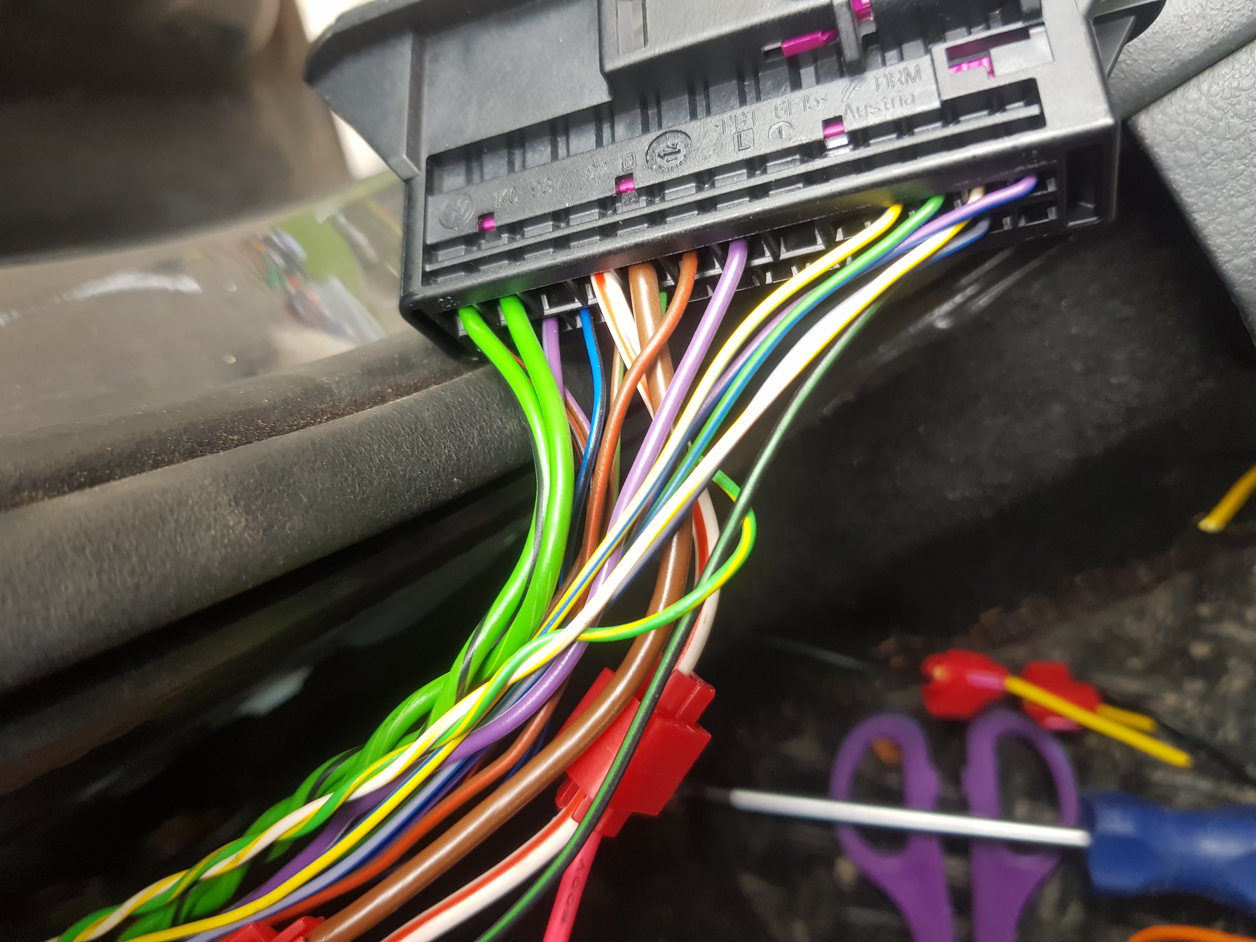

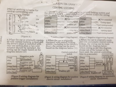

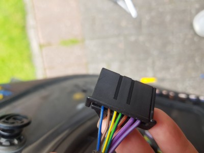

giannis20vt
- Posts: 425
- Location: Greece

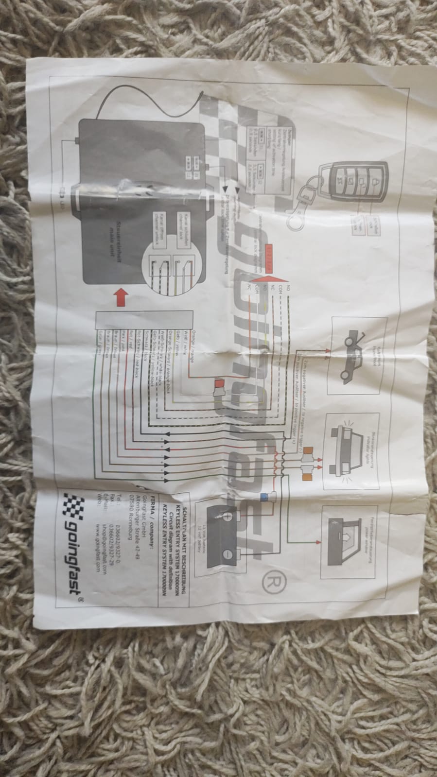

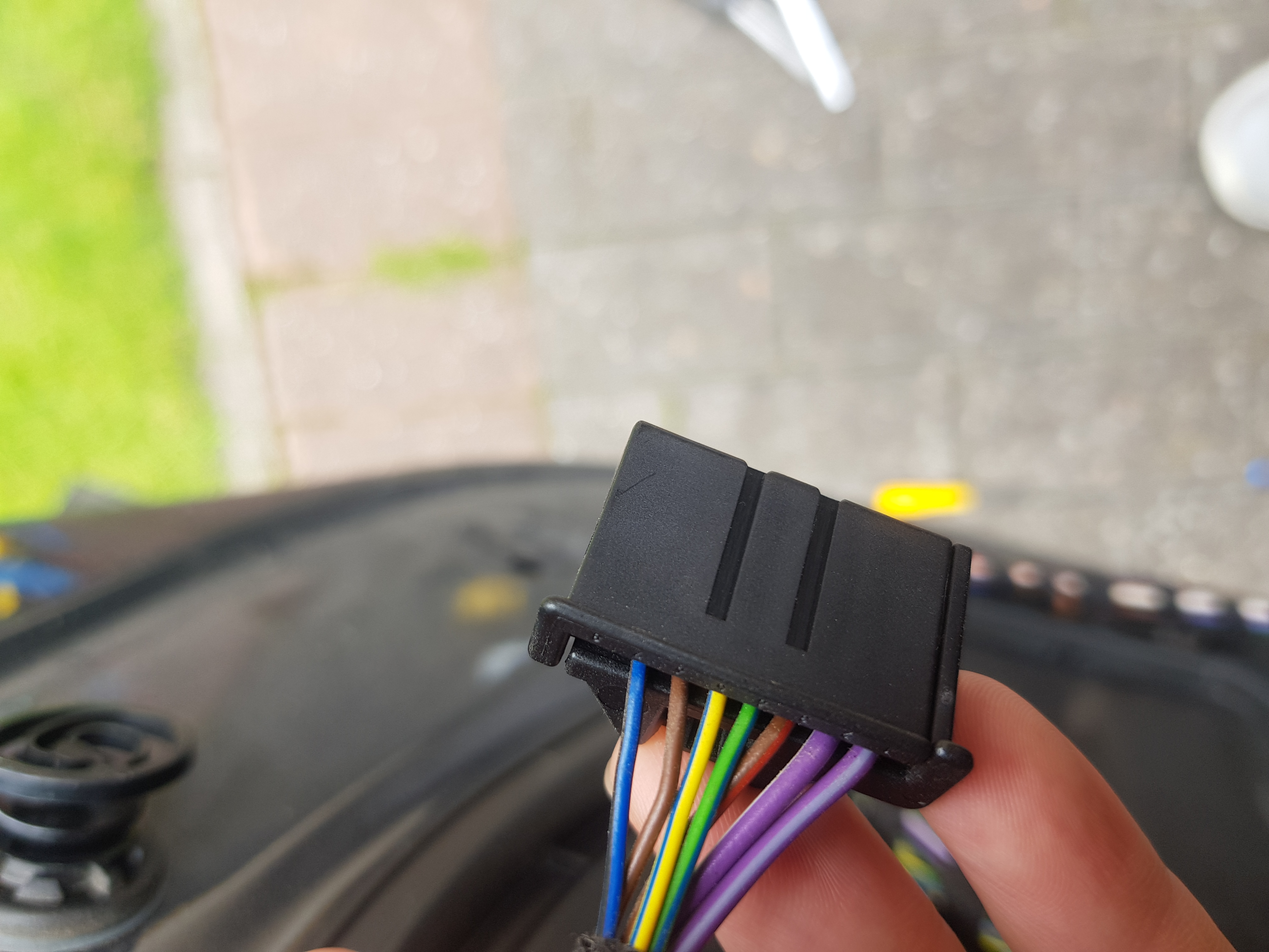

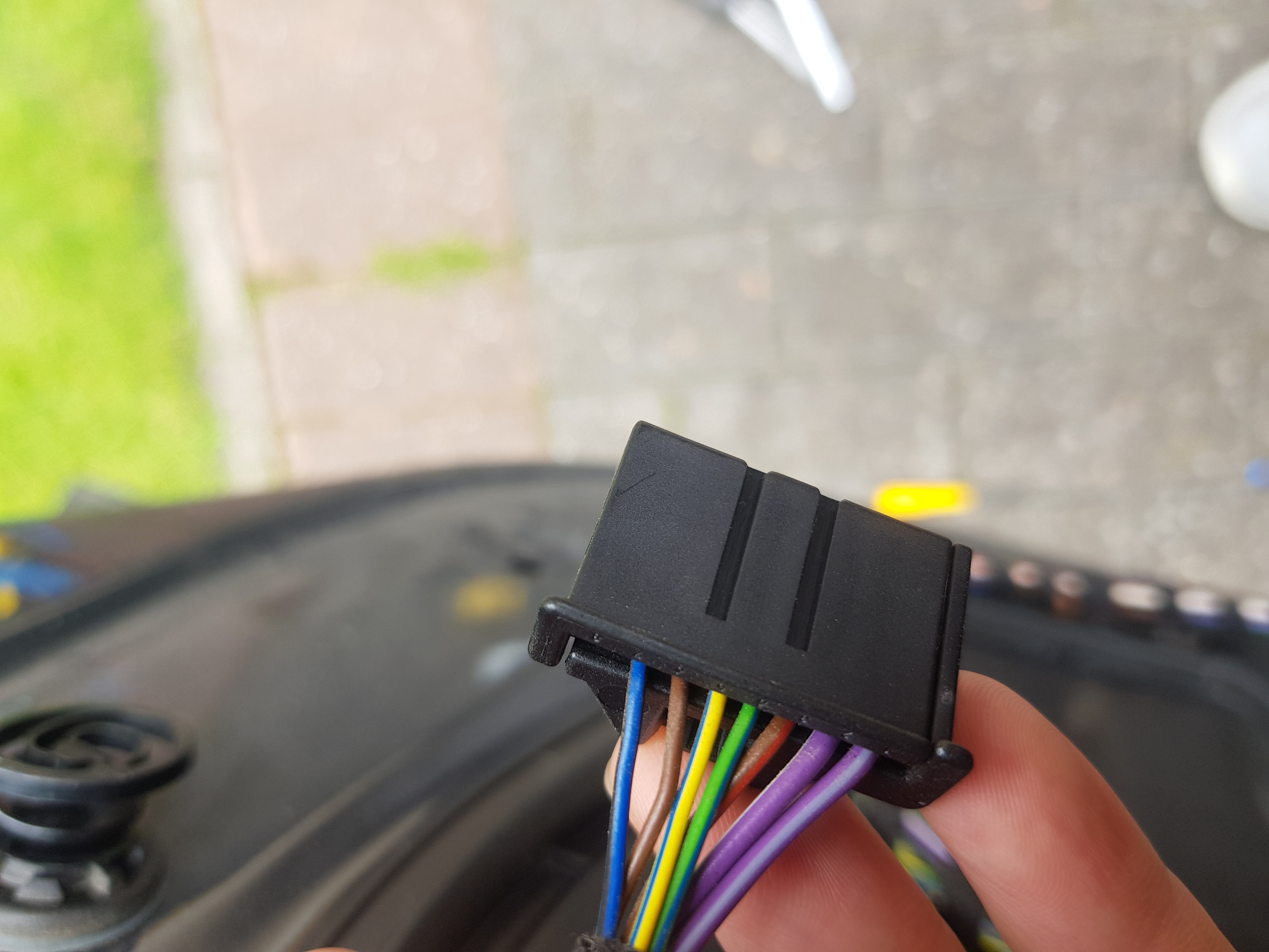

I am planning to connect a cheap module for remote locking to my 6C. The reason is i haven't find so far a solution to adapt the keys to my new cluster. I found a kit in my drawer and i decided to install it until i find the solution with my original keys.
The Kit have negative or positive trigger, but i don't know where i should connect those wires.
This it the diagram.
And this is the wiring from driver's door
Any thoughts about the connection between wires ?
The main issue is to find the wire (to the car) which triggers the locks.
- Posts: 6694
My guess would be a ground signal to one of t8f/ 1 3 4 5 7
