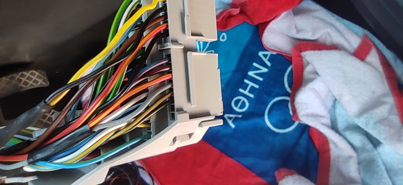

They are splices (not visible) inside the original wiring, so you have to do a search in the Elsawin with the terms B528, B320 to know exactly all the places/connectors-terminals that reach all the wires that attached to such junctions .
Then you choice the original terminal/wire that make it easier for you to do a new splice or crimp the new terminal/wire.
For example, in the 6R the T73b/17 LIN (B528) is also in the T28 door connector, which is an easier place than the white BCM connector (T73b) to splice a new wire that comes from the MFSW.
In many models of contact terminals it is possible to crimp two wires at the same time (it is contemplated in the crimping guides), except for those of small size such as MQS, etc, if the cable thickness is too large for these small terminals, the two wires would not enter through the connector slot.

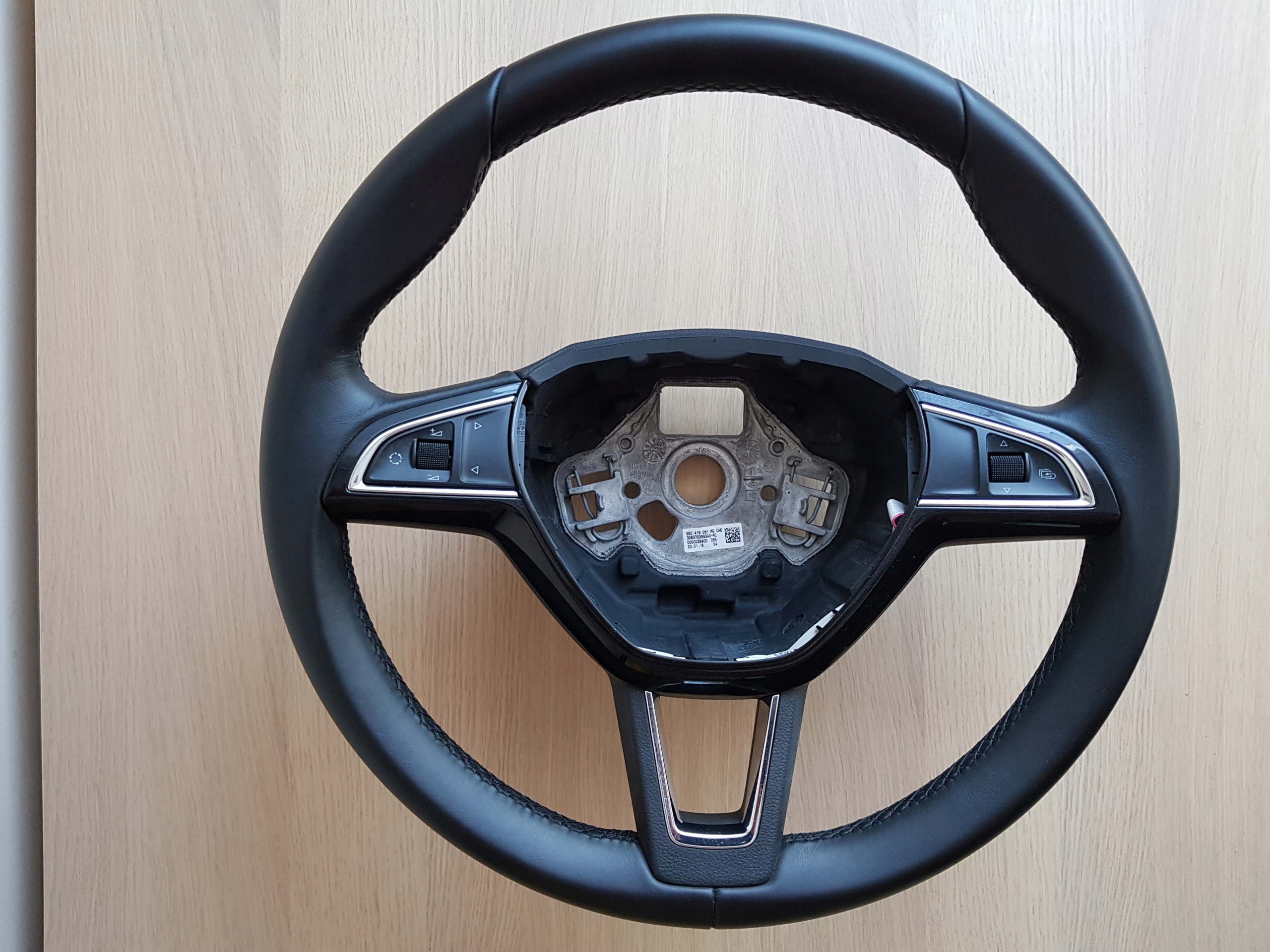

I am planning to retrofit Cruise Control in my car and I need to upgrade my 6R7937086F BCM
Is there an advantage/disadvantage to go for a 7H0937090D BCM instead of 6R7937087P if I can find them in similar price?
I don't have any plans for auto lights or direct TPMS.

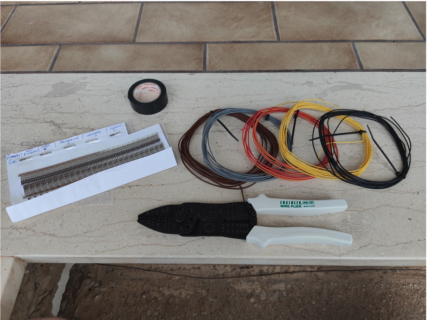

@ciclo what size is the crimp slots that you use to crimp the metal pins in the fuse box under the steering column?
1-24: Junior power timer
25-60: Standard power timer
I am taking about the dimensions you can see on the PA-09 and PA-21 pliers from your last post regarding the CC Emulator.
Posts: 8977
Re: Exantas Skoda Fabia 5J 1.2 TSI
Same to you, Happy New Year!
You must test what are the most appropriate measurements of the crimp grooves/slots, there are several possible dimensions, and possibilities, depending on the wire thickness to crimp, contact terminal, and manufacturer.
The contact terminal should be held lightly (without excessive force/tension) inside the crimp tool groove/slot.
It requires some skill, experience to make a good crimp (manually).
For the JPT I use the PA-21.
For SPT I use another type of crimp tool, bigger and power, similar to those sold on Aliexpress.
Good tools do not guarantee a good crimp.
I have many crimping tools, by size, cost and quality.

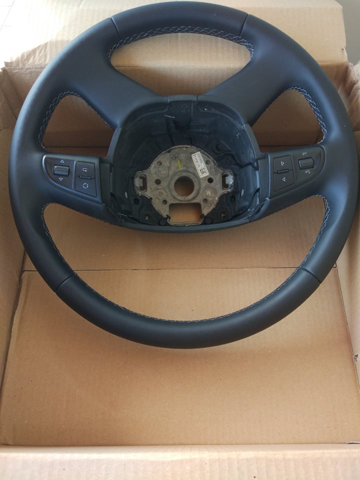

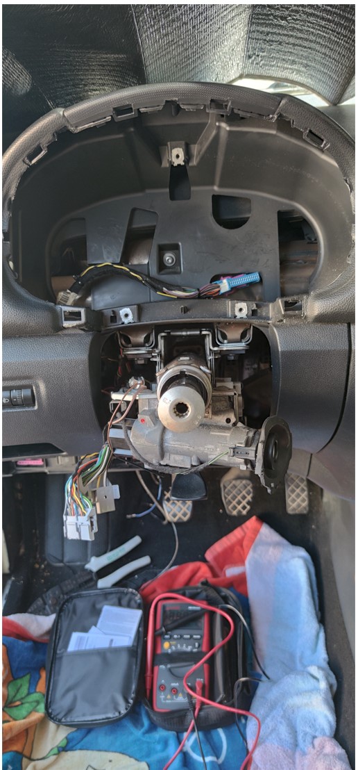

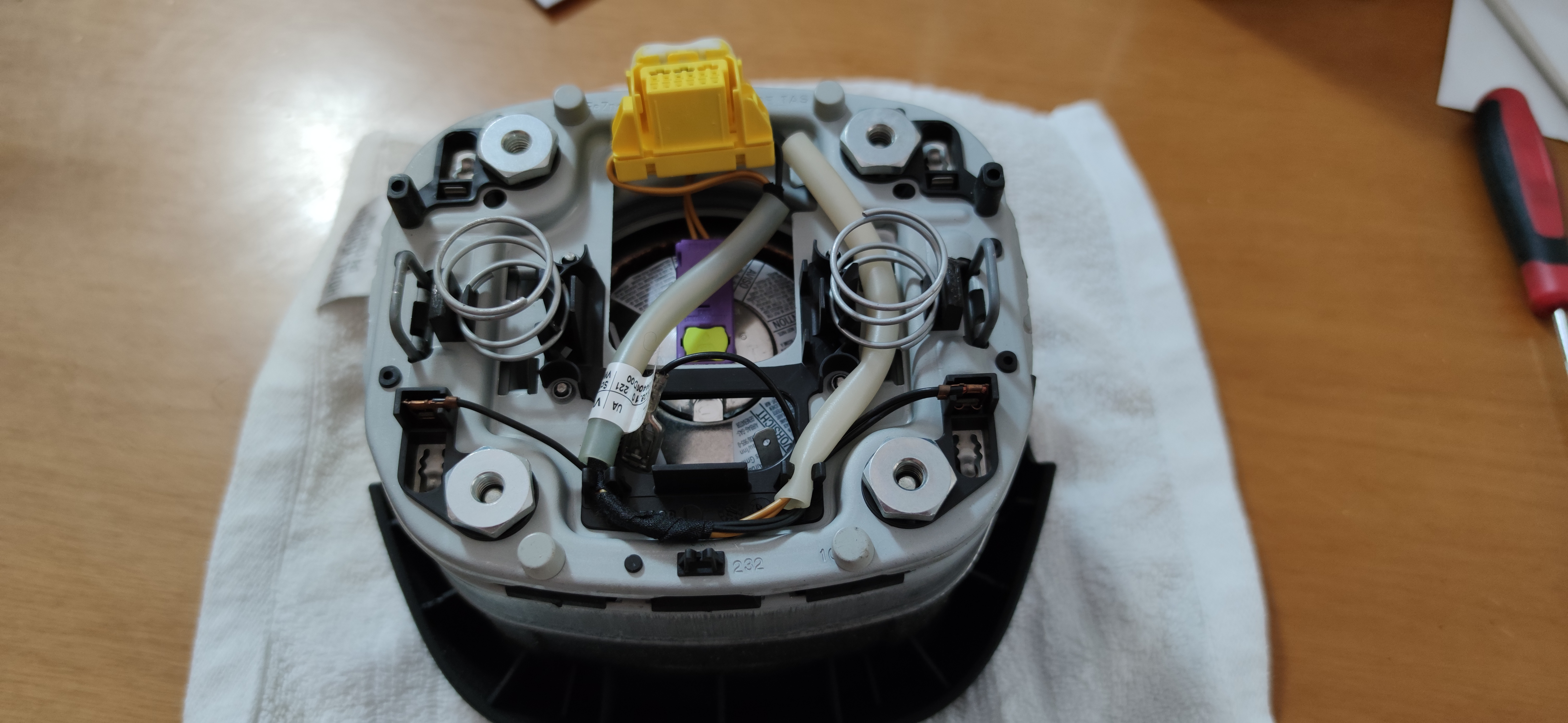

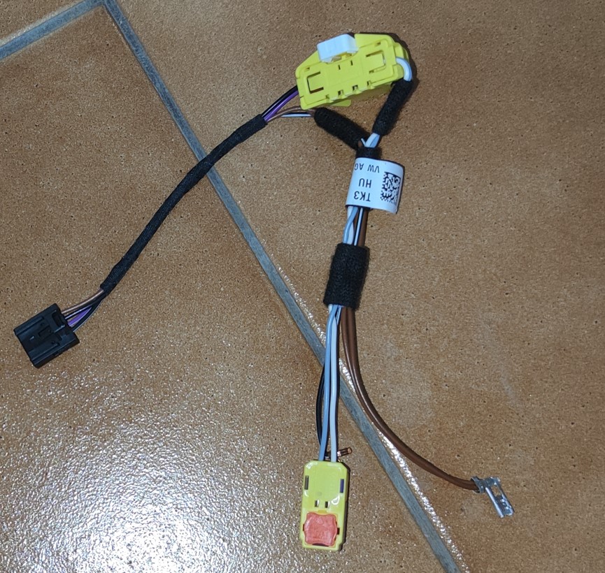

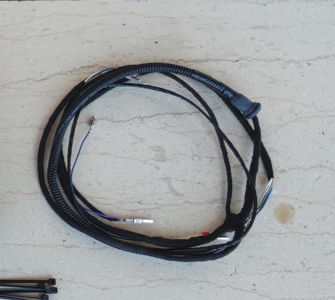

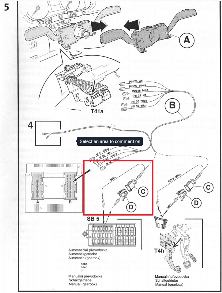

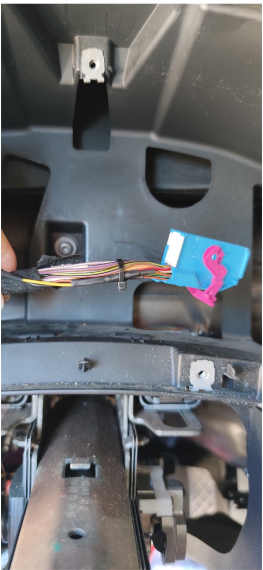

For the MFSW retrofit I plan to take power from the fuse assigned from the factory for this use. Since the slot is already populated, I plan to replicate the solution that Skoda CC retrofit kit does and create a "bridge"
using pins like these
https://www.ebay.com/itm/1-PIN-Male-Fem ... 4106825810

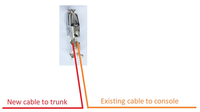

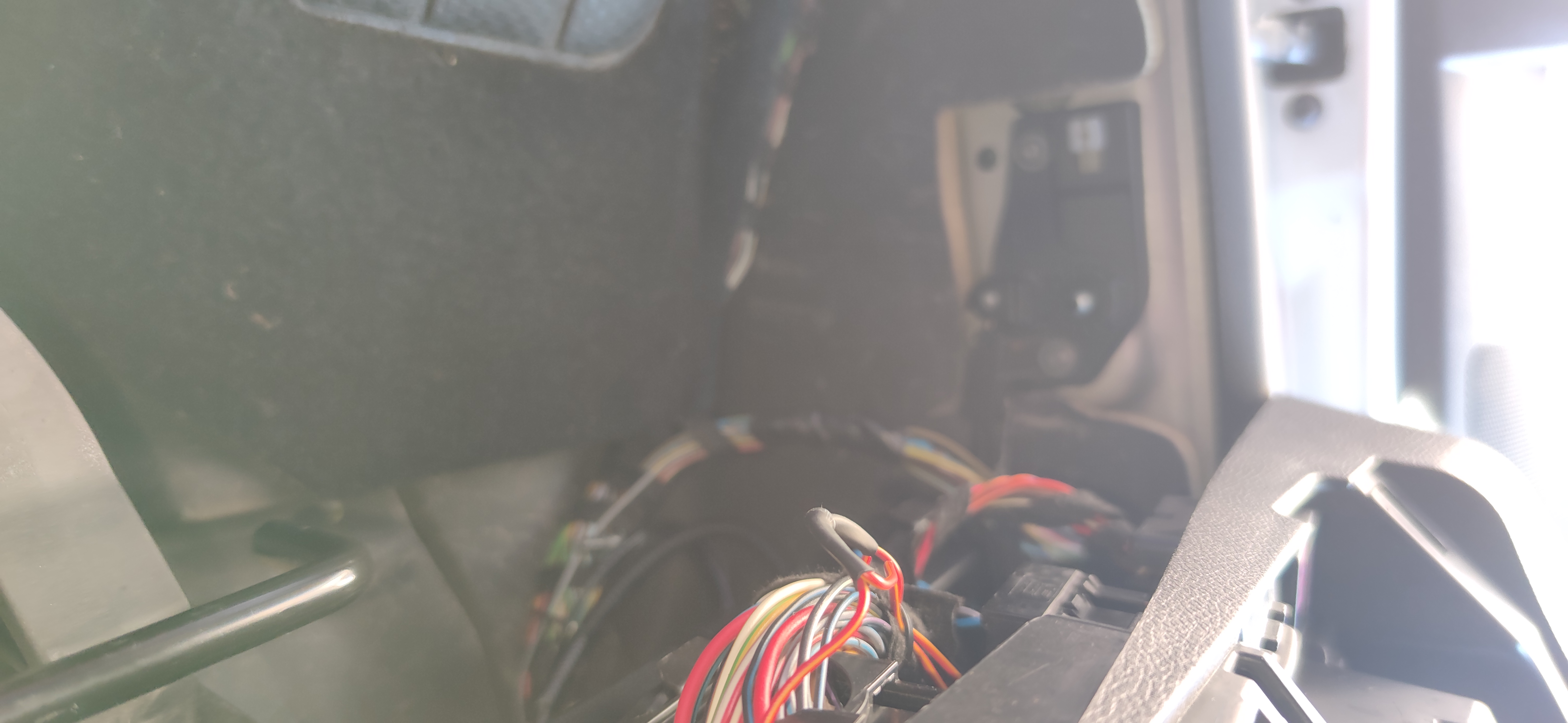

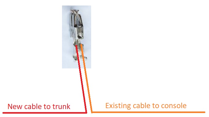

Fabia 5J gets a cigarette lighter socket in truck area as an option and oc I want to retrofit it :P
My idea for this is on the fuse that the cigarette lighter in the console is using, snip the existing terminal and have two cables come from a new terminal.
https://www.ebay.com/itm/10PCS-Vw-N-907 ... 2749.l2649
One cable is going to be the existing cable that goes to the console and second is going to be the new cable that I will pull to trunk area

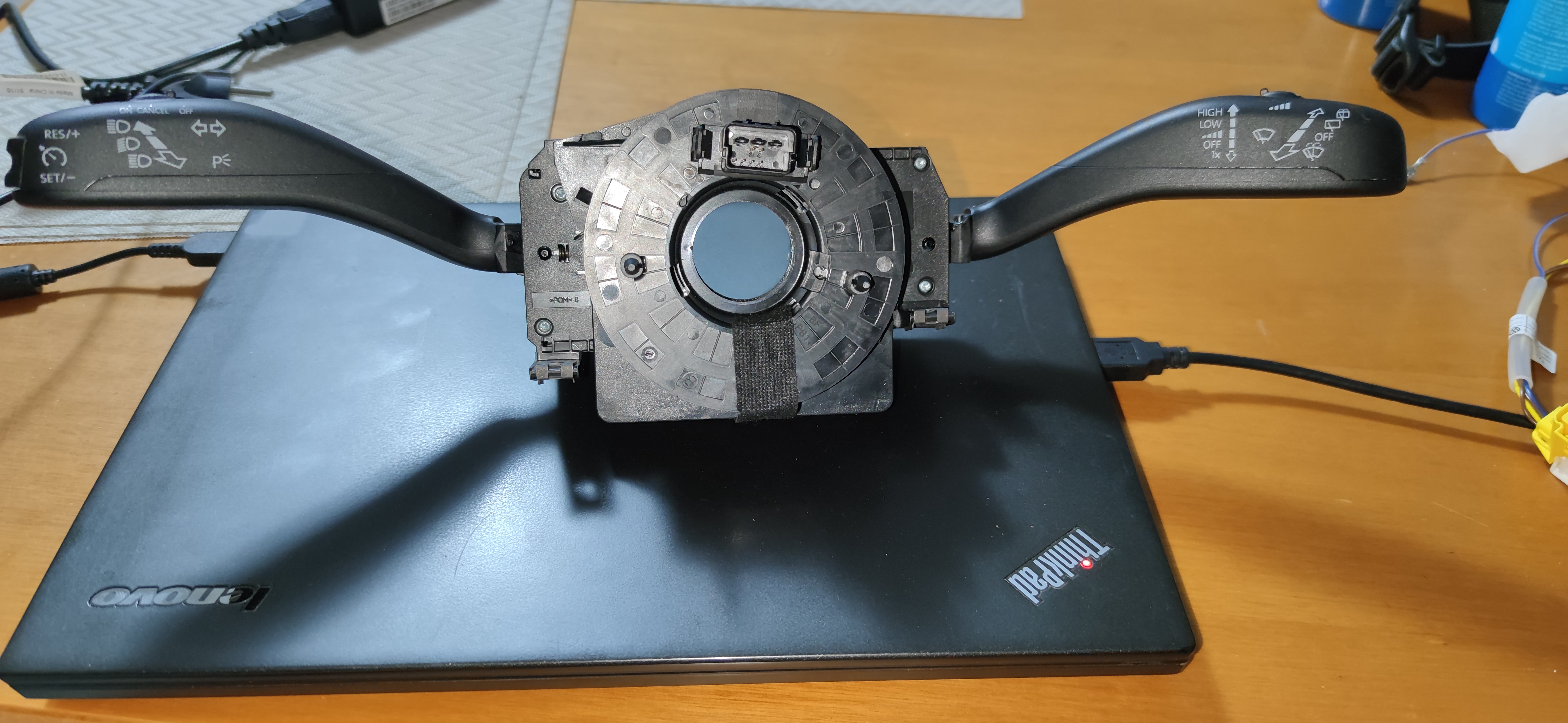

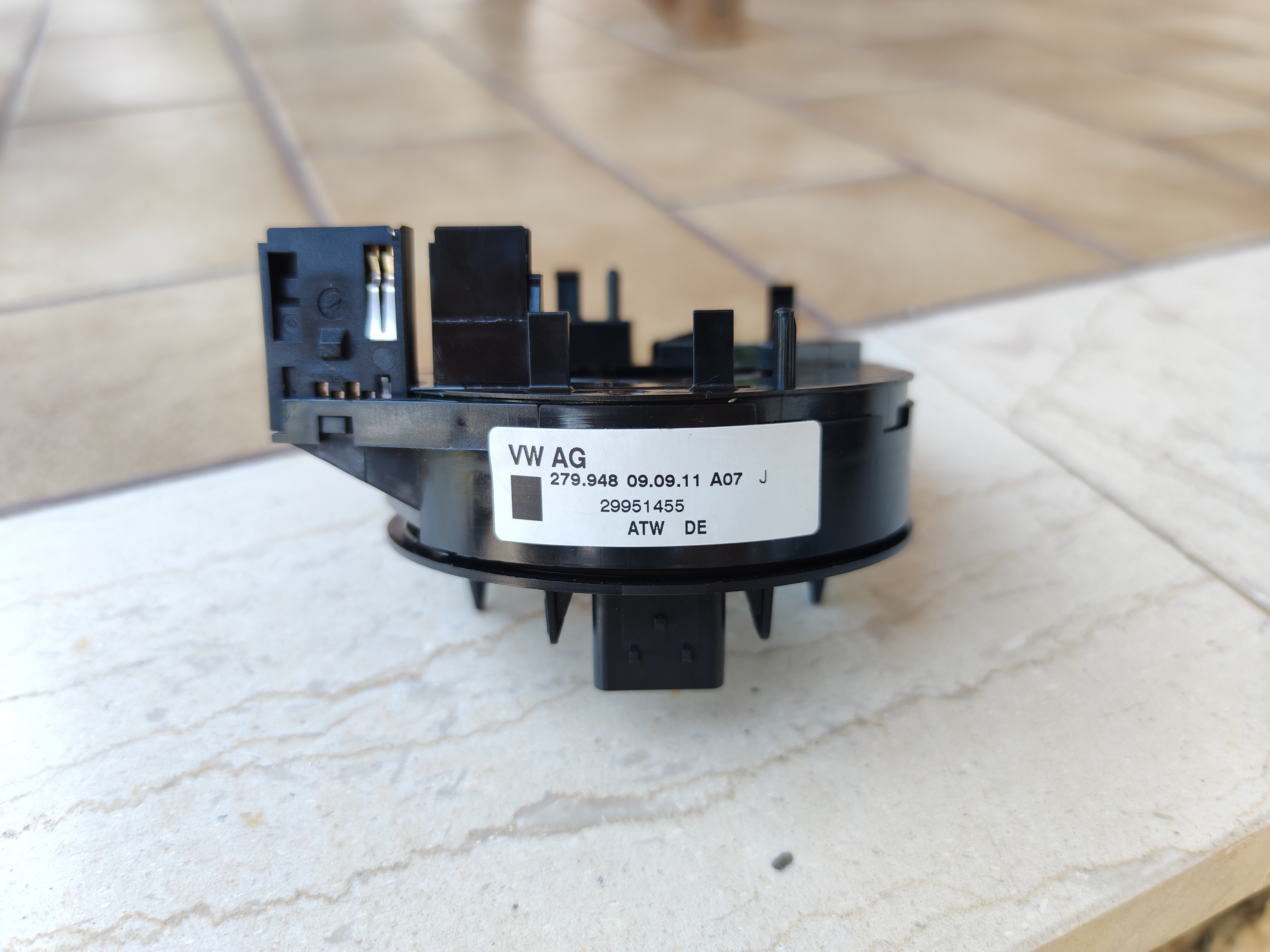

My car came from factory without ESP, so I have ABS8.2 and slip ring without steering angle position sensor.
If I upgrade the slip ring to one for ESP car (provided I installed the extra wires needed) will it work without errors if I don't upgrade the to an ESP pump?
I am interested to retrofit static cornering lights function through the existing fog lights.
Sent from my MI 5 using Tapatalk

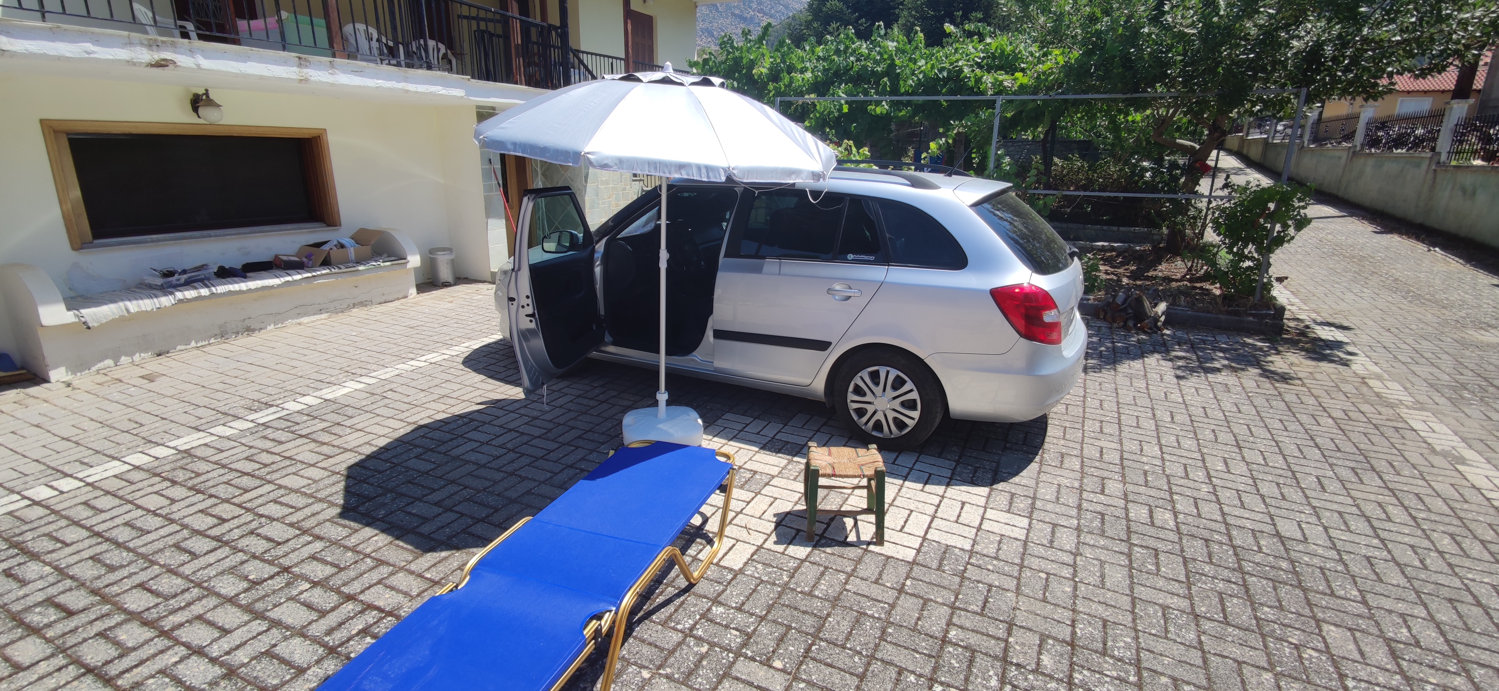

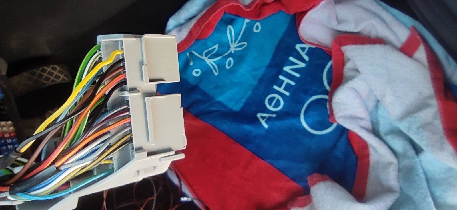

Next it is time for BSM upgrade
My car came with 6R7937086B, but I always wanted to retrofit CC . So last summer I bought from forum user Vasileios his old BCM 6R7937087H from an automatic gearbox Fabia vRS.
Old BCM
New BCM
For the process I used
1. A flathead screw driver (to unclip the old BCM)
2. Obdeleven
  • a.Get backup of old BCM long coding
    b.Get backup of Gateway long coding
    c. Use old coding on the new BCM
    d. Set old long coding on Gateway (which changed after installing new BCM)
    e. Adapt existing keyfobs so I can lock/unlock the car.
3. Beach sezlong (I opened the drivers door and set it next to the car. This way my back was in the car and my legs on the chair, so I could access the BCM with my back on the car floor. This way you can work longer on this position without need to remove the drivers car seat)
So far I was able to install new BCM , set old long coding from old BCM and Gateway and adapt the keyfobs.
Issues/faults:
On IC I'm getting a fault code that didn't have before the Bcm change
On BCM I get one fault code for backup lightbulb check
On Gateway I am getting 5 fault codes:
My car doesn't have these modules and I have not found a way to change the installation list using Obdeleven so far.
Visible change with new BCM

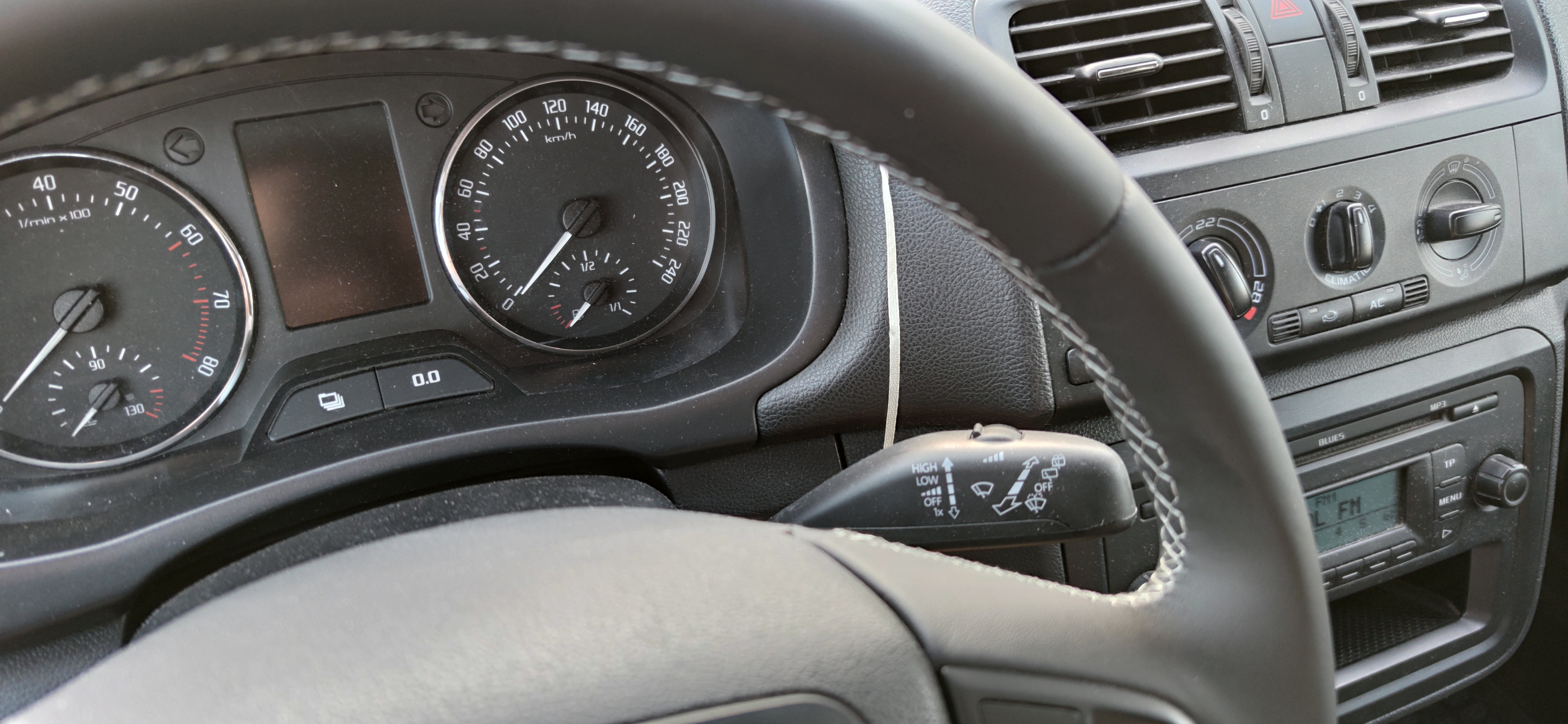

1.Now IC show safe lock message after removing key from ignition. The car always had this functionality but never showed this message before.
https://www.youtube.com/Bq0NCFRVoyQ
2. The gear shift indicator on the IC is not working any more. There is no indication about the current gear or recommendation to select specific gear :(

Today I gutted my car for good.
Screenshot 2021-10-27 002433.jpg (153.03 KiB) Viewed 34669 times
IC out, airbag, steering wheel, slip ring and stalks out also.
I made myself the cables for Mfsw and G85 retrofit.
Screenshot 2021-10-27 001949.jpg (387.82 KiB) Viewed 34669 times
I have also acquired CC retrofit wire harness, original Skoda spare part and got the wires fitted on the same time.
Screenshot 2021-10-27 002159.jpg (95.73 KiB) Viewed 34669 times

I got power from the according fuses SB 4 and SB 22. Ground I set on the nut that exist on the steering column.
For Mfsw I got power from SB 22. Lin signal I got from A pillar T28 wire harness. Elsa win was stating that cable for LIN was supposed to be white-gray.
In my car there is no such a cable. After lifting the car insulation that covers T28 I saw pin 5 that the cable in my car is yellow-gray.
I split apart T73b on BCM module and checked for continuity between pin 17 (white-gray) and yellow-gray cable and got the bip from my multimeter. So I am good with that.

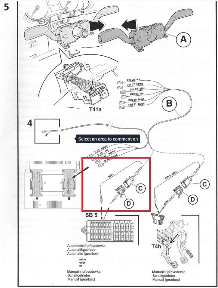

When it comes to CC I have set all cables in T41a connector, but I have trouble with fuse box. I don't know how to unlock the fuse box so I can insert new pin in slot SB5.
Any one knows what lock I need to remove and how for slot SB5? The box seams to have 3 tabs.
One purple one the top and one purple and one blue on the side.
I have zero clue how to open the top one.

I replaced the indicator stalk with a brand new unit that has the lever with the CC buttons, but not the trip computer ones.
I got a used slipring with the steering angle sensor from Vasileios Fabia VRs
For steering wheel I went with a refurbished MFSW. New leather parts with used buttons from what I can tell.

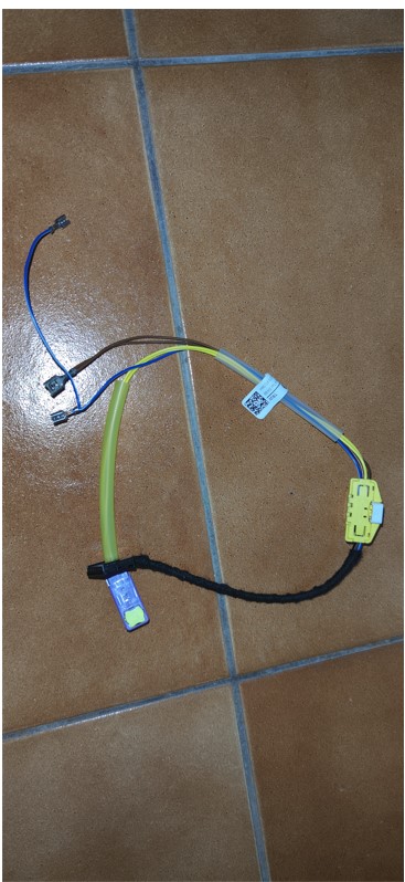

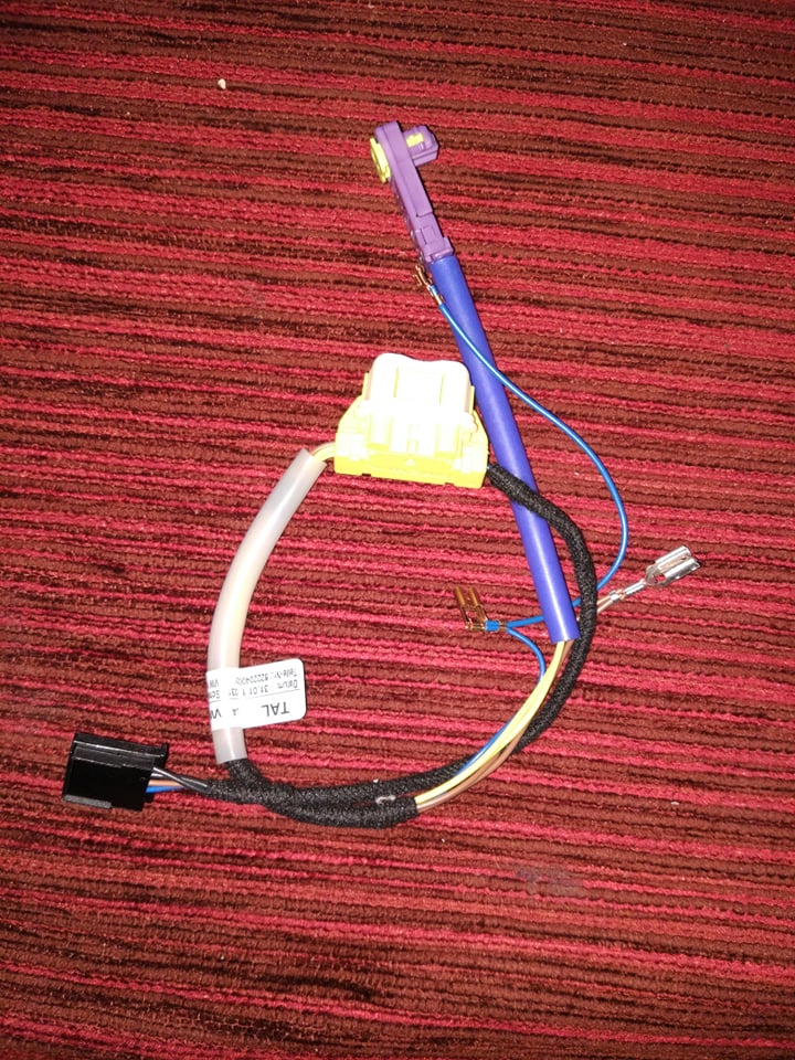

I had order new airbag cable that has provisioning for the steering buttons.
My car came with this airbag
And I had ordered 3T0 971 584A cable
Screenshot 2021-10-26 233416.jpg (83.27 KiB) Viewed 34675 times
That didn't work though:
1. Pins that go on the airbag are the wrong size and wont fit the airbag pins
2. Also the blue cable is too short: If I set one of the blue pins on the airbag (90 degree pin with black cable originally), the other blue pin doesn't reach to the other pin like you see in the original cable.
So I went to local Skoda dealer and order the wrong cable again :P
I ordered 5JA 971 584 which turns out to be completely wrong for my application
Screenshot 2021-10-26 235034.jpg (265 KiB) Viewed 34675 times
That cable is for Skoda Fabia 5J but for "03.10.2011>>", i.e. cars with the new style of steering wheel and airbag.
Now that I knew what was the correct cable for my application I went once more to local Skoda dealer and ordered
3T0 971 584
Unfortunately by the time new cable arrived, I had to go away and couldn't install it on the car and test it.
So currently the car looks this way
Looking smart with all this new buttons that don't work :D and without the trip computer buttons to change the change the IC menu :/

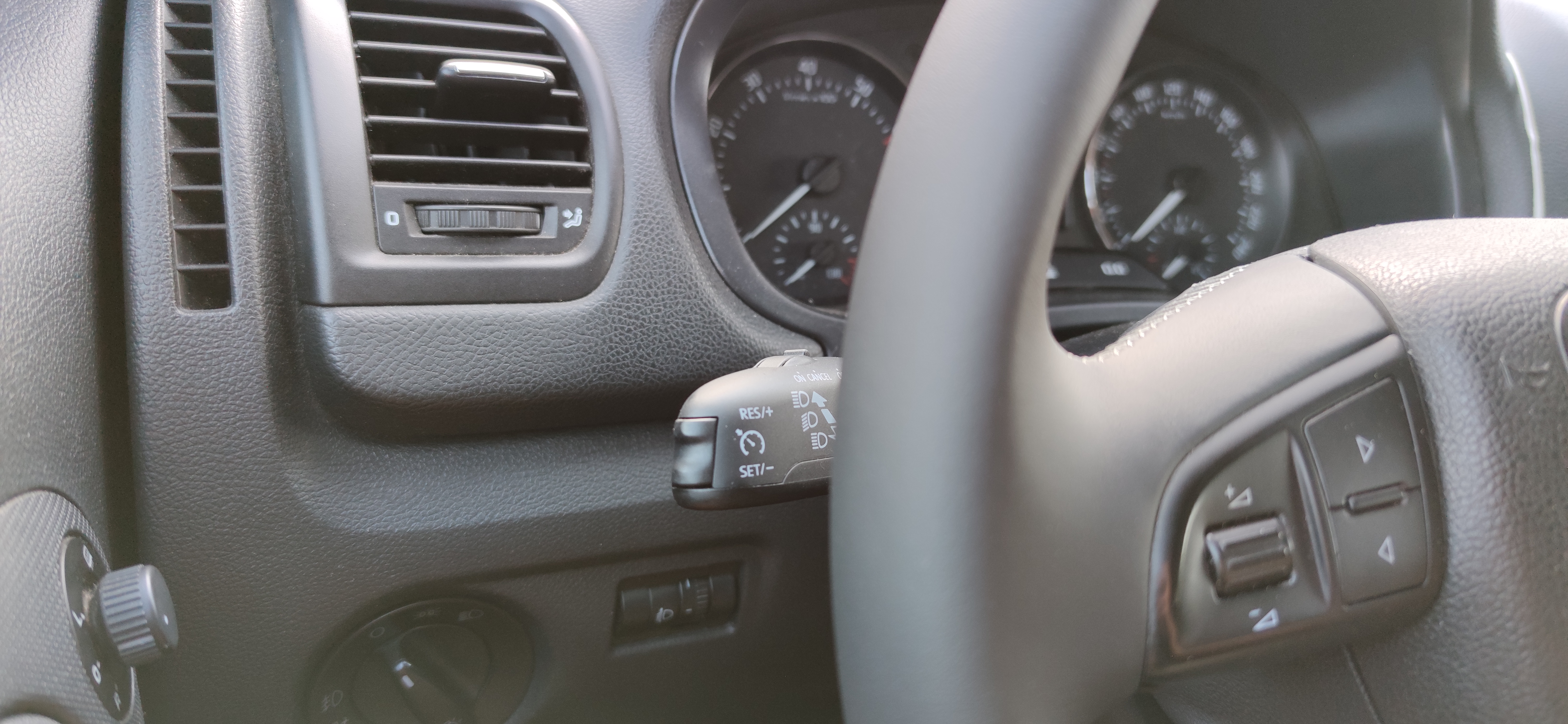

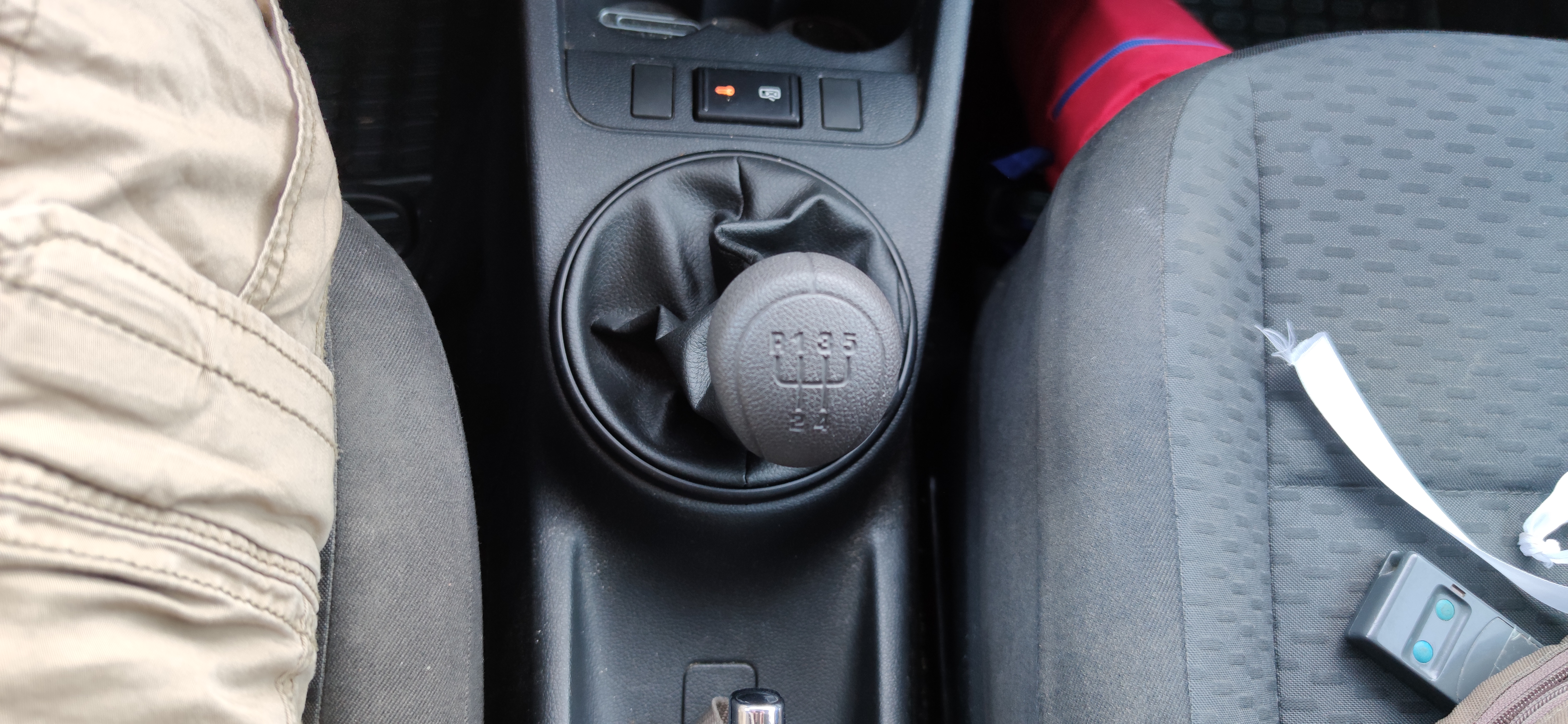

From all this work I had 3 things that improved:
1.New steering wheel feeling. Feels way better compared to the original plastic one.
2. Indicator stalk is brand new and feels so much better compared to the original one that had 100k on it. When the indicator stalk returns to original position is noticeably quieter.
3. I got my hands on a NOS gearshift boot from a pre facelift 5J and installed that. So all areas that you touch every day have brand new materials
MFSW buttons and CC has to wait until next time I have access on the car.
