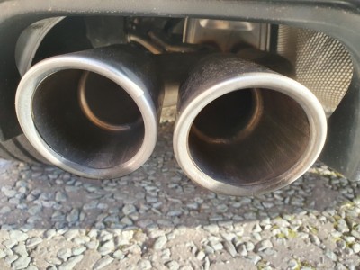

Car itself is very dirty right now but lower part is black (not wet) and in summer this part was visibly black while rest of that lip was nice and shiny.

For South African Built Polo GTIs, they ceased MY18 production in July 18. They picked up production again for MY19 in Sep 18, and i'm pretty sure that everything built after that point was WLTP compliant and had GPF, whether built in South Africa or Spain (unless some markets have exemption perhaps?).RUM4MO wrote: Fri Jan 17, 2020 3:37 pmThat is interesting, I'd expect that you would find the same as monkeyhanger finds with his wife's GTI+ with GPF, so what exactly is your GPF doing when it is passing the soot that appears on the tips?Dark_cze wrote: Fri Jan 17, 2020 3:00 pmI have gti made in 11/2018 spain. With GPFand my tailpipes are black like my old diesel Audi A4 B6monkeyhanger wrote: Fri Jan 17, 2020 2:43 pm My 2018 GTI+ without GPF has sooty tailpipes, my wife's 2019 GTI+ with GOF has spotlessly clean tailpipes.
The tailpipes on my 2015 Golf R were filthy too.no fluids are missing and consumption is fine so I guess no technical problems there.
If you have a GPF and sooty tips, I'd assume it wasn't doing its job effectively. Are you sure you have a GPF and it hasn't been doctored for performance reasons?

everything made after september 2018 need to be WLTP compliant. Mine was build 11/2018 and registered 12/2018. Engine is code is DKZC, while pre WLTP cars are CZPC. No performance issue, no fluids leaks or missing and nobody touched GPF from day VW delivered it to me.monkeyhanger wrote: Fri Jan 17, 2020 8:48 pm

I'll take pics of the tailpipes on mine and the wife's GTI+ to show difference between the 2 cars.Dark_cze wrote: Fri Jan 17, 2020 9:10 pmeverything made after september 2018 need to be WLTP compliant. Mine was build 11/2018 and registered 12/2018. Engine is code is DKZC, while pre WLTP cars are CZPC. No performance issue, no fluids leaks or missing and nobody touched GPF from day VW delivered it to me.monkeyhanger wrote: Fri Jan 17, 2020 8:48 pm
If you have a GPF and sooty tips, I'd assume it wasn't doing its job effectively. Are you sure you have a GPF and it hasn't been doctored for performance reasons?Don't really think there is anything wrong (except noisy suspension and noisy breaks while reversing).

I never really cleaned tail pipe on my gti so it was collected over 25 000km and 13 months (not sure if collected is right word). I touched it with finger somewhere in october and it was black dust but just a light deposite. To be honest Iam not even sure if I ever had GPF regeneration (Iam sure it should be done many times already) but probably I didn't notice it. My photo was prety bad, my car is dirty like pig and tailpipe too. I will clean it and will see how it will look after week or two.

I edited your photo to show how was mine looking few months back
