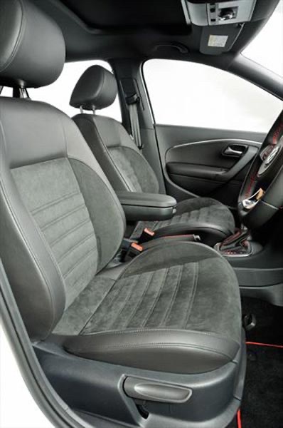

Re: Uncomfortable seat mods
Does anyone know from what cars can we retrofit the bolstered seats?
Do golf mk5 gti seats fit? Like are they bolt on?
These seats sit a bit to high of the floor for my liking and offer bad support.
Sent from my Nokia 6.1 Plus using Tapatalk
Posts: 3850
The seats from a mk5 Golf (or mk6 Golf, which was a heavily facelifted mk5 Golf) will be bigger than the Polo’s seats. Therefore, I’d anticipate the seat rails will be different, and if so, it wouldn’t be possible to do a straight swap; you’d need to get a set of custom seat rails made or modify the Polo’s existing seat rails, if that’s possible. There might also be issues with the seat airbags (the connectors might be different). If it was necessary to deactivate the seat airbags because of different connectors, then in the UK that would be likely to have insurance implications
Wouldn’t it be easier to find a pair of front seats from a Polo GTI? They might not solve the issue of the seats sitting too high, but with the Polo GTI’s seat having larger side bolsters, they should provide more lateral support than your current seats if that’s what you’re primarily looking for.

How about the optional Alcantara sports seats that were available in both the 6r and 6c Polo? These were available as an extra cost option in most models within the Polo range and may be more readily available in your country that the specific Polo GTI seats.
