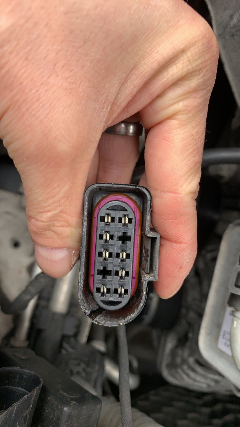

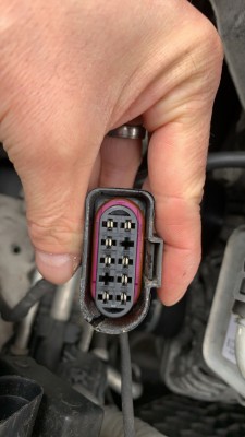

Also does anyone have a pin layout for this headlight plug?
