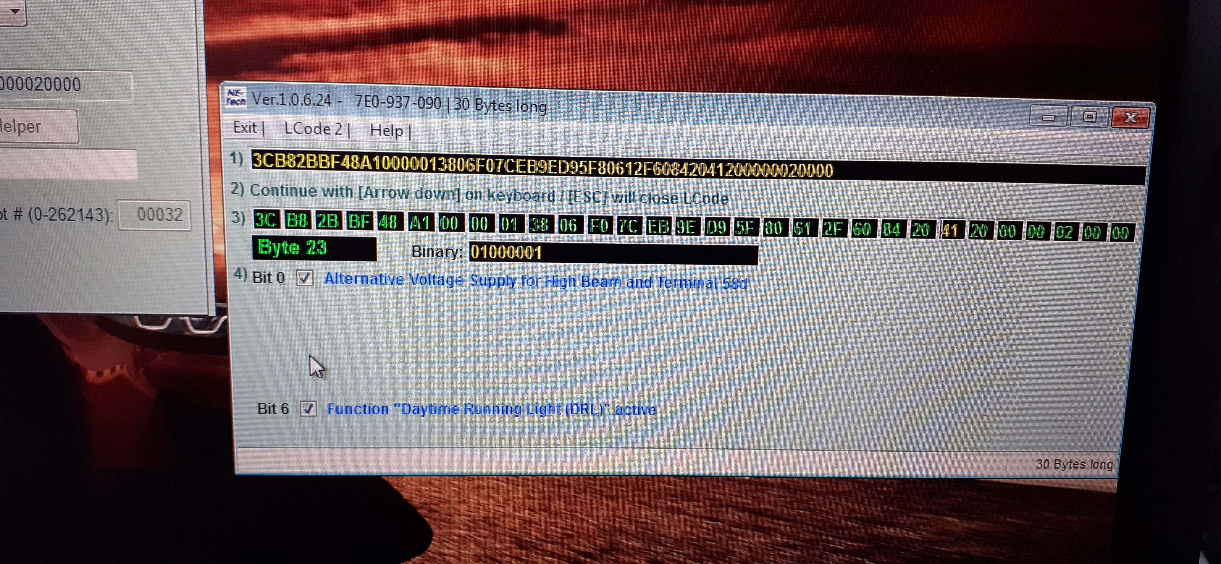

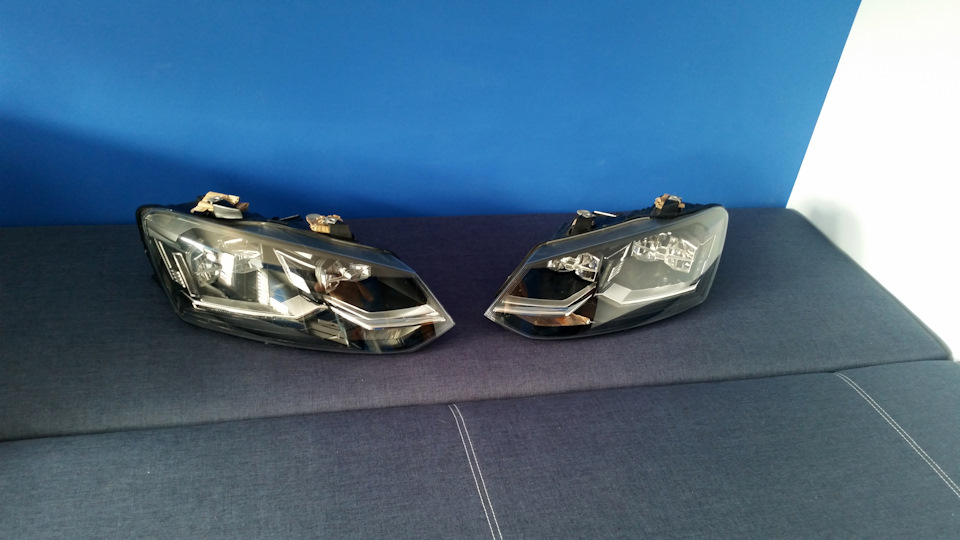

So i am still wondering for those new lights.... the main problem for me is: that i got blacked my headlights, and here in my county this is illegal :) And i always have to drive with turn on headlights, in order to be not so obviously. Is there any coding for always on DRL via low beam? If yes i will leave my headlights like that and get rid of the R-line body kit, and go to full black WRC bad-ass look, just gonna retrofit front and rear PDC and headlight wash system.
Posts: 8996
Re: Reverse Lamp and Camera disappeared after BCM max Upgrade
:lol: :wink:
Perhaps it is possible, no one asked me about operating the DRLs using the low beam lamps (H7) with a BCM Max installed, that's why we never tried it.
In BCM enable Byte23 Bit 3 (I guess Bit 6 must be enabled).
Tell us the results.
Maybe there is a bulb fault (warning) in the IC, ...no problem, we will try to code other Bytes to fix it... post the autoscan.

Hello ciclo,
Did i miss something or there is no Bit 3 here :?
Posts: 8996
For example:
...by ciclo 👽

Hello guys,
I manage to code my BCM to use low beam as DRLs. Next week will post auto scan.
