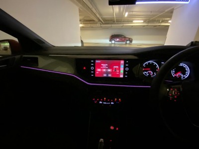

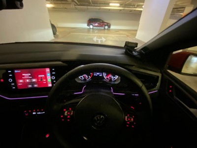

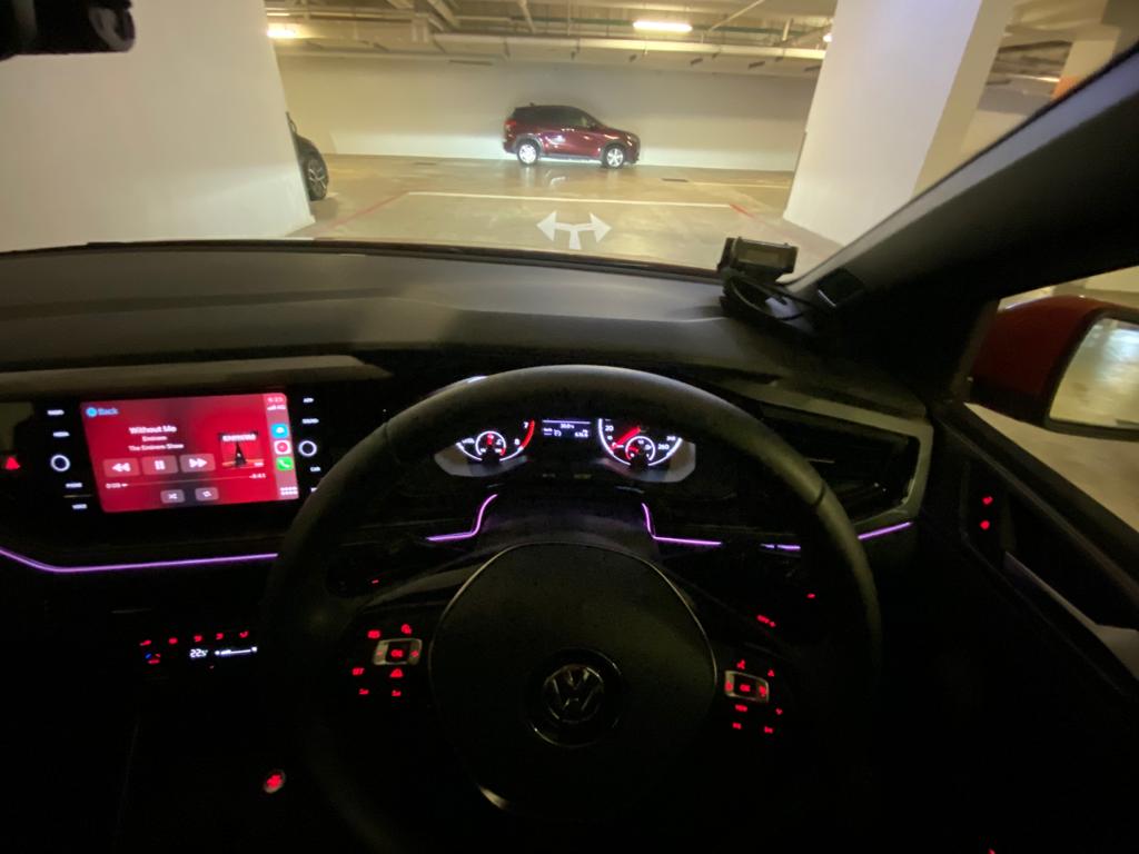

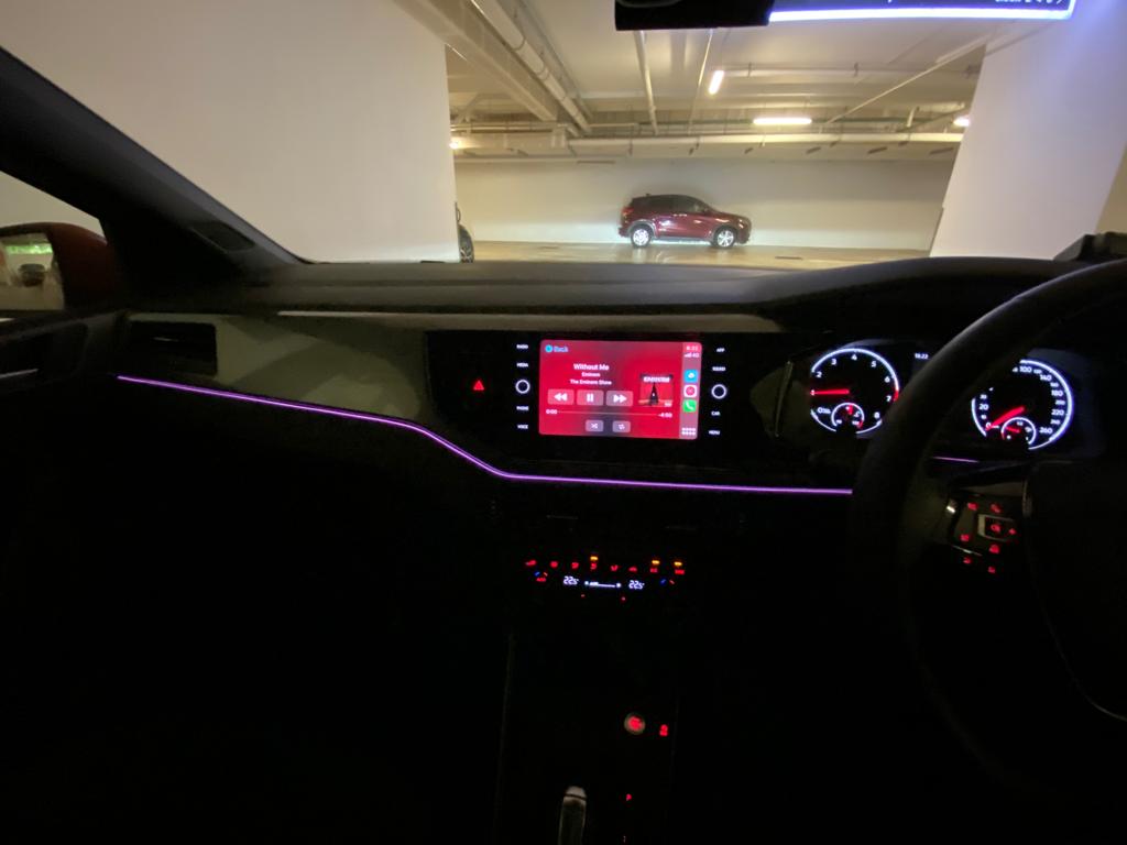

I had a lot of time on my hand today so decided to install the EL Lights for Volkswagen Polo.I had seen some videos but they were not complete, and its never easy to do something on your own no matter how good the videos are. So making a simpler guide for those who want to give it a try.
Total cost of the mod: <$5
Time Taken : 10-15 minutes
Difficulty: Moderate
EL Wire Link: AliExpress (Cost $3.25) 3M Length Purple Color
Few things I wanted to achieve:
1. Turns on with headlights/at night/auto on
2. Ability to dim the lights with headunit using dimmer funcitonality
Began my opening the headlight switch. This can be done simply by pressing the headlight inside and rotating right. A video on how to do this below:
https://www.youtube.com/watch?v=xVnrIJTRz6o
Once you have opened the switch and disconnected the red harness plug, you need to tap into blue&gray wire which is the last wire on the switch and is actually the dimmer wire.A good link explaining how to do that.
https://www.autoinstruct.com.au/manufac ... tallation/
Then you need to find a ground, which is easy found by tapping into baremetal bolt right next to fuse box. And Wallah! Its done. Posting some pictures and short video below:
https://youtu.be/ru6JirOfWGk
Have fun doing this mod guys. Hope this helps someone do this.

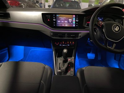

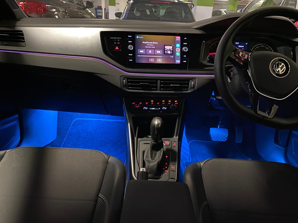

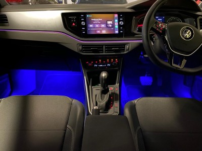

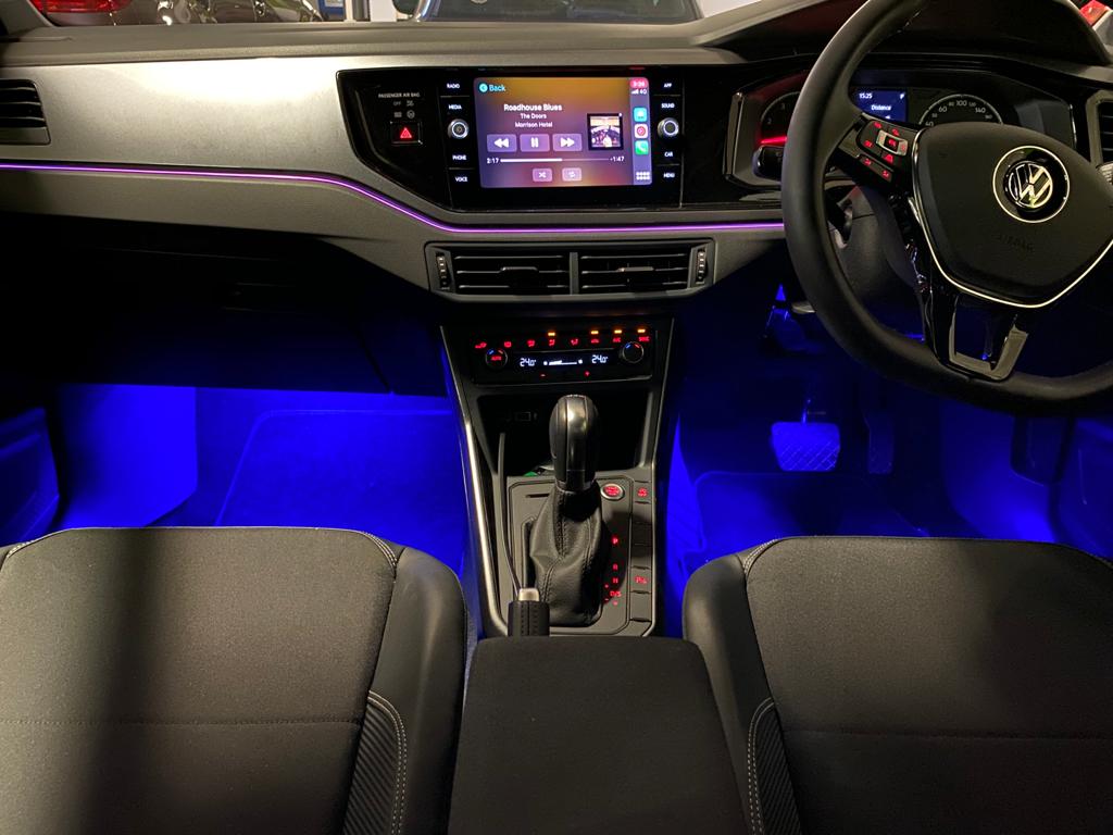

Added LED lights trip at the footwell, these can be controlled by remote, via app and respond to music as well. They also remember the last setting.
My default settings as follows:
Brightness 30%
Color - Cyan or Purple
Light Turn On - The light turns on with the headlights. Tapped into same dimmer wire to turn on. Light can also be turned off by headhunt.
4 Lights in total. 2 in front, 2 in rear. The make the car look lot bigger then it is, as they make the car brighter.
