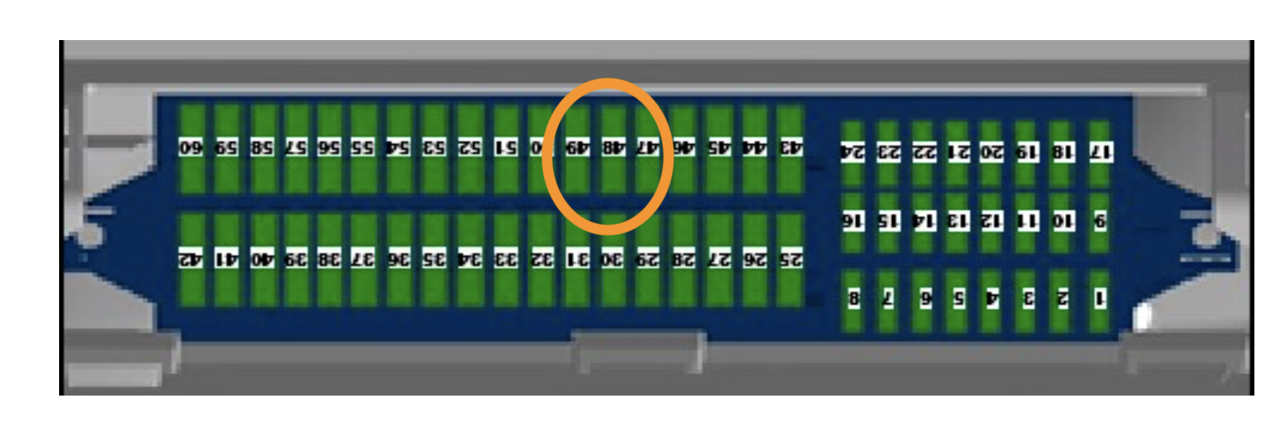

Please check fuse number 48

Thank you iichel it was a fuse in the end!
