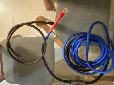

2) KnuzConcept 4 Gauge Wire Kit

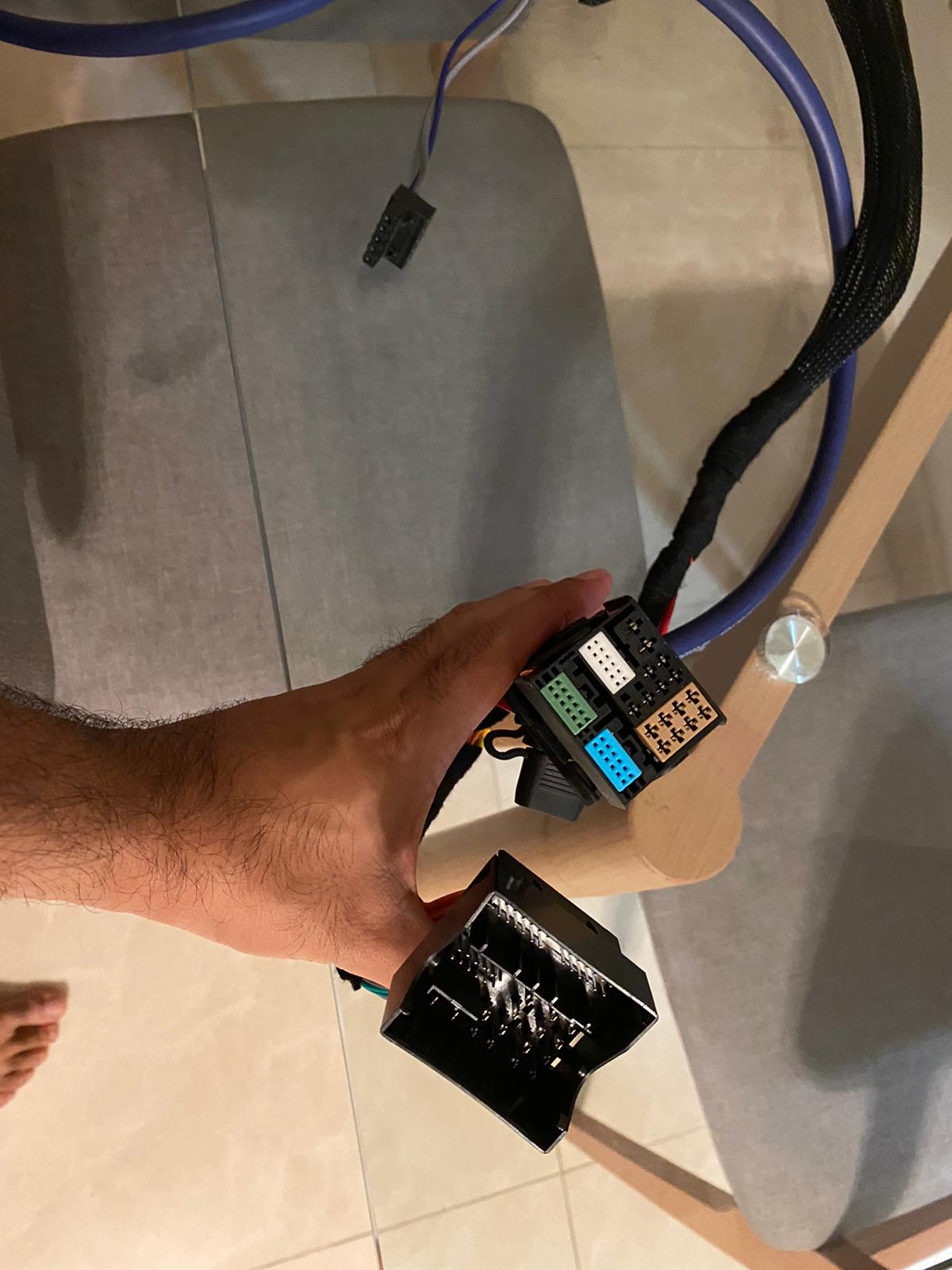

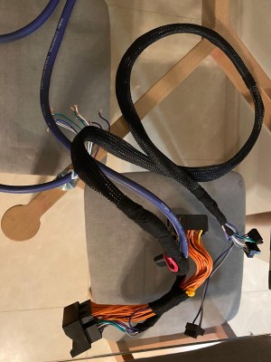

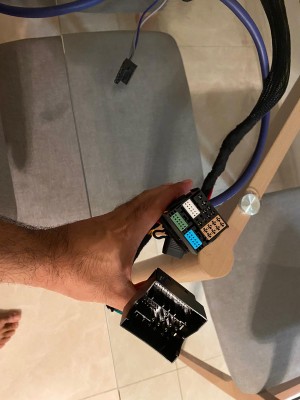

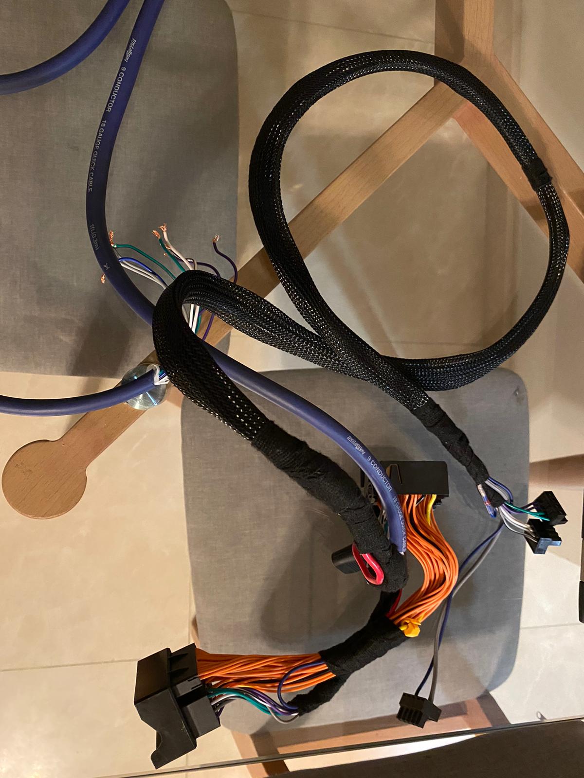

Once the items were there, the install was 2 prong approach. Do all the cabling/wire harness creation and soldering at home. Then going to car to install.
The Wire Harness Picture Below:
Please note I have a JL Audio Fix 82 as LOC. This maybe overkill as its a DSP + LOC. Now Polo has a full signal on both front and rear speakers, so you dont need Fix 82 as such, but it does normalize the signal and give your system an extra kick. For $200 with optional remote, I feel in hindsight an overkill but like I said, does make your system sound better.
