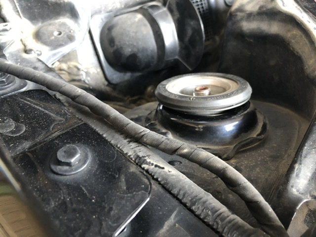

But when I tried to tighten the metalcup part, on top of the strut inside the enginebay, it doesn’t meet the body.
No matter what I do or try. There is always a gap of 2-3mm between the rubberised underside of that metalcup and the car body.
Is that totally normal and OK ?
I was told that because the rubberpiece inside the fender is old it is OK. I didn’t replace those with new ones.
Seems a bit odd to me that it doesn’t have to be tight and that a gap like that is normal.

Most probably the top-mount bushings have collpased and are less tall than they were when new.
It is always a good rule to replace them when replacing shock absorbers, because they use to deform with usage.

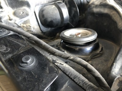

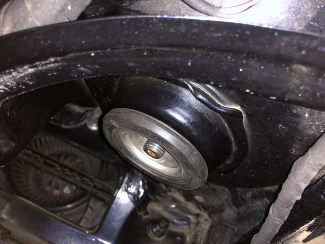

It’s normal, the top strut need to be replaced. Not dangerous at the moment but also not comfortable during the ride as new. I’ve got the same problem and i’ve solved it replacing them. Here 2 photos, one before the service and one after
Now the ride is comfortable even for a b12 :lol:

That metal cup will be to stop the suspension "escaping" if something nasty happens, it is not, I think, meant to tighten up against the car body as that would cause rubbing and loss of paint and so rusting in these areas.
Edit:- I'd think that as long as all the parts were fitted in the correct order, ie the top bearing under and not over the sprung steel metal in the top mounting, then it will be okay.

Pierlu’s before picture is just like what I am experiencing now !
I am a bit concerned, as I sort of feel as the fitting should be tight....like any fitting in a car.
Especially in suspension.
Altough many have also said it is normal. As even with the original set up (before I changed the springs and shocks) and with that old rubberlump in place there should have been that gap. As the age of that rubbermount would have created the same gap there with the original springs and shocks ? I simply didn’t even look at that when I took them out :oops: .
And if all that is true, am I simply worrying for something that I do not need to worry about?

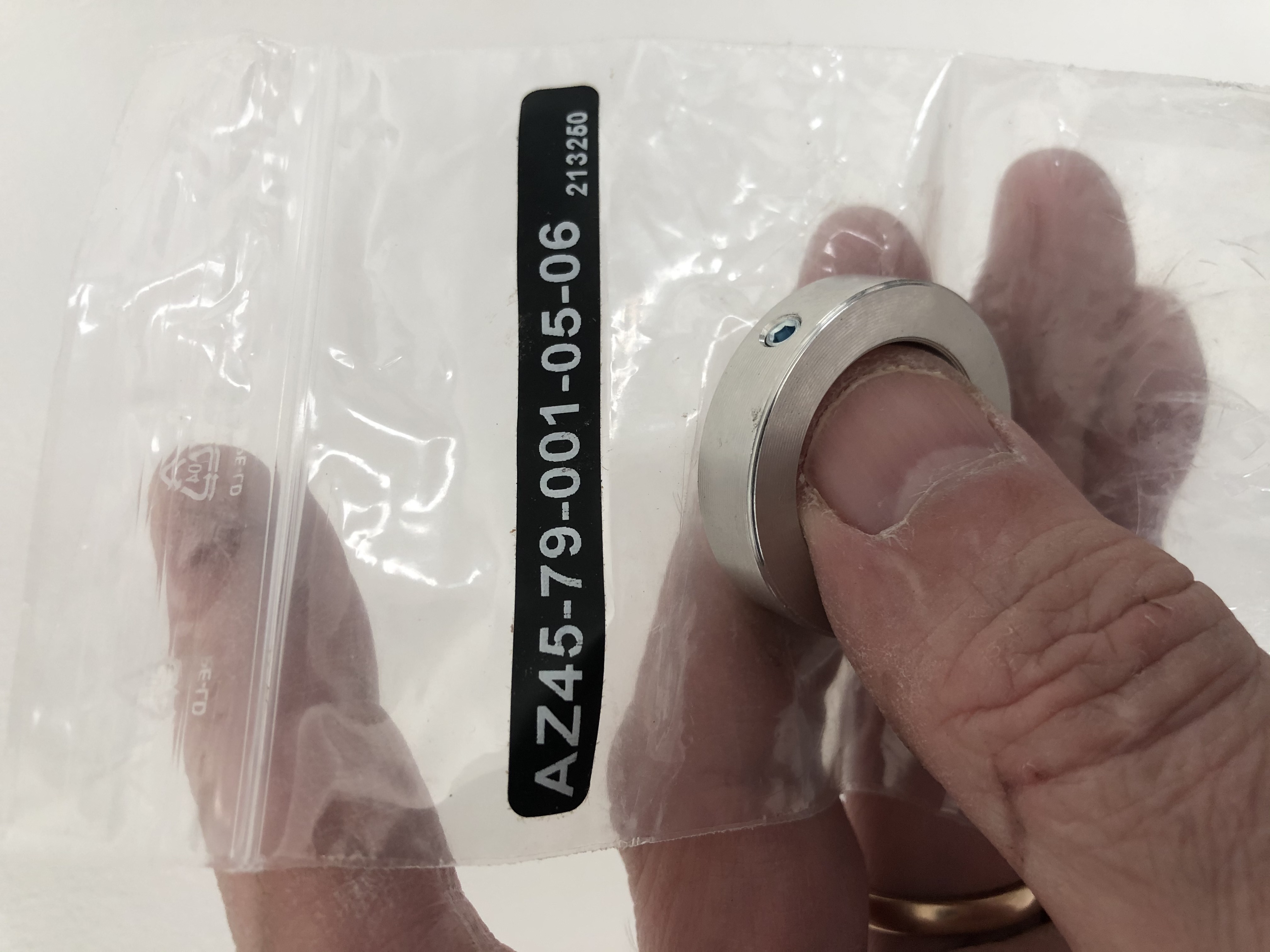

Also the Eibach kit came with some round metal pieces, that I did not fit. What is the purpose of those ? And what happens now that I left them out... :shock:

I think the metal parts you are talking about are spacers and the get used on some cars and not on others, remember that Skoda Fabia and SEAT Ibiza and VW Polo all use these parts, as will the Audi A1, and I do remember reading that some cars need these spacers and other don't - again, I've forgotten which one do and which ones don't!

Hi, I did the same upgrade as you and was also disappointed that the front of the car was a bit too low at the front, I was hitting my front spoiler everywhere. Eventually I sourced a set of 2015 GTi springs and fitted those instead to my Bilsteins. I ended up with a perfect ride and height at the front. The GTi springs are still firm but they have a nice compliency which the Eibachs didn’t have (more OEM feeling). The rear end went up a little more than the Eibachs but I will trim that down with the lower spring cups. Or you could leave the Eibachs on the rear.
The metal stops supplied with your kit can be used on the steering arm to restrict the lock if you need. On the Polo they were unnecessary and I left them out too.

Those metal rings MUST be installed between the upper spring plate and the little bearing.
They are spacers and allow the spring to be 1cm more compressed, so they work with the correct preload.
They make the front ~1cm higher, but most importantly they avoid any damage to the shock absorber's rod!
It is absolutely necessary to install those ring spacers with Bilstein B8.
I personally experienced problems for not installing them, so, trust me!

This is really interesting. Are we talking about the part(s) shown in my picture?
There was no instructions what to do with it and I was told it could be used on the steering rack to restrict the lock.
Now I could understand why the front of my car was 1cm lower than supposed to be with the Eibach/Bilsteins if I left these parts out.
Has no effect on me as I refitted GTi springs but this would be good info for the OP and others

Yes, I am talking about those rings.

Interesting !
As I think I did see a picture/instructions with those rings, and it did not show them to be fitted to the shocks.
But to somewhere in steering parts, propably like Shappers said too.
Hmmmm. I left them out too.... :oops:
Should I take the shocks out again.... :x

Found this when I googled with that number on top of that plastic bag in the picture :
https://www.bsr-tuning.fi/assets/pdf/ei ... 085024.pdf
