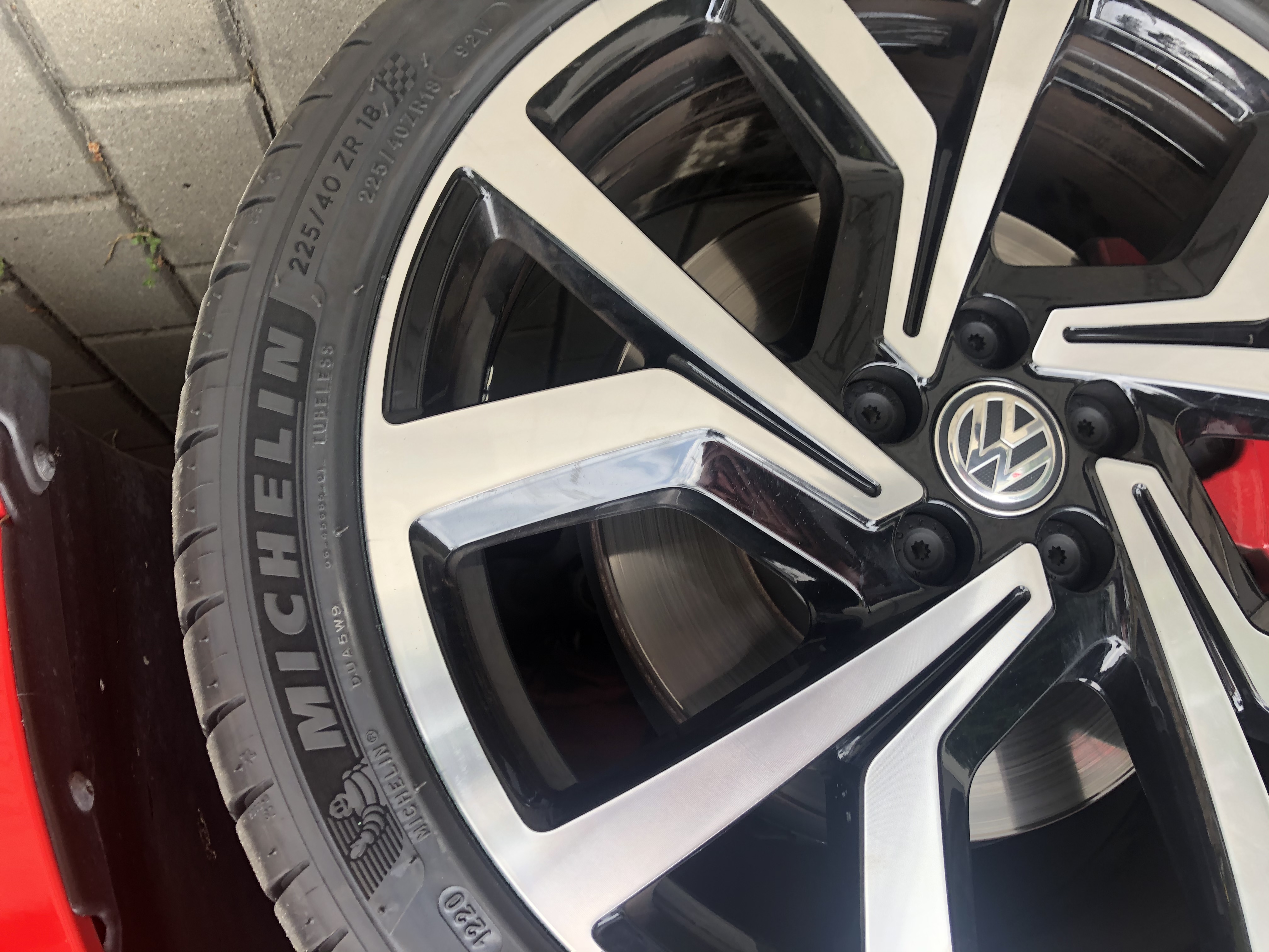

fazzy
Posts: 157
Drives: GTi++/TT/TDi/190E
Location: Vdbp.
Re: 215-40-18 or 225-40-18 tyres on Polo GTI
Post by fazzy »

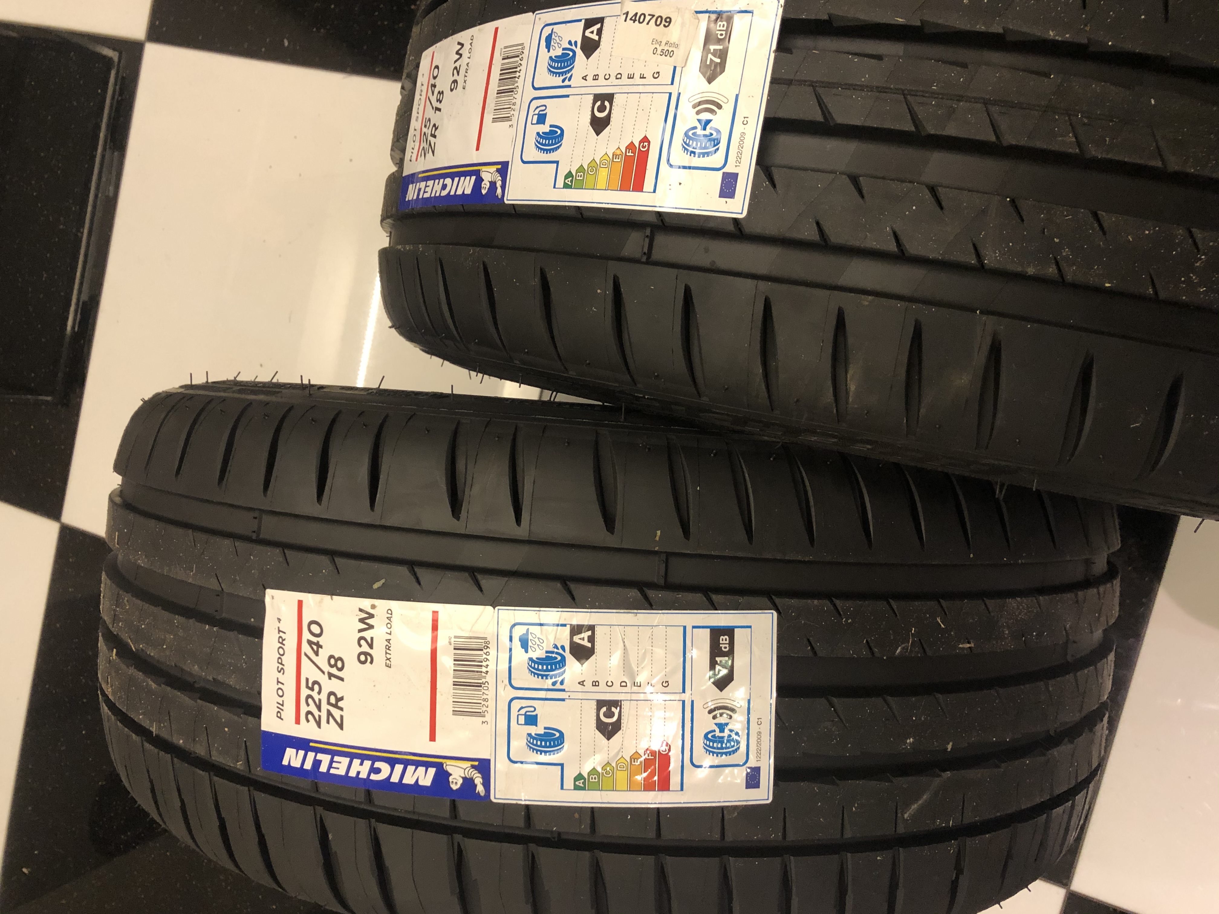

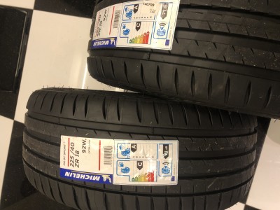

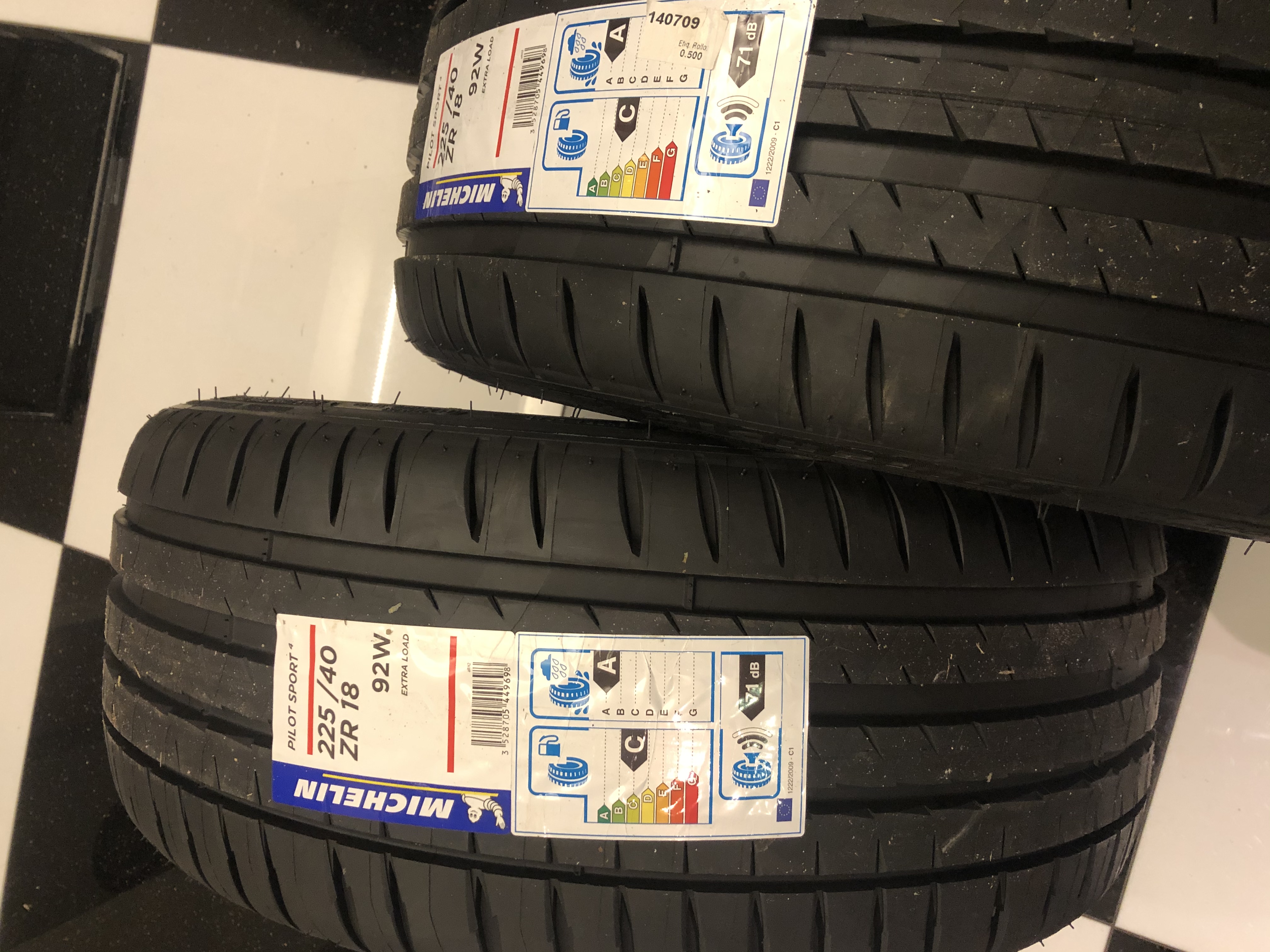

Just got mine.... :)
Hoping for some improvement :)
green justin
Posts: 143
Drives: 2019 Polo GTI
Location: South Africa
Post by green justin »
fazzy wrote: Mon May 11, 2020 8:02 pm Just got mine.... :)
Can you post more pictures a meter away?

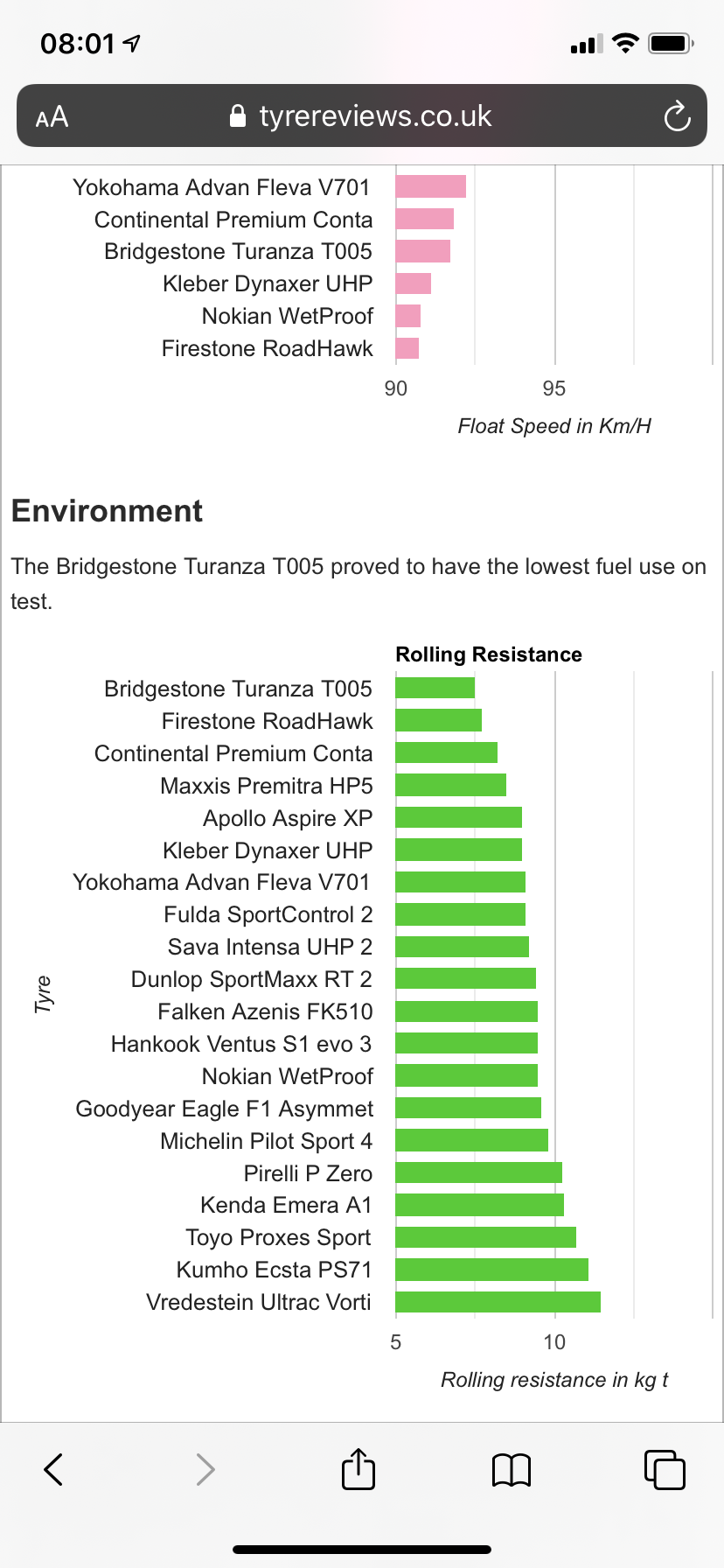

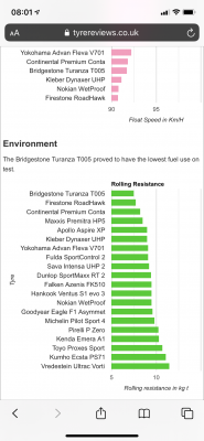

SRGTD wrote: Fri May 08, 2020 6:35 pm
It’s one of the trade-offs of swapping the GTI/GTI+ Bridgestone Turanzas - which are a ‘hard as nails’ tyre like with poor grip and low rolling resistance - for one with much better grip and higher rolling resistance like Michelin’s PS4. A stickier tyre like the PS4 won’t roll as freely over the road surface, which will have a negative impact on fuel consumption compared to the Turanzas - borne out by the official fuel consumption ratings; Bridgestone Turanza T005 is ‘B’ whereas the Michelin PS4 is ‘E’. However, as you’ve said, steering feel and grip are much improved with the PS4 compared to the Turanza.
I actually had the Bridgestone Turanza T001 on my GTi and that seems to have identical rating of C and A as the Michelin PS4 with the Turanza 1 dB noisier...
Then again... it's all lab results :)

fazzy wrote: Mon May 11, 2020 9:54 pm
From tyre reviews, the labels are mid-leading
