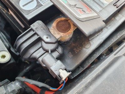

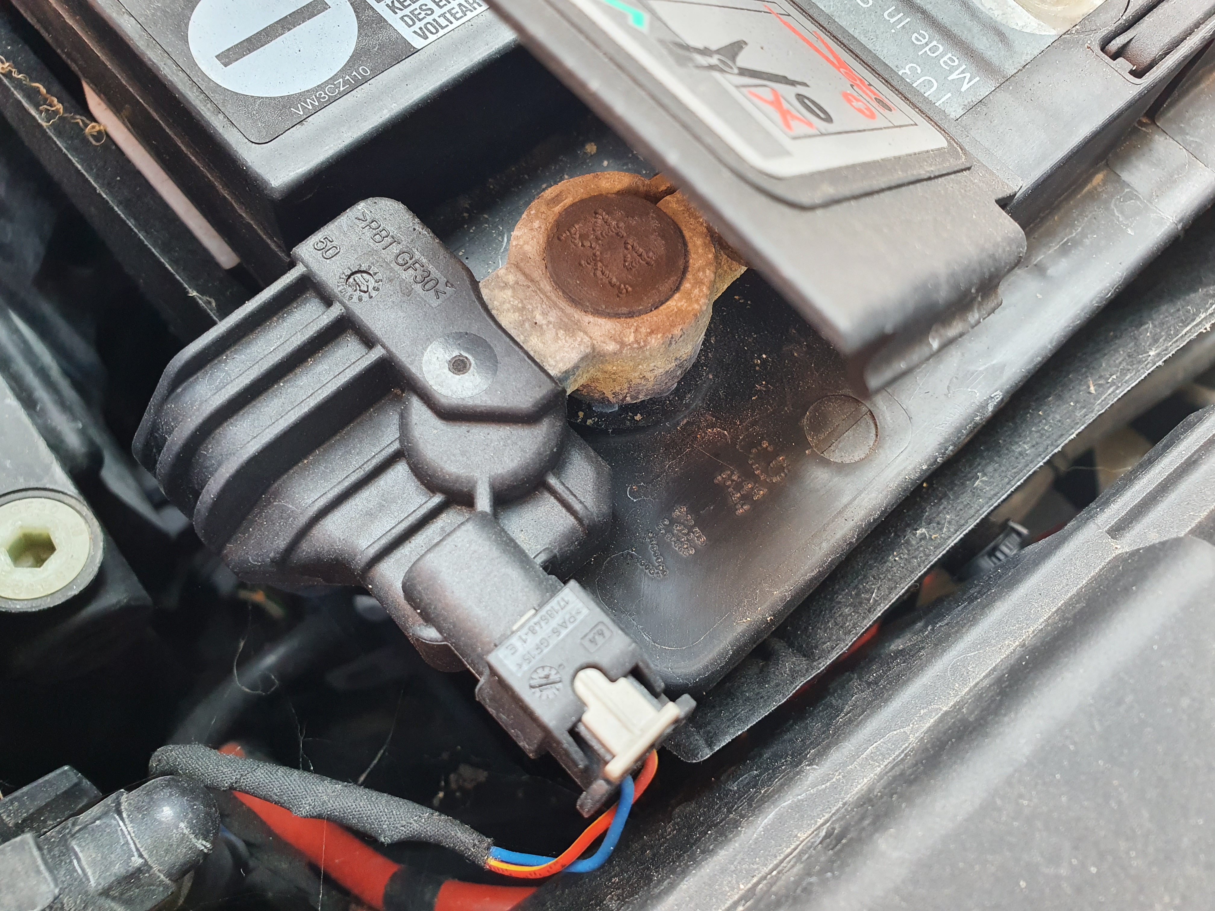

Noticed on my BlueGT that the negative terminal is stamped with 34 and 14. I'm assuming that's week 34 of 2014 which would be about right for the car if its still the original battery.
Thinking its perhaps time to think about changing it. Might try and go AGM instead of the EFB type.
Anyhow, anyone else have their battery stamped like mine or know what it may represent? (if my guess is wrong). 8)
Posts: 6686
Re: Negative battery stamp
Your guess is correct

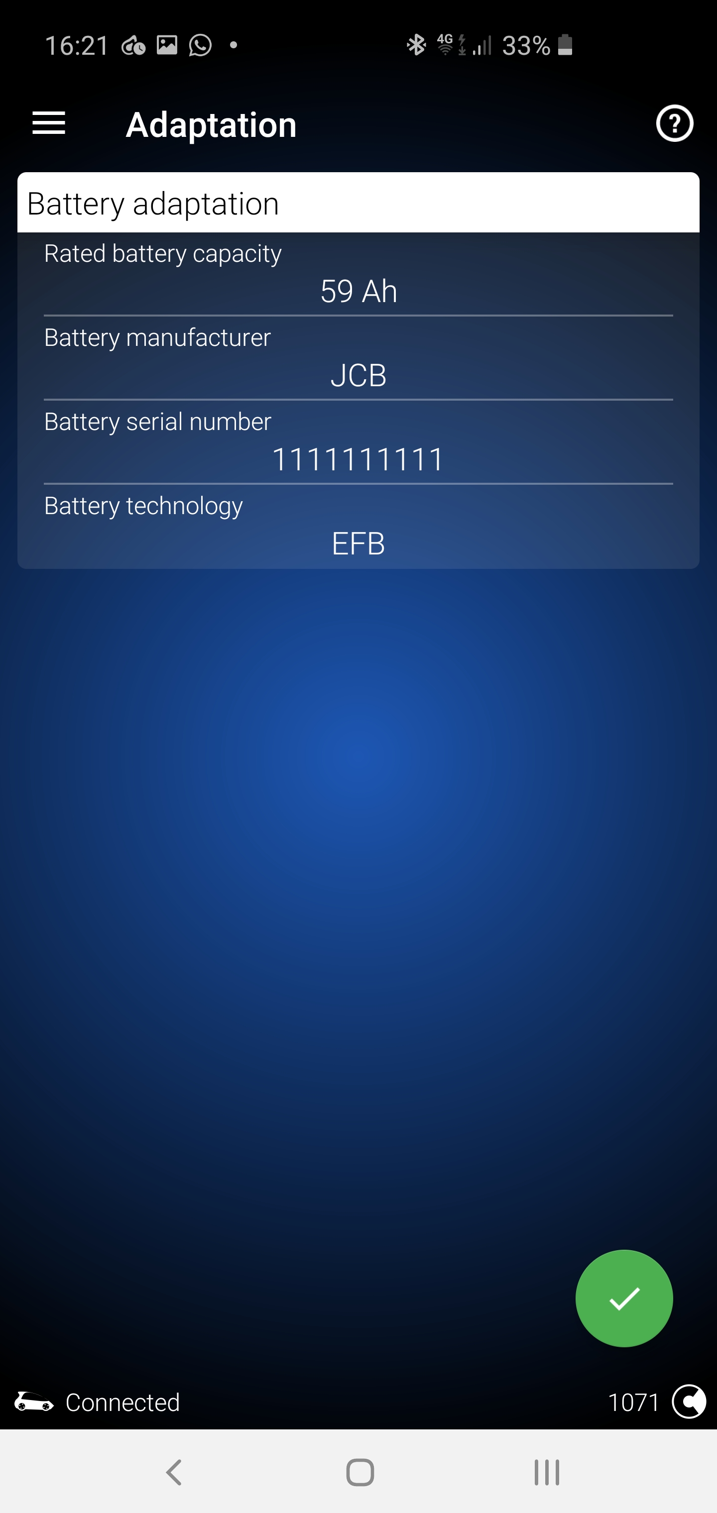

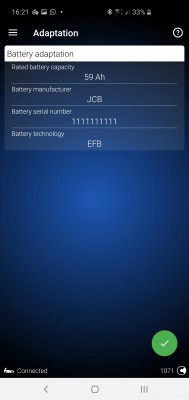

Thanks. Had a look at the battery settings and it would also suggest it's the original (see image).
Given that it's 6 years down the line (nearly) I'd rather opt for preventative maintenence rather than reactionary so a new battery is on the cards.
Anyone know if there's anything to be gained from shifting from EFB to AGM? I know on my Renault Captur the factory EFB battery was generally regarded insufficient for its needs and an AGM "upgrade" was a better performer in electrical reliability. Different car and brand altogether I know, but principals may still apply.

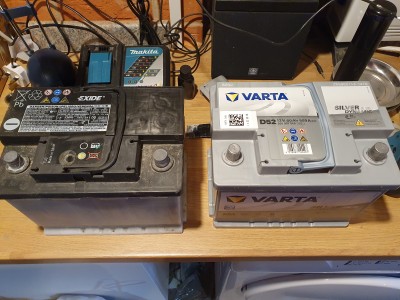

Just ordered a Varta D52 027 AGM battery through Tayna. Did look at the E39 but it won't fit my battery tray which is pretty much maxed out at a battery size of 242x190x170 (type 027).

Changing the battery tray and insulator for the diesel version would have worked, but that costs another £50+ - I've already bought these parts but the bigger AGM for the diesel is cheaper, that is what IU aim to buy when the time comes.
Its slightly curious how/why VW SA use 1111111111 as the default serial number and JCB who are Johnson Controls as the battery manufacturer when typically they fit Exide.
Good to hear that you chose Tayna as that is my going to be my supplier of choice.
I'm guessing that you plan to change the battery technology to "Fleece" from "EFB" when you fit that AGM and change its serial number to something to maybe include the date when you fit it.

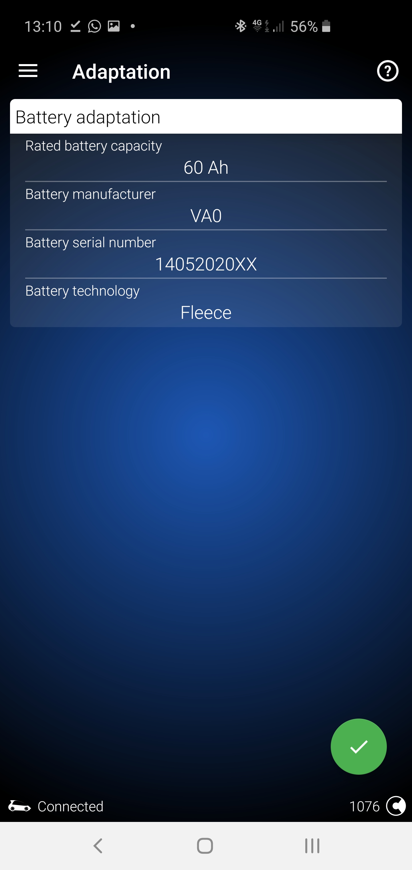

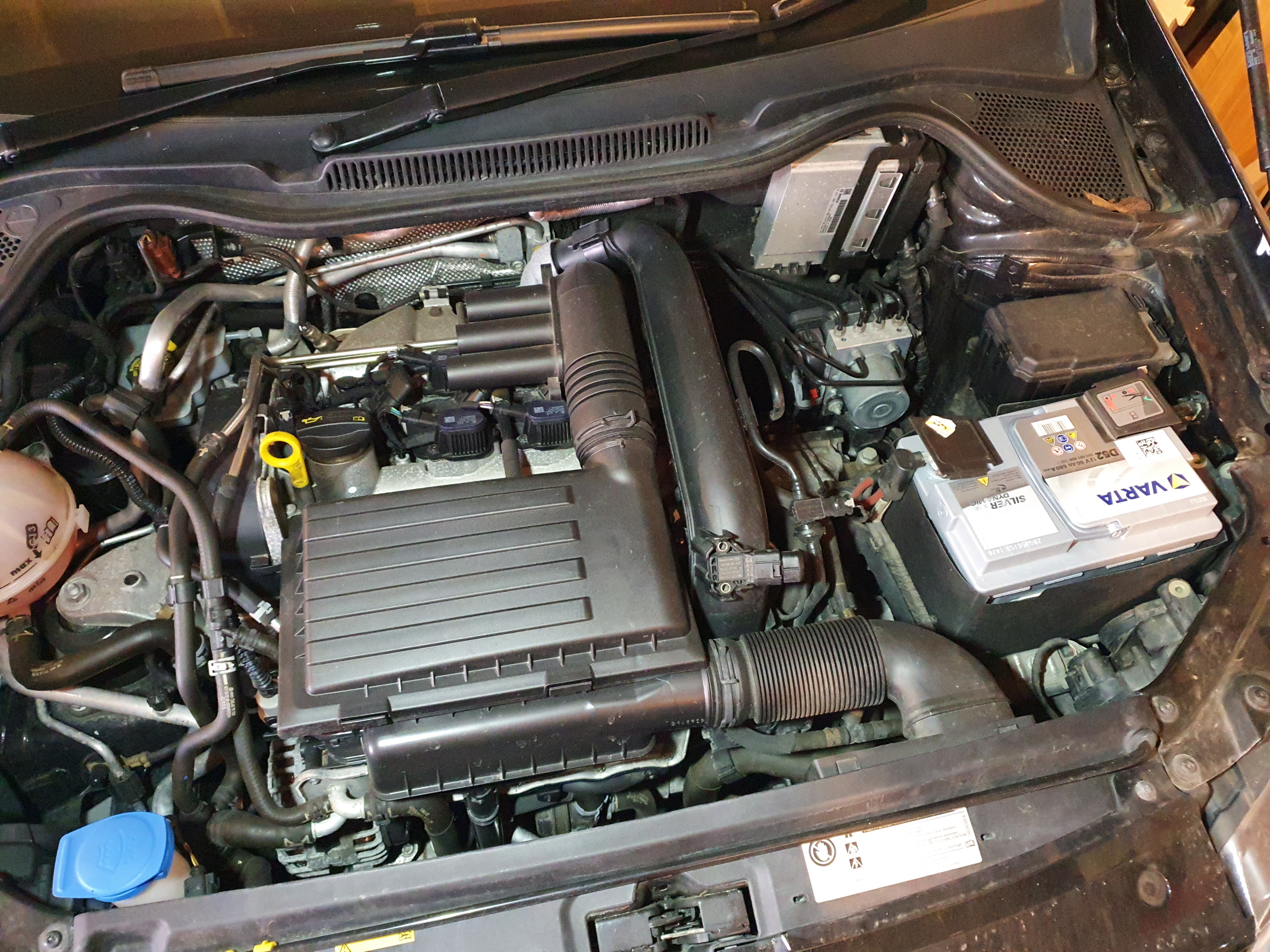

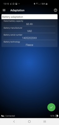

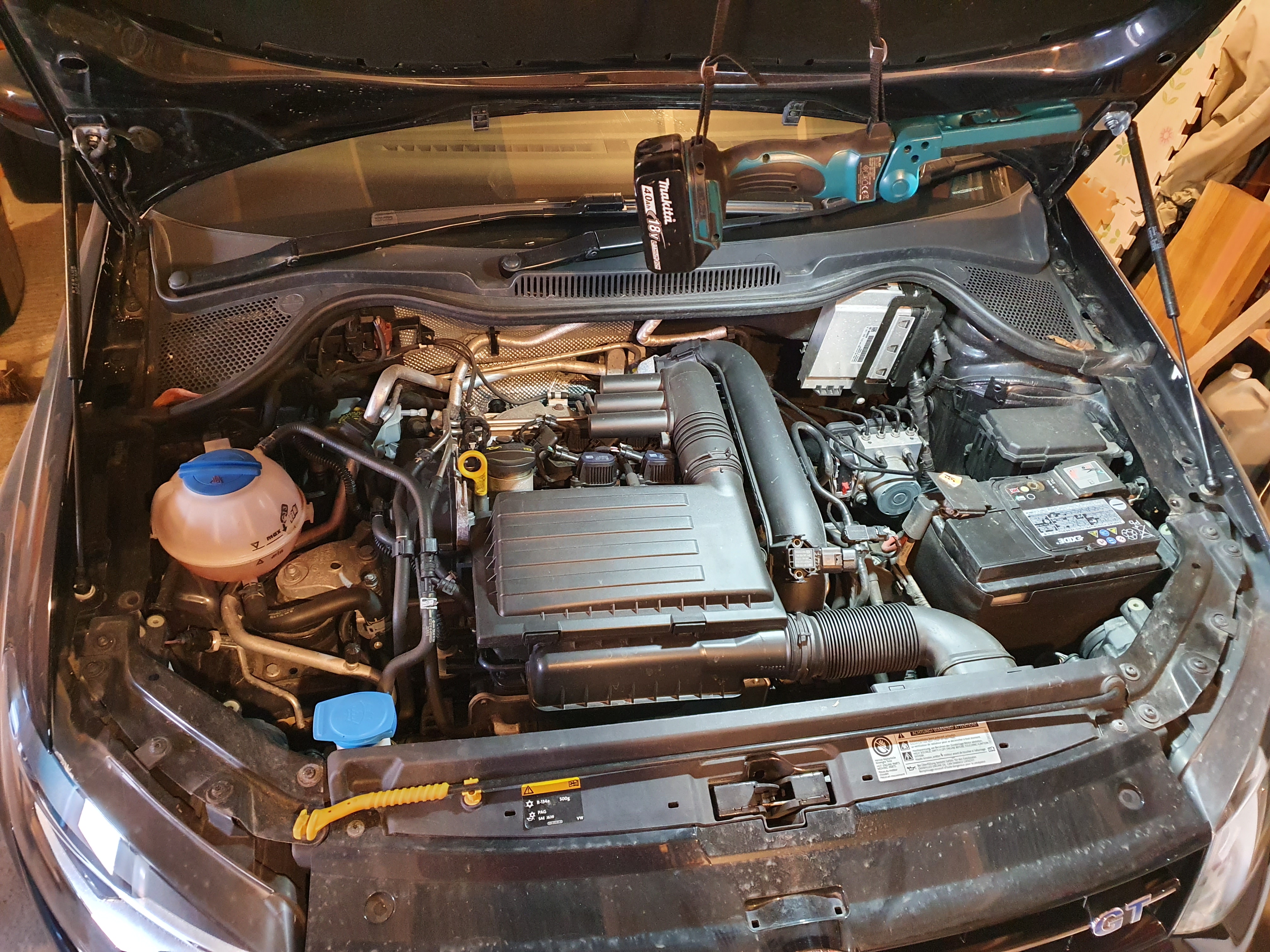

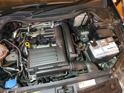

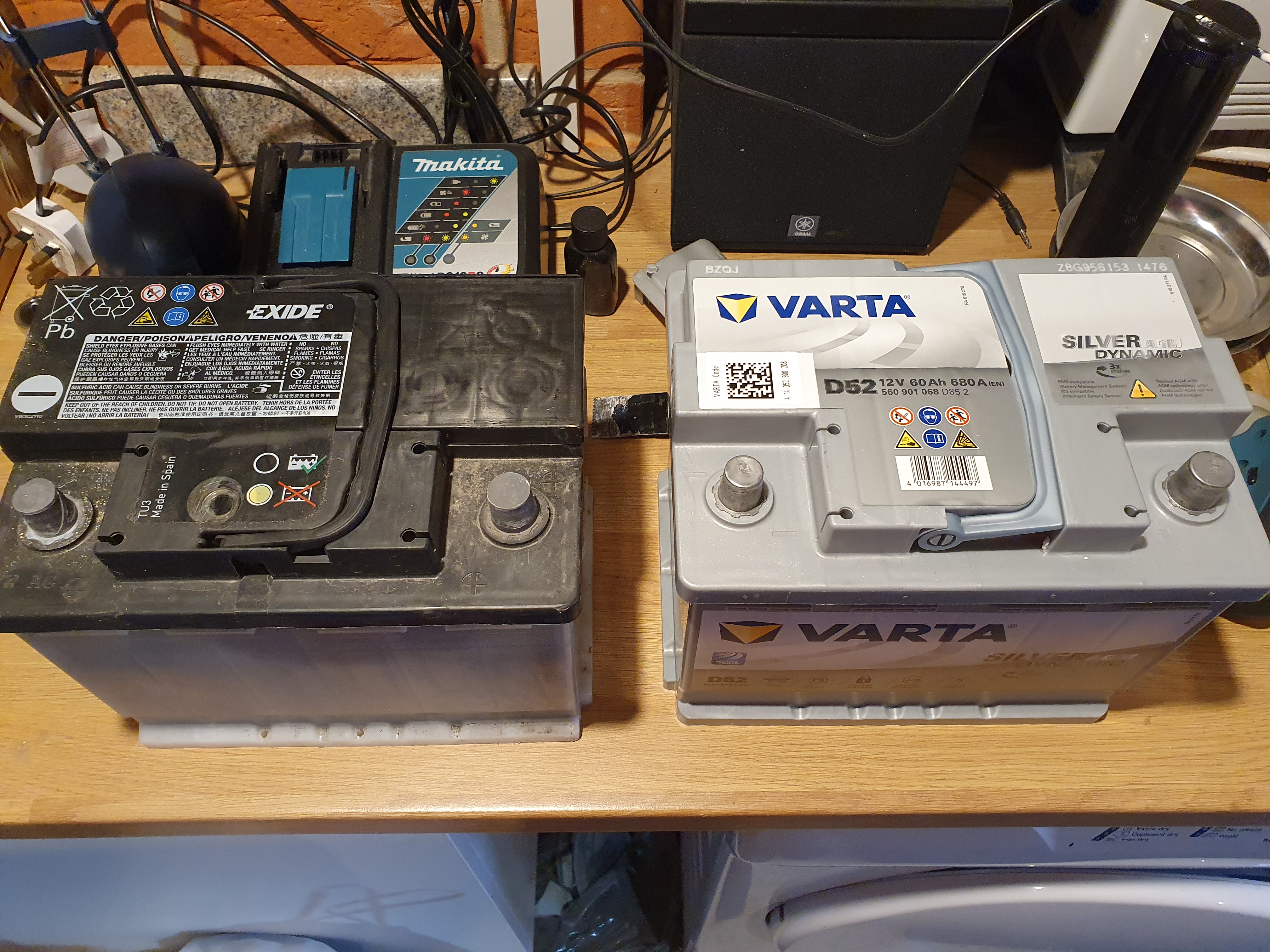

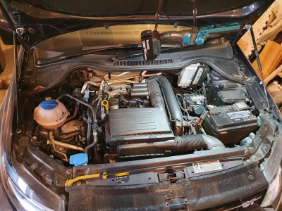

So it was relatively painless to change over. No issues apart from Obdeleven at first didn't want to update the new details so had to restart the app.
The only area of concern was whether it should be set for "fleece" or "binary-agm". Looking online, there's arguments for either option. For now I've gone with Fleece.
Recoded
Recoded
After
After
Old (left) and new (right)
Before
Before
