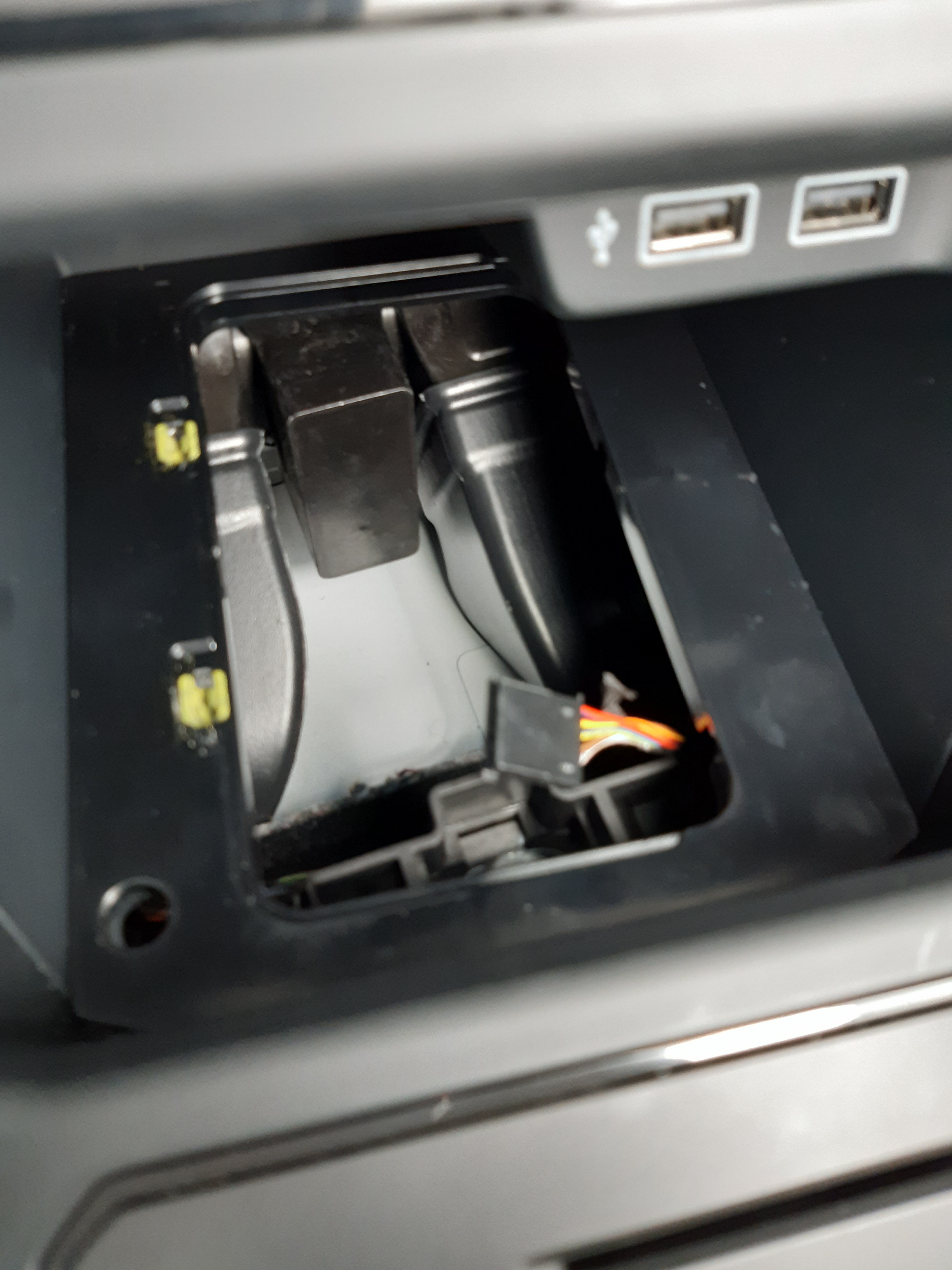

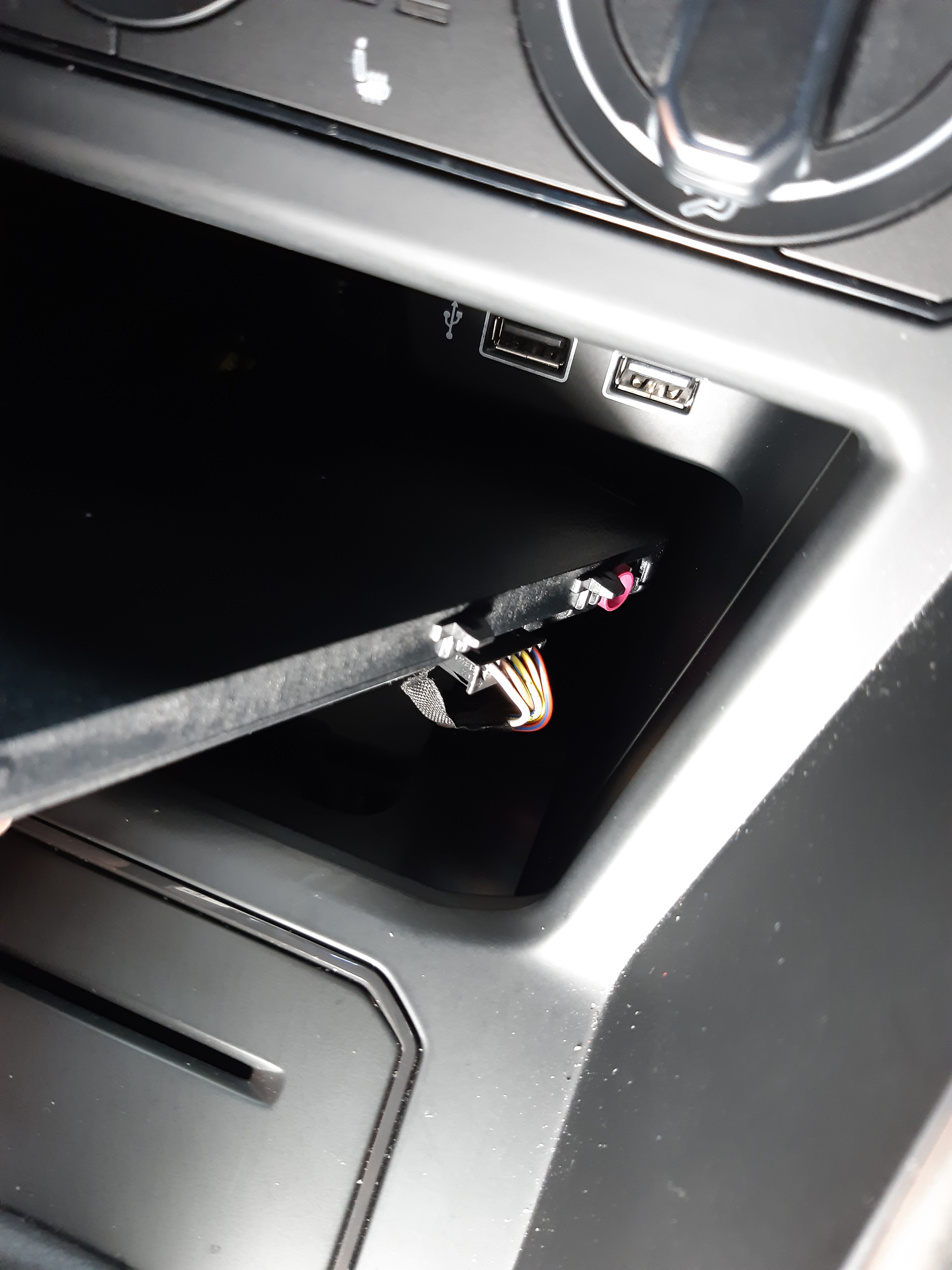

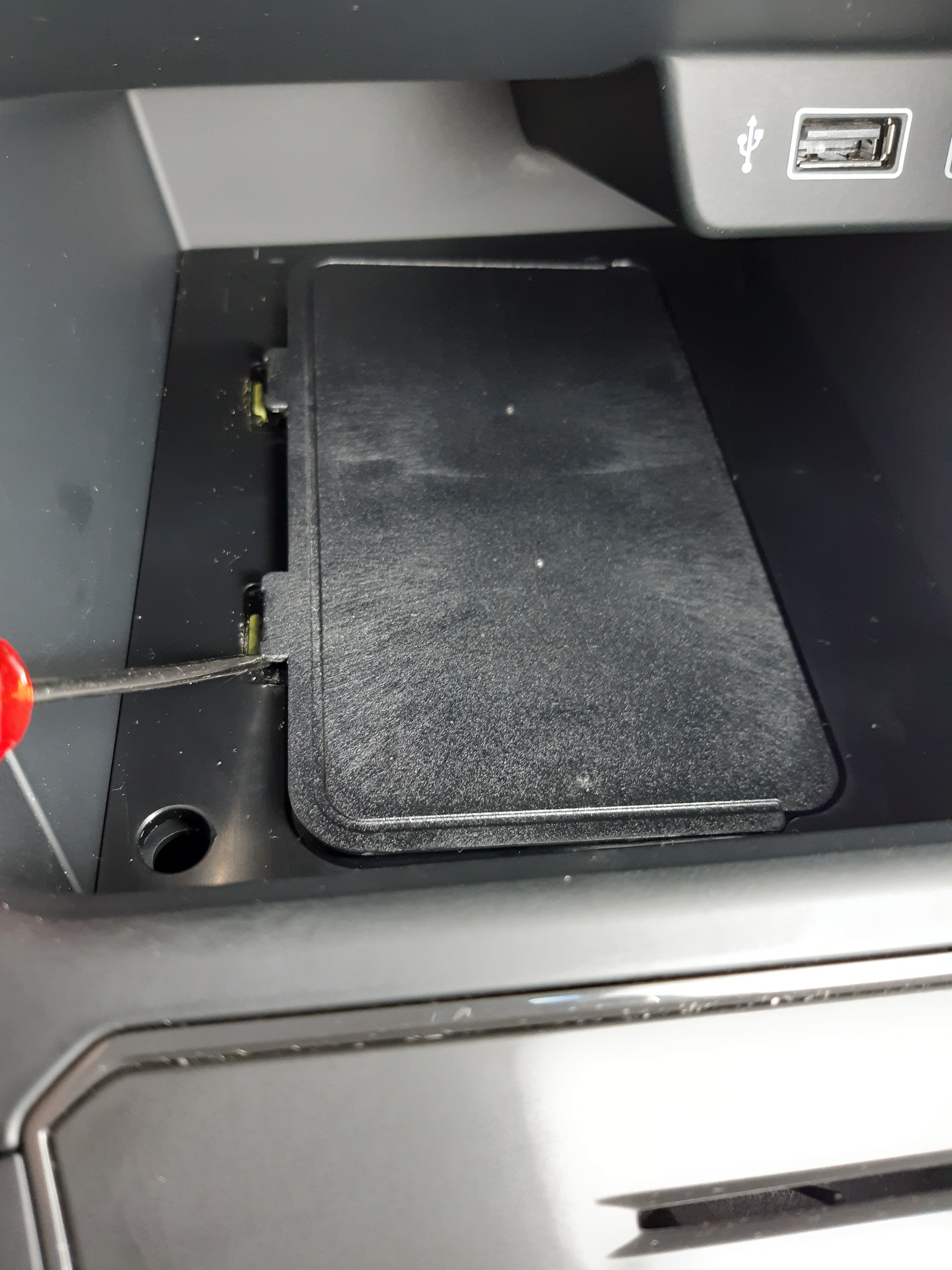

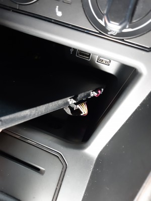

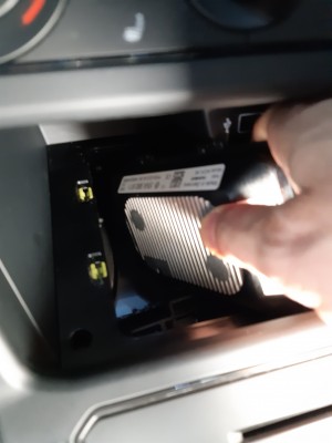

Re: Is it possible to turn off the wireless charging pod?

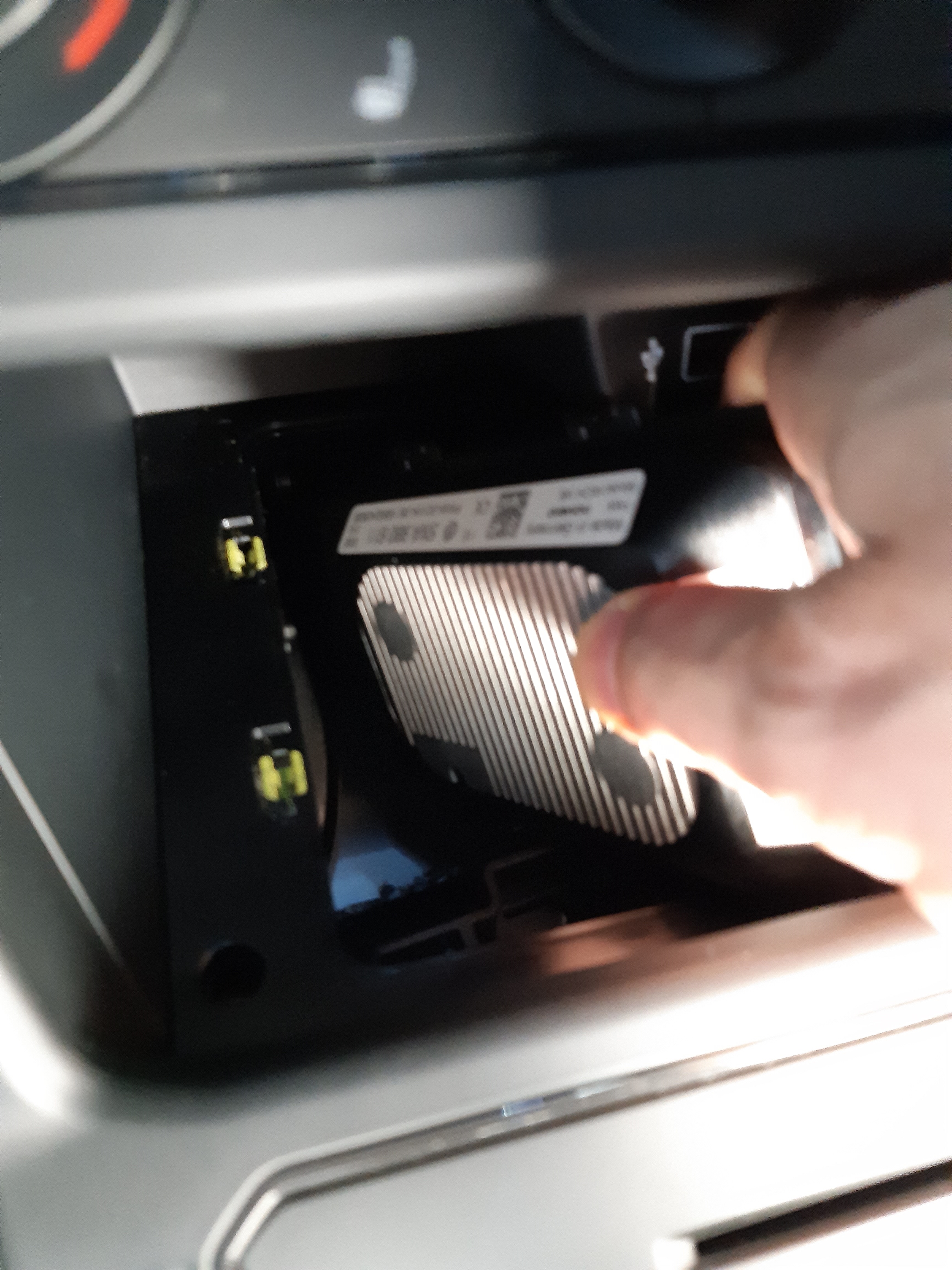

Hi you can turn it off I turned my off.grim007 wrote: Mon Apr 27, 2020 1:45 pm Hey
Since I use the cable with android auto I would like to disable the wireless charging pod.
That way I can actually put stuff there without it getting warm/hot.
I tried looking through the menus, but wasn't able to find the setting anywhere.
Anyone knows if its possible to turn it off?

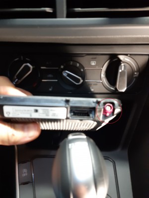

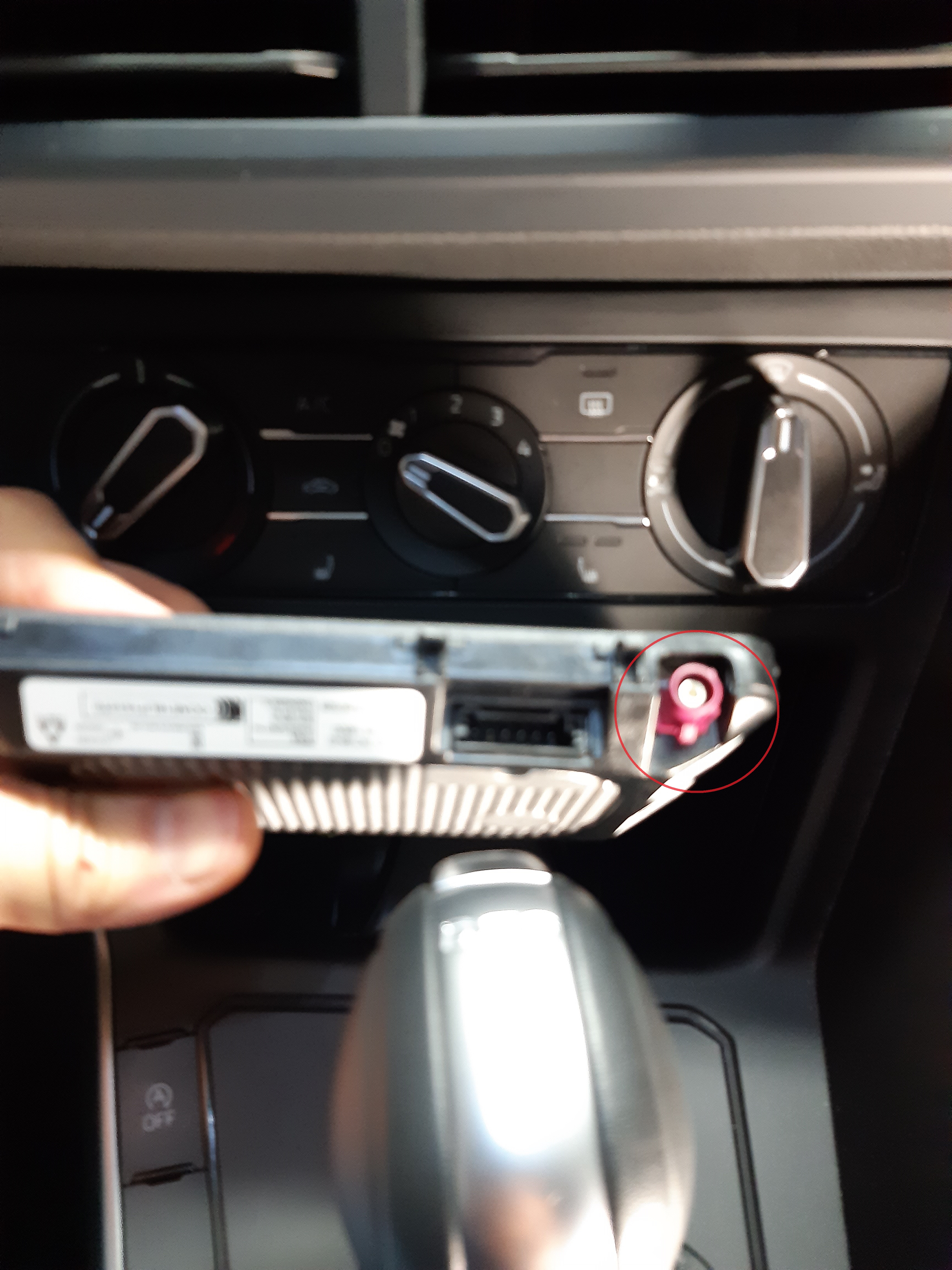

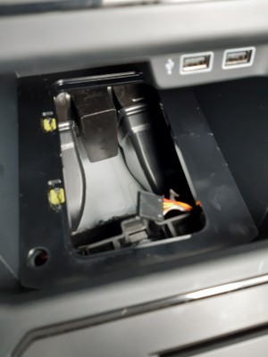

Does anybody now what is this plug for?
- Posts: 6694
Looks like a cellular antenna if I had to guess
- J+silva
- Posts: 119
- Joined: Fri Aug 09, 2019 5:53 pm
- Drives: polo conf.
- Location: Lisboa

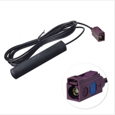

You are correct I found this information 4g and 3g gsm antenna.I have already order one let´s if it improved the gsm signal.
I´m going to keep the wireless charger off I hope this problem doesn't happen.
Today the antenna arrived I connected it but I didn't notice any improvement in the phone reception the screen had 3 lines and after connecting the antenna it continued with the three lines, does anyone know if it is necessary to activate some function with obdeleven?
