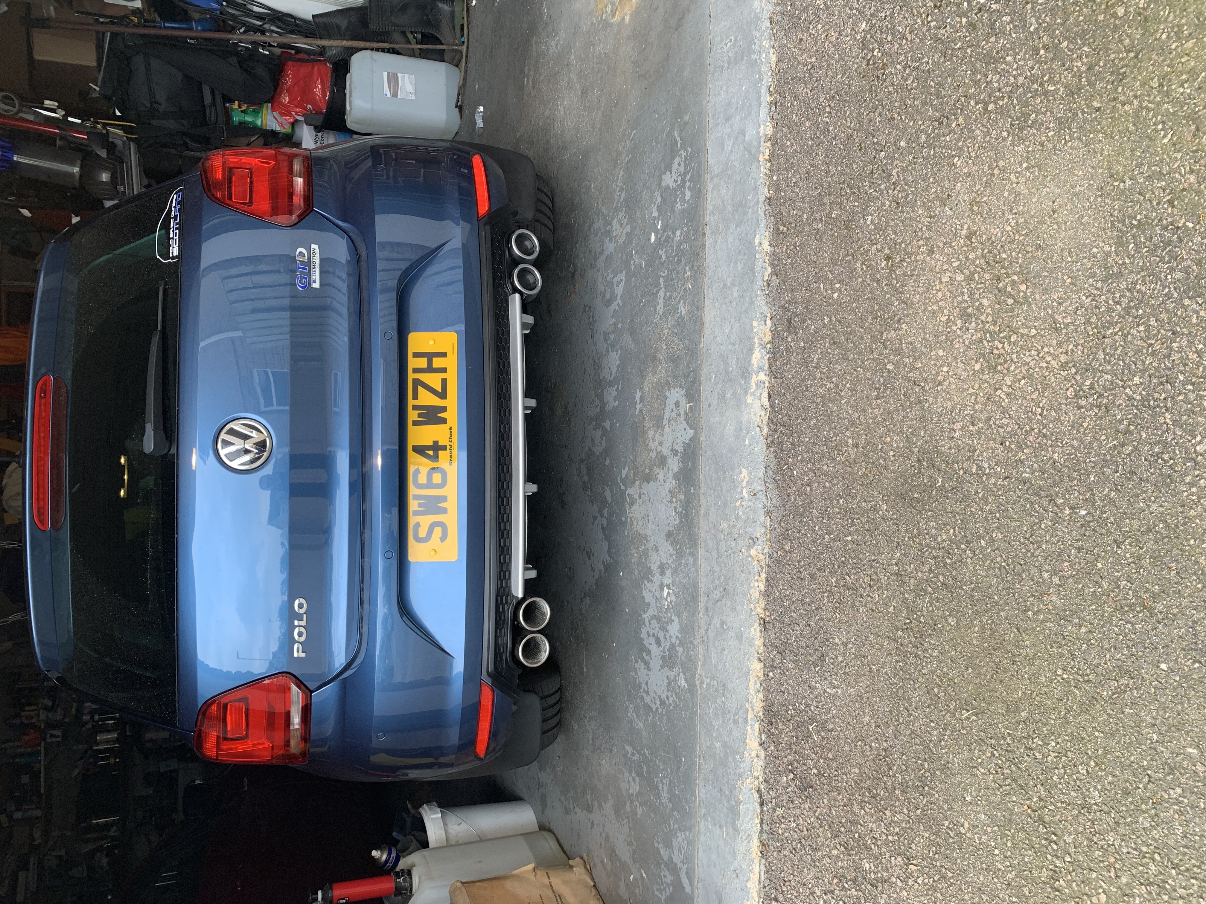

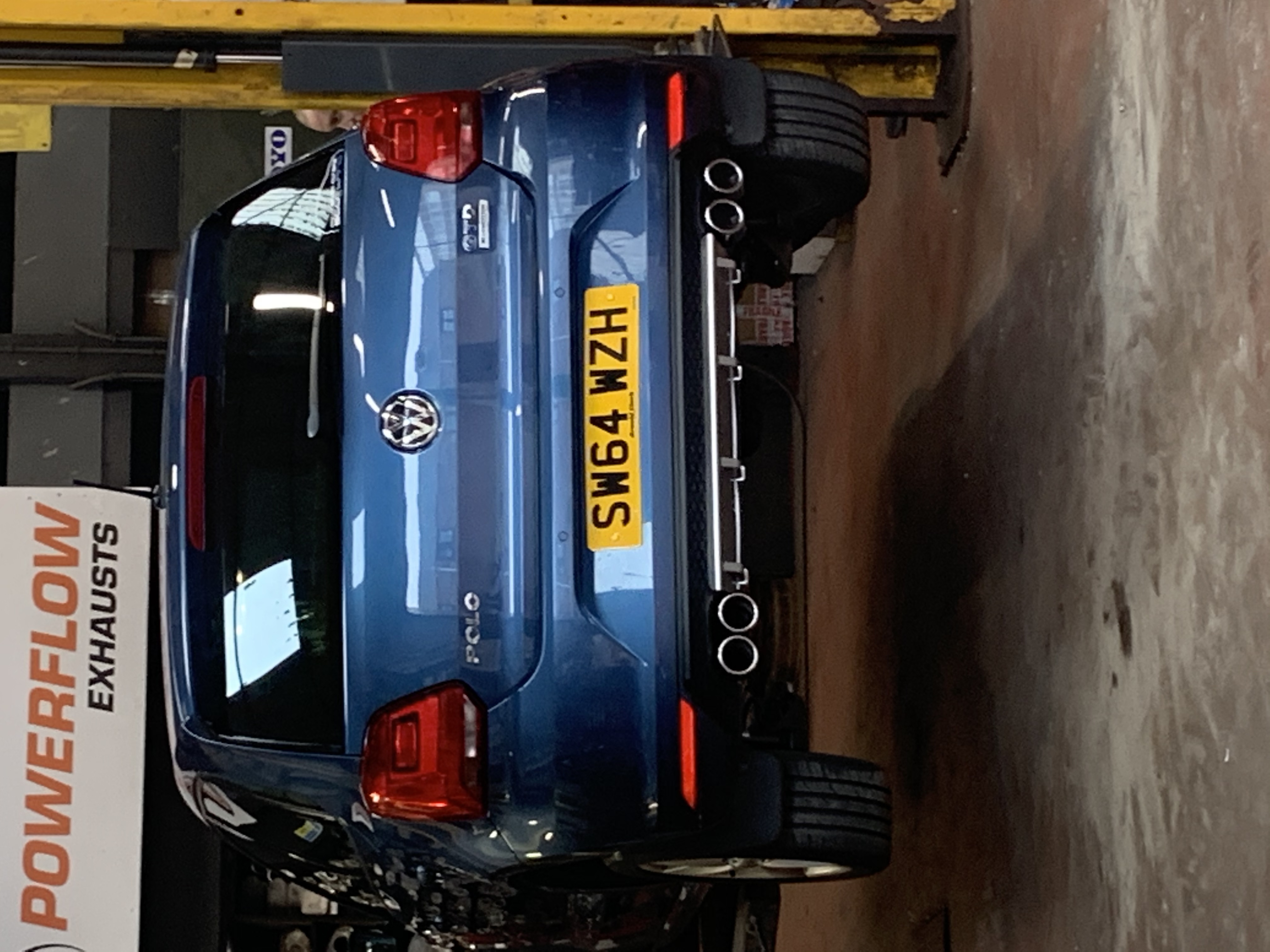

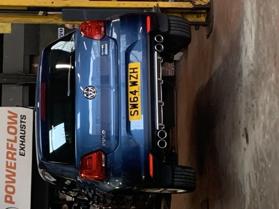

For the newer 3 cly diesels 1.2 and 1.4 just get stainless full system from the exhaust flow flap valve back, gives better low torque response on standard. Ap, got full system built on car Powerflow dealer £269, for an additional £100 the can weld in new stainless flex using the clamp flange for connection to the DPF, and retro fit the exhaust flap control section as well.
Ends up looking good with dual outlet
