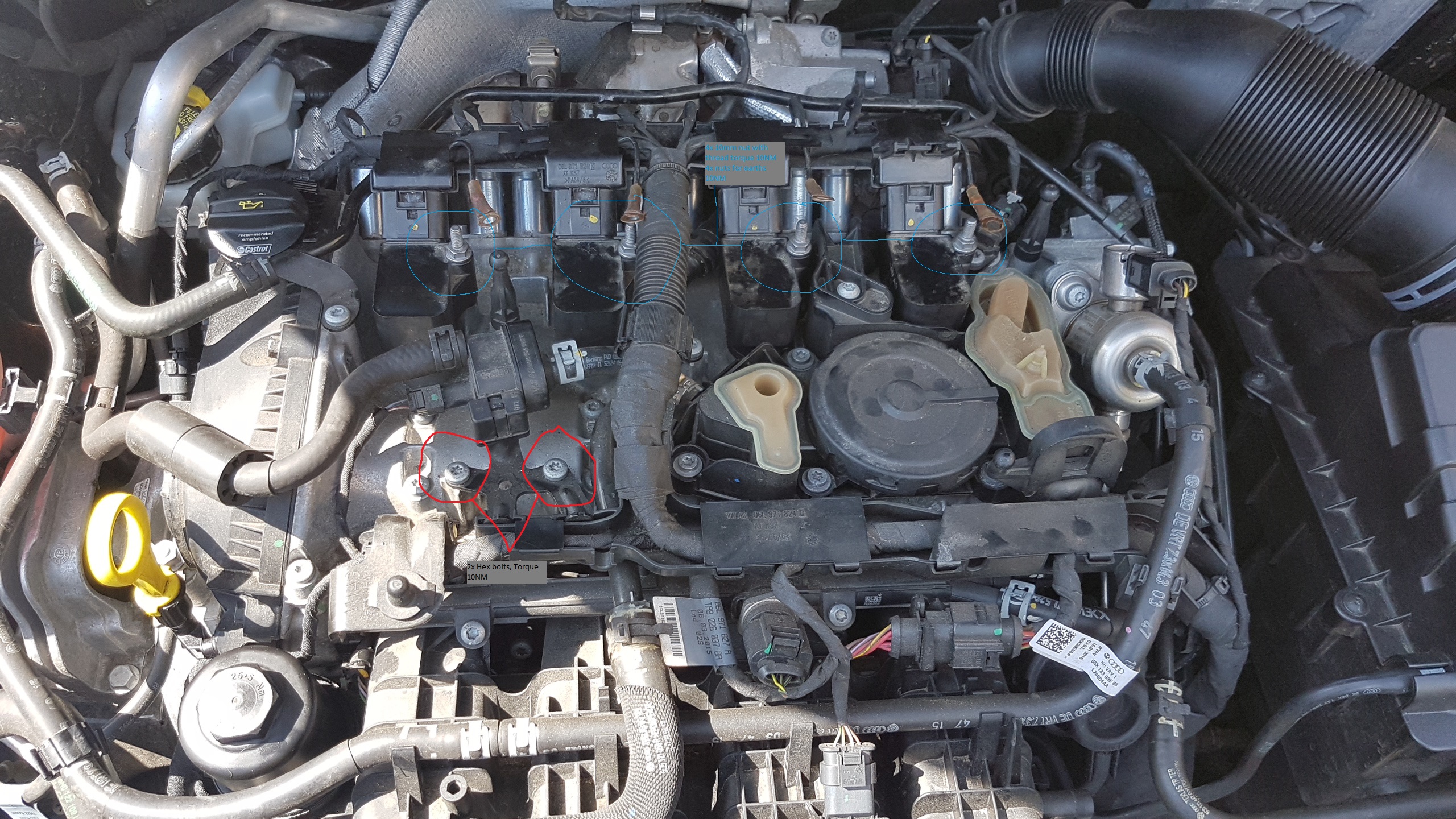

Right I managed to get the time to do me service an on changing me spark plugs, wanted to put some useful info here.
To removed the spark plugs I noticed the ing coils were held down so linked and got the correct torque settings.
At the bottom the 2x hex bolts I removed to give me some slack on the wiring to the ing coils, I could not find any torque setting so went for the same as the the nuts 10nm. The torque setting I used for the spark plugs was 30NM

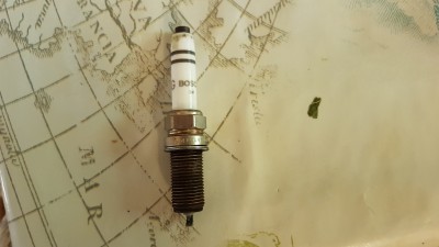

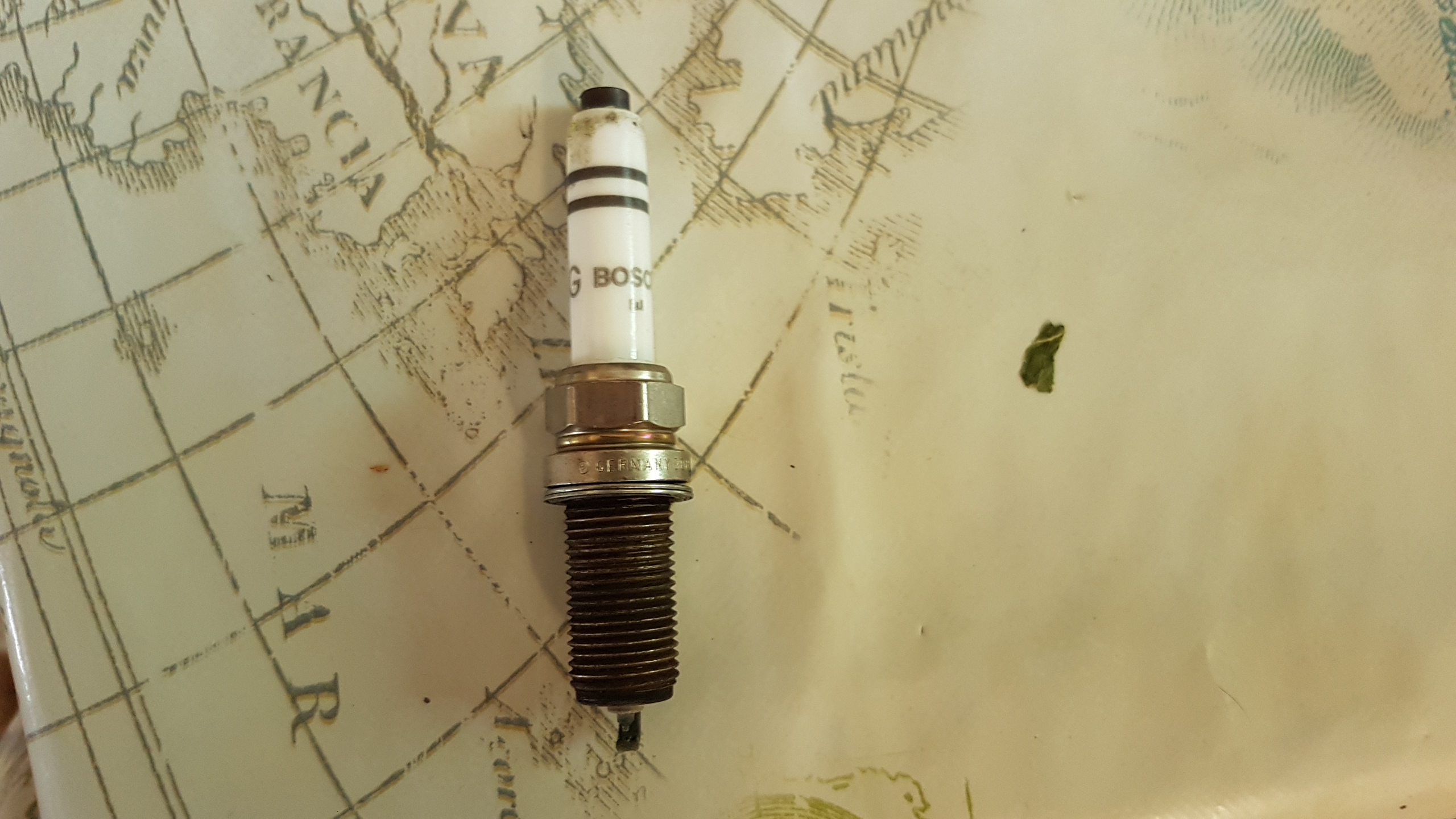

Here a picture of 1 of the plugs I removed, sorry it's taken so long
Posts: 6089
Re: 6c GTI service questions
TrebleTA wrote: Fri Jul 31, 2020 5:28 am Here a picture of 1 of the plugs I removed, sorry it's taken so long
Ah yes, the ones with the concave HT contact point.
I see that your Bosch plugs had a crushable sealing washer, did your new NGK ones have that as well, or a thick solid copper washer?
