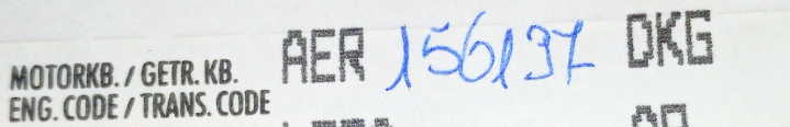

Need to know your engine code please to find the seal you need
Re: Help please ....
Polo 6n1 1.0 50 PLalexperkins wrote: Mon Aug 19, 2019 9:36 am Need to know your engine code please to find the seal you need
did I write the wrong code ? is what you needed ? thanksalexperkins wrote: Mon Aug 19, 2019 9:36 am Need to know your engine code please to find the seal you need
Sorry, been really busy with work
The seal is N906 175 01
The whole seperator inclusive of the seal is 036 103 464 G. Febi make an OE quality replacement with part number 38773
