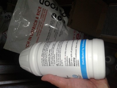

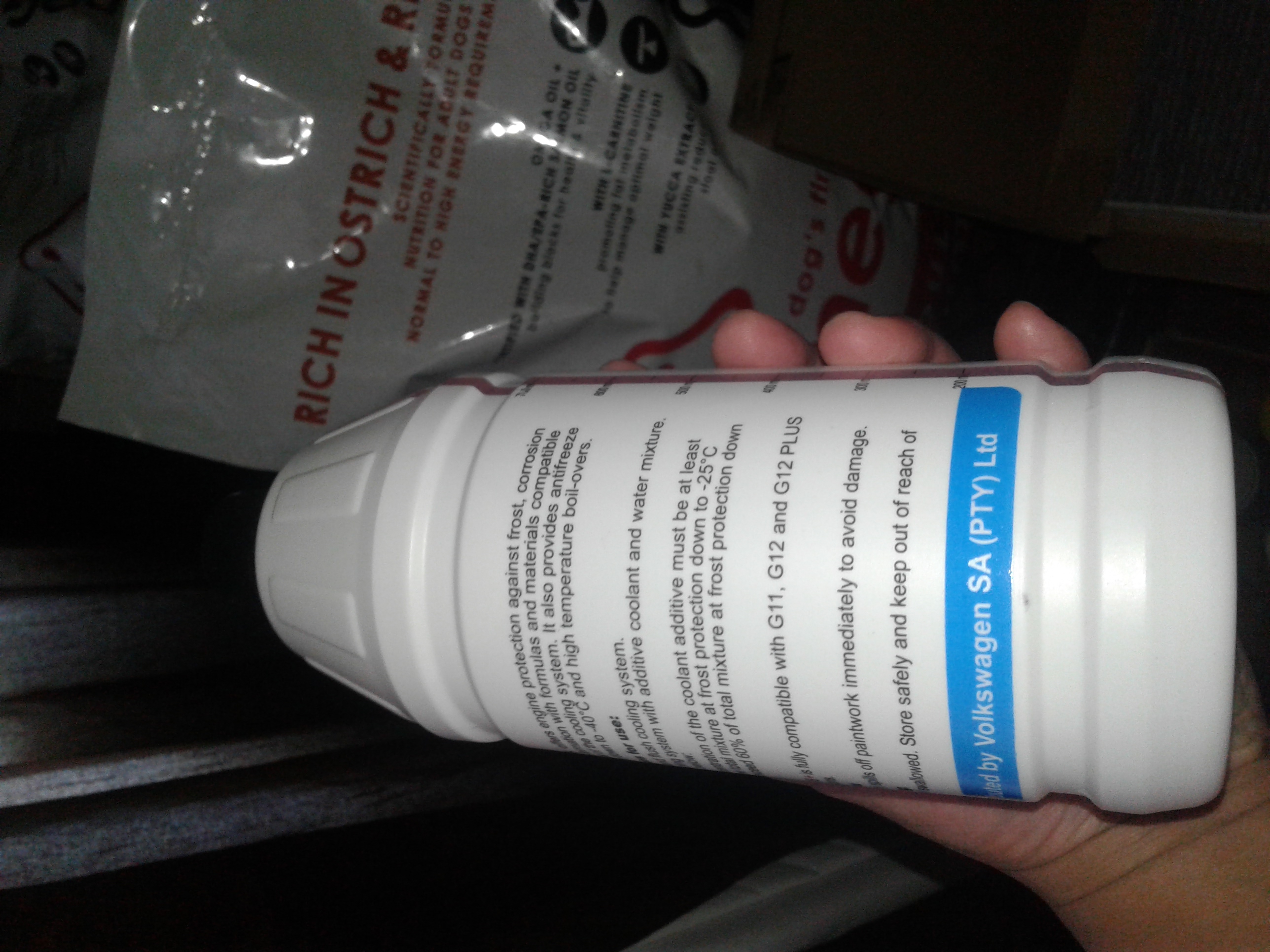

Hello,
I go to the local VW dealer today to buy some coolant, and they give me this "G13 PLUS+" coolant.
Anyone seen this "G13 PLUS+" coolant before?
Is there any difference between "G13 PLUS+" and "G13" coolant?
Thanks.
Thanks.

- Posts: 6085
Re: What is "G13 PLUS+" Coolant???
Wow compatible with G11, G12, G12PLUS - no mention of G12PLUS PLUS or G13 or G12 evo, curious, strange or just an omission?

Remember the topic here is "what is G13 PLUS+" - and the OP picture was of coolant additive, ie conc.

I agree with you on this, it doesn't make sense that they develop this G13 PLUS+ coolant and only sell it in South Africa.
I think slowly other countries will also see this G13 PLUS+ coolant.
(This G13 PLUS+ is cheap, about £4.5 for 1L. And it is a concentrated coolant (coolant additive), not the premix coolant.)
I asked the same question on the Ross Tech forum, a guy who just left VW 6 months ago also said he never seen this G13 PLUS+ coolant before.
So, this G13 PLUS+ could be something that is been introduced recently.

Yet another posting on this, I have a bottle of G12PLUS and a bottle of G13, both these bottles are 1.5litres and the final 2 identifiers of these bottles is M1 which will be VW Group's method to make the capacity and form of the bottle part of the part number - they are both rectangular in section.
In the case of this bottle of G13PLUS + the last 2 identifiers are T1 which could conveniently be VW Group's method of describing a 1.0litre bottle which is round in section.
My VW Group G13 has the part number G013 A8J M1, my similar VW Group bottle of G12PLUS has the part number G012 A8F M1 both in rectangular section 1.5litre plastic bottles. OP's VW Group G13PLUS+ has the part number G013 A8J T1.
Going by that, if any of my logic is correct, then your G13PLUS+ looks to be the same as my G13 - but that does nothing to explain why one is called G13 and the other is called G13PLUS+.
