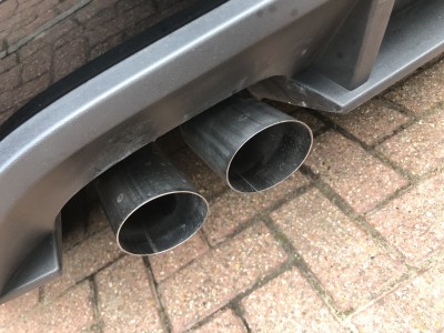

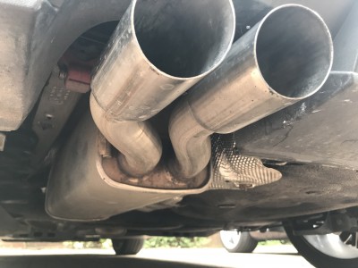

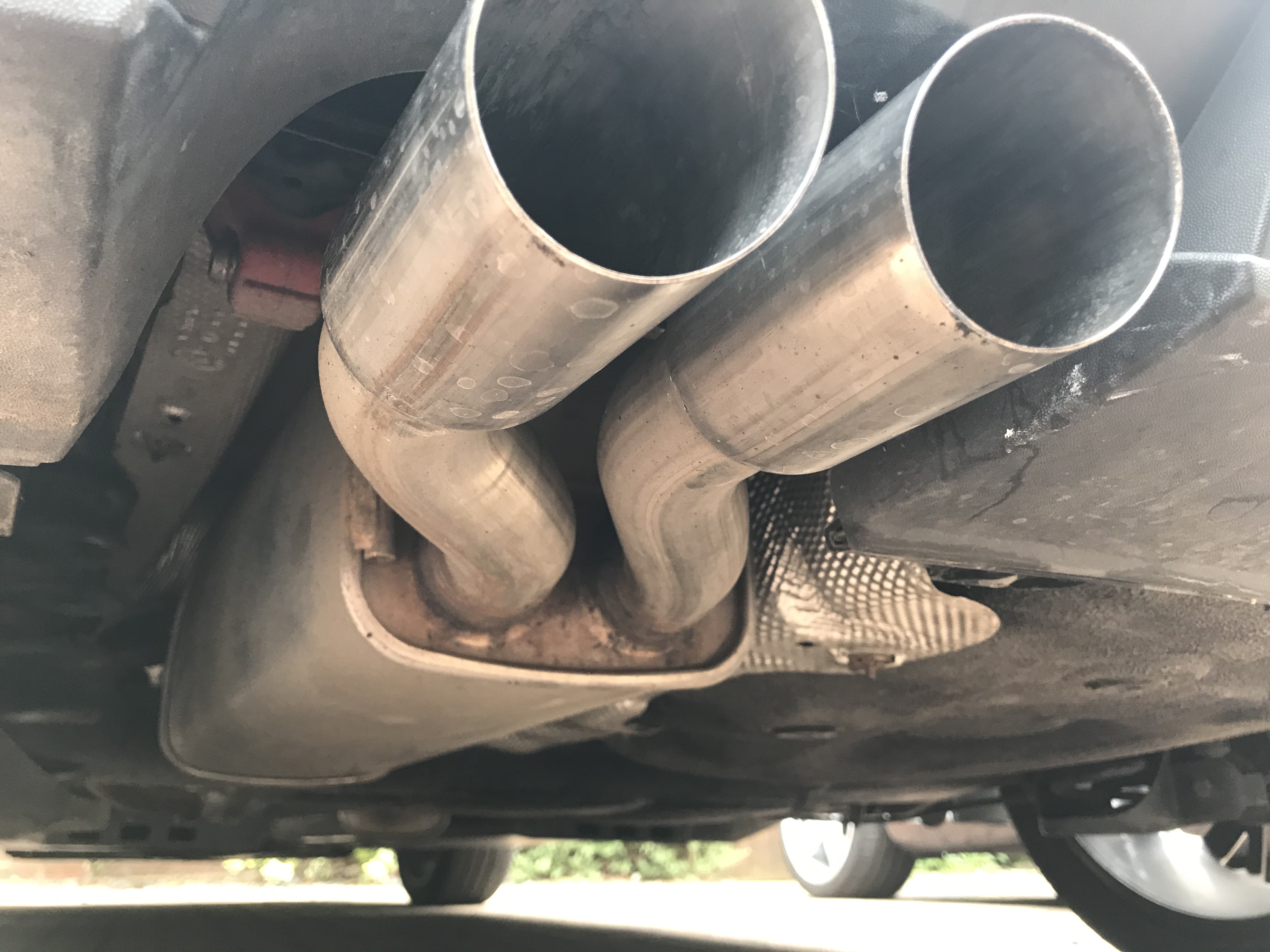

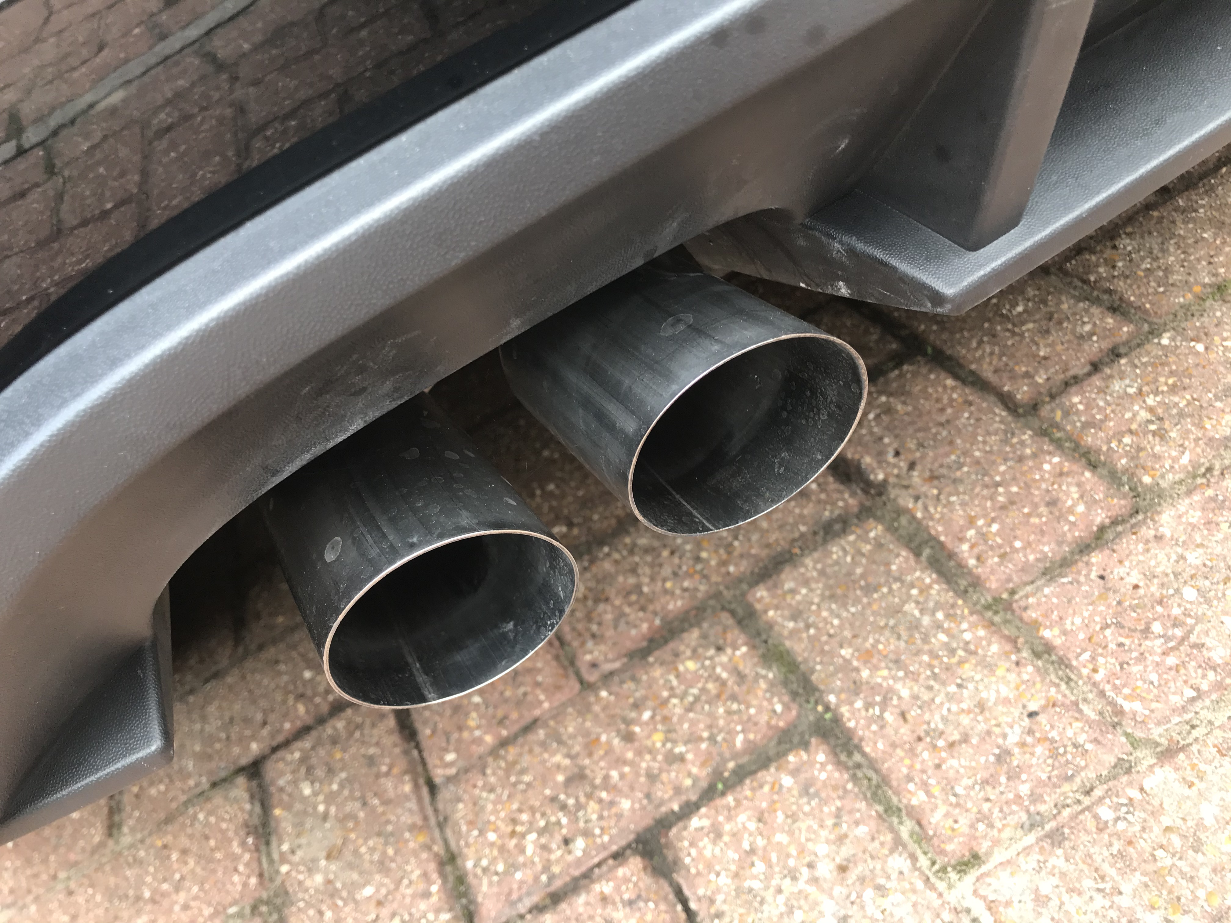

In terms of the exhaust pipes I do not believe it has had an aftermarket silencer fitted so I would suspect the tips have been removed - I have attached a couple of photos which hopefully may help you identify whether they have just been removed or if it is an aftermarket silencer
thanks again for your help its much appreciated!

You are correct, that definitely looks like the factory silencer with the tips removed.comptonk24 wrote: Tue Sep 08, 2020 11:22 amIn terms of the exhaust pipes I do not believe it has had an aftermarket silencer fitted so I would suspect the tips have been removed - I have attached a couple of photos which hopefully may help you identify whether they have just been removed or if it is an aftermarket silencer

@comptonk24; The silencer and tailpipes look the same as mine.
The chrome tips on the tailpipes can corrode and suffer from surface pitting if they’re neglected and not regularly cleaned. If the previous owner of your car didn’t bother to clean the exhaust tips, they may have become unsightly - hence why they’ve been removed.
