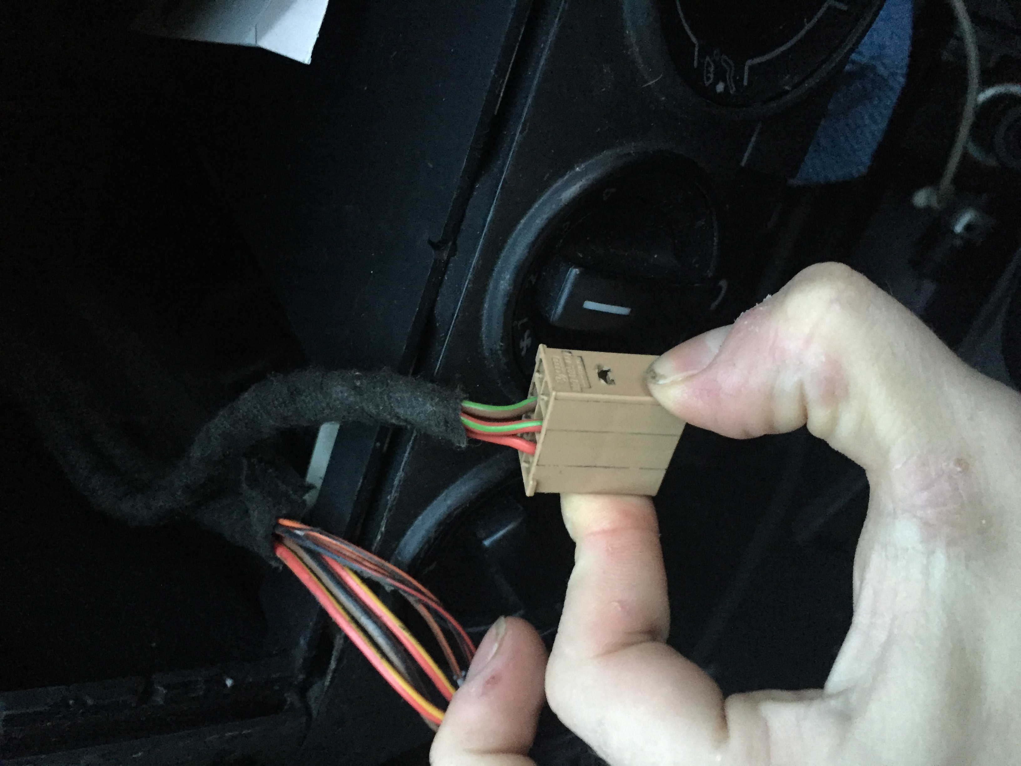

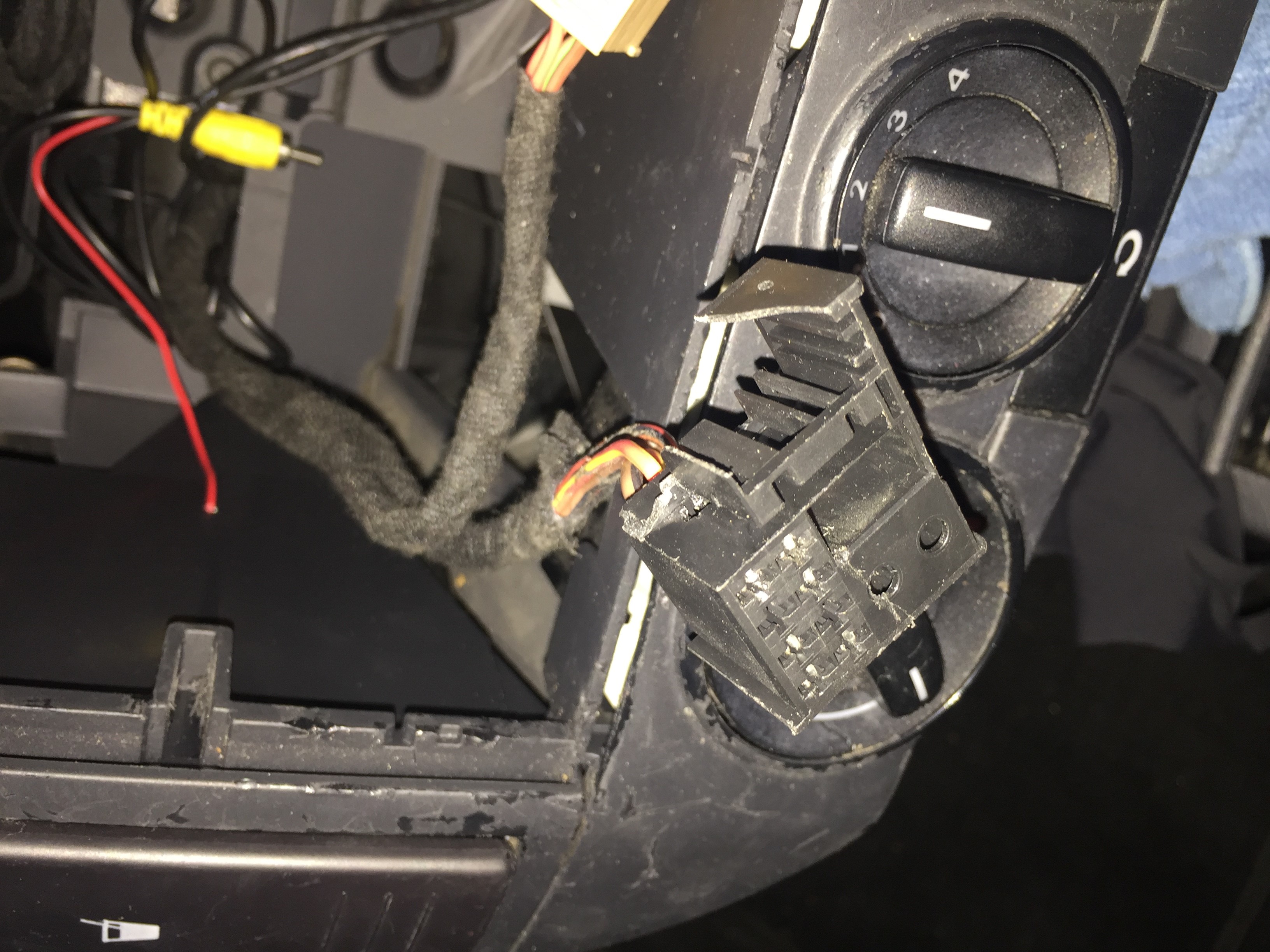

Heya guys newbie here, I don't suppose anyone can help me with my radio I'm trying to install?
I have a 2007 VW Polo and I'm trying to change the radio from the original to a 2 din one, I got the old one out but I'm having issues with the new one it. Keeps doing the following below..
it comes on won't go off though.....
second i cant get the speakers to work....
i am new at this and wish i never started now LOL...
In the Brown box connector i only have 4 wires
pins
#5- empty. #1 - empty
#6 - wire - brown/red #2 - wire - red
#7 - wire- brown/green #3 - wire- red/green
#8 -empty. #4 - empty

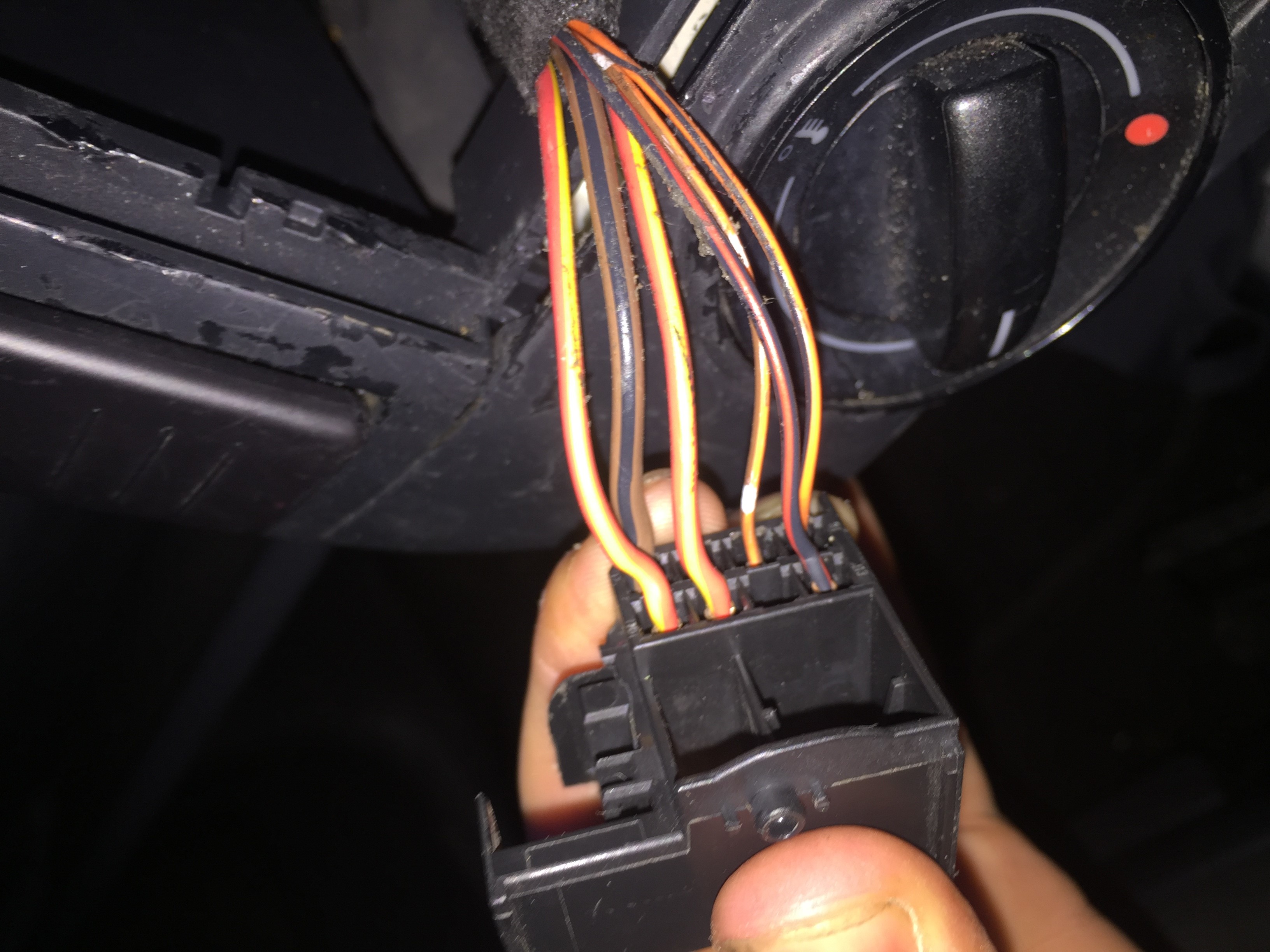

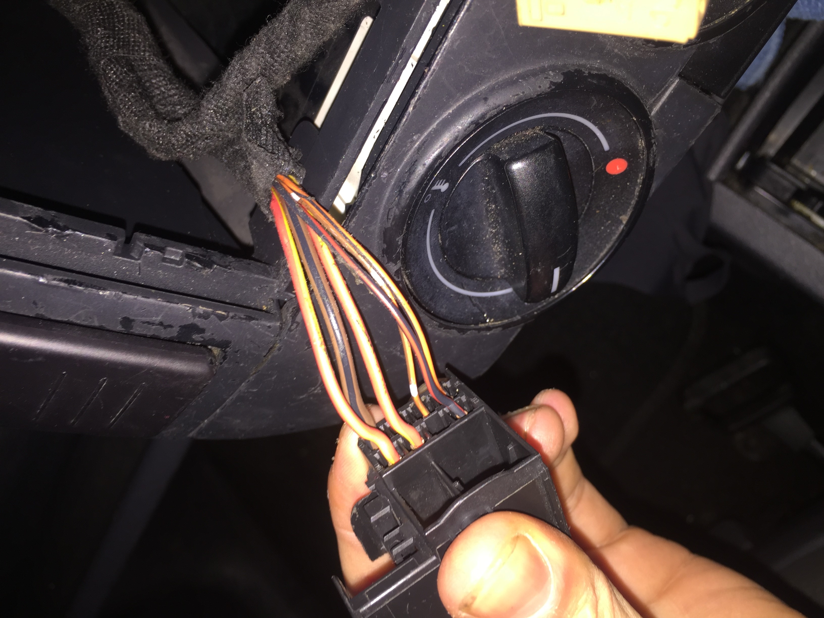

black box connector
pins
#9 - wire - orange/black. #13 - wire - red/black
#10 - wire - orange/black. #14 - empty
#11 - empty. #15 - yellow/red
#12 - wire -brown/black (ground) #16 - yellow/red
If anyone can help by telling me what colour goes in what pin that help me ;p, i'm using a ISO adapters but i also have the universal ones to if helps.
thanks again
Alex

Re: Radio installation Help??
Oh no, you've made a bit of a mess there!!
You need a quad lock to ISO adapter loom - what you've done splitting the plugs won't help you at all
https://www.halfords.com/technology/car ... 81915.html
This will sort your issues out, but you'll need a new quad lock housing first which is probably 3B7035444 from the dealer - you should have it on the black plastic housing you have broken up
You'll also need a wiring tool to release and move the wires between the old and new housing like this https://www.amazon.co.uk/Laser-3932-Ter ... ive&sr=1-8
