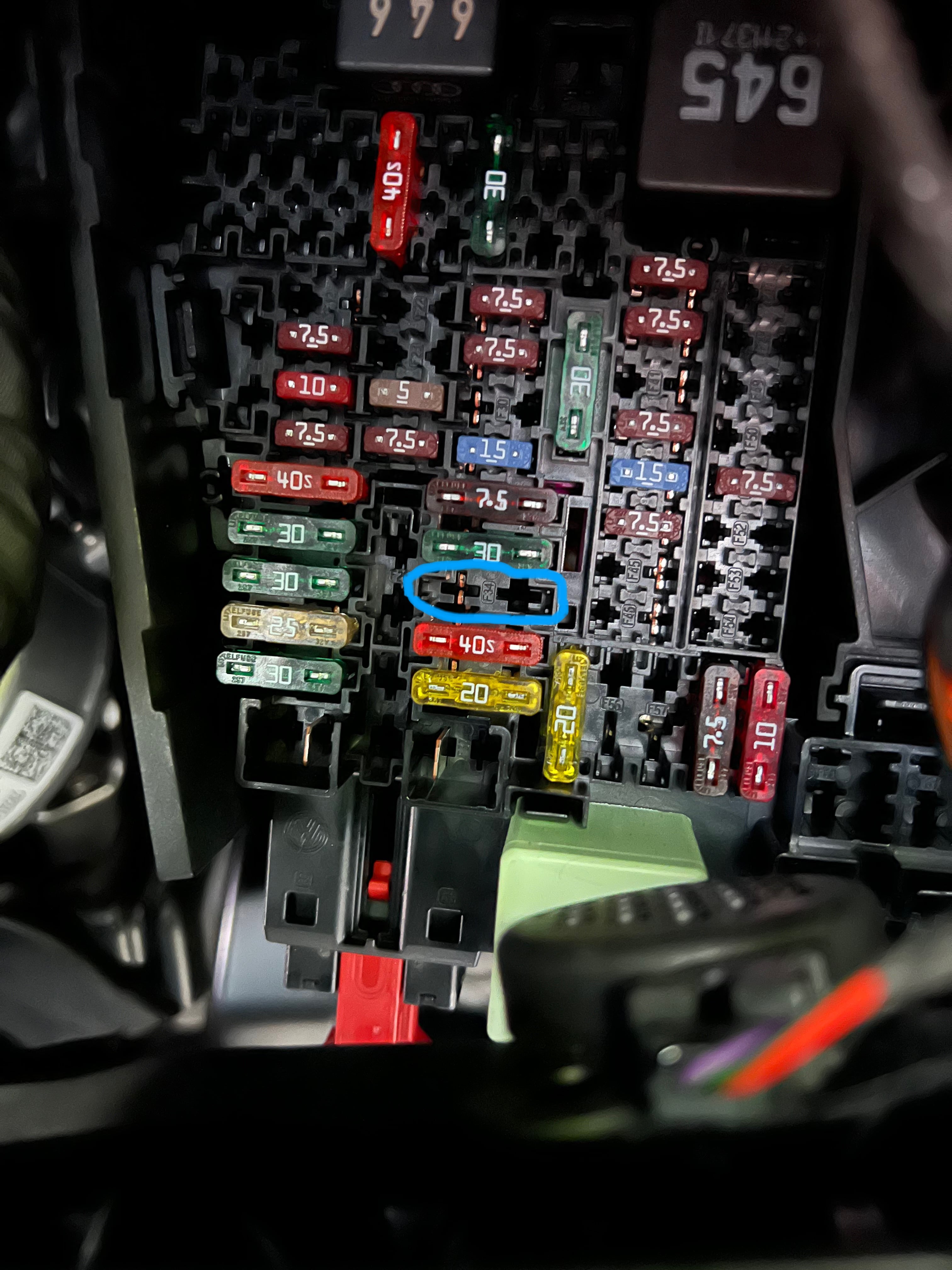

Wanting to hardwire for parking mode so looking at a permanent 12v supply. I see the 40 amp central locking fuse has been suggested to tap but looking into the specs of most of these fuse taps, they all appear to be rated for either 20 or 30 amps. Went hunting for an alternative supply and the highlighted F34 appears to be an unused permanent supply so will give that a go when my cameras arrive.

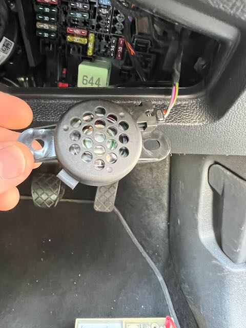

What is this thing that I found just hanging freely in the fuse box compartment? Looks like some kind of speaker.
